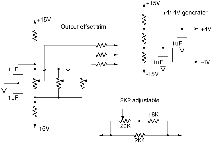

In position b , the main issue was offsets and gains of paralleling amps. I see now you have successfully paralleled . But how a DIY will do it. Is he going to cut the outputs and inputs of each amp , apply ground to adjust offset , apply Vref to adjust gain , re link inputs & outputs , repeat for the other branch, adjust offset to balance the bridge , varnish the 13 adjusts. Or you have found an "astuce" for it?
It looks really good.
LM3886 is more powerfull than both LM1875 and TDA2050. You also use a slightly higher supply voltage.
I notice that the LM3886 is set for an amplification of 22 times (+1) and use an 1/5.7 scaler (divider) before the LM3886 such that you have a resulting gain of 4 from the output of the OP-AMP. We use 3.5 but for less output power/voltage.
Do you know how LM3886 reacts with a gain below 10 times?
Do you know what is the advantage of taking the LM3886 feedback signal after the current detecting resistors (R1/R2)?
I would add a 47K resistor at the very input, before C1, to reduce "plop" from connection/activation of a source while the amplifier is turned on.
I don't understand what i did (in details), so cannot answer, i don't have the background. I only choosed a shematic/thread wich seems interesting. In electronic, I'm only good at soldering and selecting the parts of the shematic. 😛
At start, I didn't like how Tom wrote on the forum, so i tryed to find something else, more diy.
You are right that the adjustment procedure needs re-thinking.
Cutting the outputs to the load balancing resistors is not necessary. The voltages can be trimmed even when they are connected to a common output.
Some DIYers will be able to do adjustment with fixed resistors, some not. For those who prefer trim-pots, I suggest the following circuit modifications (please see the appended sketch).
I see no problem in the input being shorted to ground and each of the three outputs being trimmed to a minimum output voltage. For that I suggest the part of my schematic named "Output offset trim".
Matching of gain will be necessary but requires a 4V test source. Here I suggest the part of my schematic named "+4V/-4V generator".
If two of the three 2K2 input resistors are replaced with the schematic part named "2K2 adjustable", two of the three LM1875 circuits can be gain-adjusted to match the gain of the third.
Are these reasonable solutions for the DIYers that will not be successful with fixed resistor adjustment?

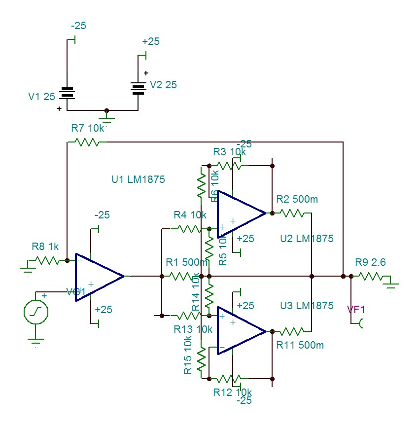

Here is a simpler parallel master+2slaves. The first U1 is autonomous voltage amp to have it's output feed backed , the two others measure the current passing through R1 and pour to the load as much , tripling the output current of the master autonomously .

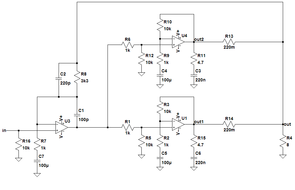

Hi everyone,
great results and progress you guys are posting here! I'm a little occupied with my notch project at the moment, but I'm still following along here 🙂.
All those problems we're having with LM's not performing to specs, being counterfeits or simply mislabelled TDA's made me think about going back to the first schematic that was posted in this thread by kokoriantz. This circuit is probably not the best performing, but it should be the most forgiving one, while still being better than a plain vanilla 1875. Here's a schematic of a prototype I'm planning to build:
attachment.php
Some of the advantages:
The LM (or TDA or whatever really) is running with 20+ dB inside its specified range (R2/R3, R9/R10). This should work with any part out there, even the cheapest ones without any working protection circuits that are not stable with negative gains.
Output offset is negligible when using capacitors C4 and C5 to AC-couple the feedback path. This makes trimming the whole thing a lot easier. For a more High-End approach, one could easily add a servo circuit at the non-inverting inputs of each LM. This makes the circuit more complicated though. When the servo is not used, R1/R5 and R6/R12 might be omitted.
Only the gains of the LM blocks have to be trimmed via R3 or R10, much like in the Linn circuit that was posted above.
C1 and C2 are needed to make the whole thing stable. The values above work with a simple simulation model. I will see if they hold up in the real world. It would be great to find a one-size-fits-all version that works with genuine and counterfeit parts alike.
R7/R8 set the overall gain of the amplifier. Values below 20dB are easily possible. For extremely low gains like 1x, 2x, 3x etc. the capacitors C1 and C2 may need some further adjustment for stability.
C7 removes the input offset of U3. Again, a servo might be added to remove the even the last mV from the output. I consider this to be overkill though.
Now on to the veroboard and soldering iron 😎!

Many thanks for the circuit suggestion.
I notice that for the two current follower amps U2 and U3, the noise gain seems to be 1. Palstanturhin had oscillation phenomena with gains below 3. May such oscillation appear for these current followers as well?
Am I right in that this circuit is quite demanding on the common mode input range for the current followers U2 and U3 as the inputs will swing the amplitude of the U1 output?
The current amps don't have any voltage gain and they are very stable. They even don't have any ground reference to know at what potential they are flying. Yes the inputs reach the Vee/Vss limits , this why I adjusted the current sense resistors to 0.5 instead of 0.1 so that the master clips before the inputs reach to their limits . With 8 ohms load per IC the output can clip at 22.4v while the current slaves still pouring the same current as the master.

Hi Lasse,
A nice circuit for test!
It is close to the circuit Chris tested but with a controlling OP-AMP loop.
Using the LM1875 with a gain of 10 should make almost any LM1875/TDA2050 work, even the fake ones. With increased LM1875 gain, you will get a little more noise but that is not serious as I see it.
With 10 times LM1875 gain, you push the OP-AMP amplitude working point towards higher THD but also that is not a serious problem. You can eventually adjust your R1/R5/R6/R12 for a lower effective gain.
Your conclusion on the off-set reducing effect of C4 and C5 seems right but at the same time they may cause some problems if any. My fear would be that these capacitors, if triggered by a low frequency signal, could cause a momentary output voltage difference at the two amplifier outputs because the return to balance is slow due to the size of these capacitors. That could be what happened for Chris. Due to the higher gain (10x), matching of gains is more important and due to the capacitors you have to match the gain with an AC signal which is more cumbersome and perhaps less precise. You only need to adjust one gain to match the other as the exact gain is of no importance. I am curious to see if these capacitors give you problems.
For the rest, I have no comments. A good year ago I made some composite amplifier tests with single LM1875. For these tests, adding C2 would only make the whole thing oscillate.
I fully agree with your "one-size-fits-all" approach and at least for now keep it simple and avoid DC-servo's if not really mandatory. There I fully support Turbowatch2's view that bothering about a few Milli-volts is exaggerated.
I very much look forward to hear about your experiences.
NB: You mention a "Linn circuit". Which one is that?
