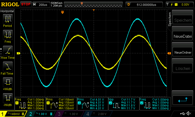

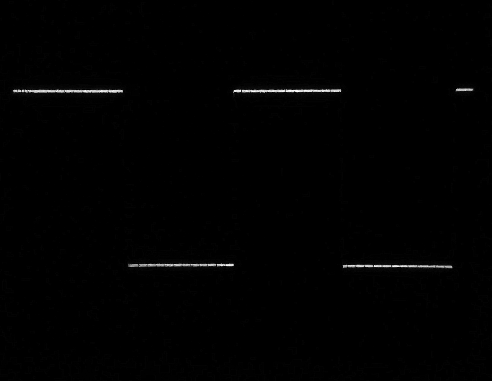

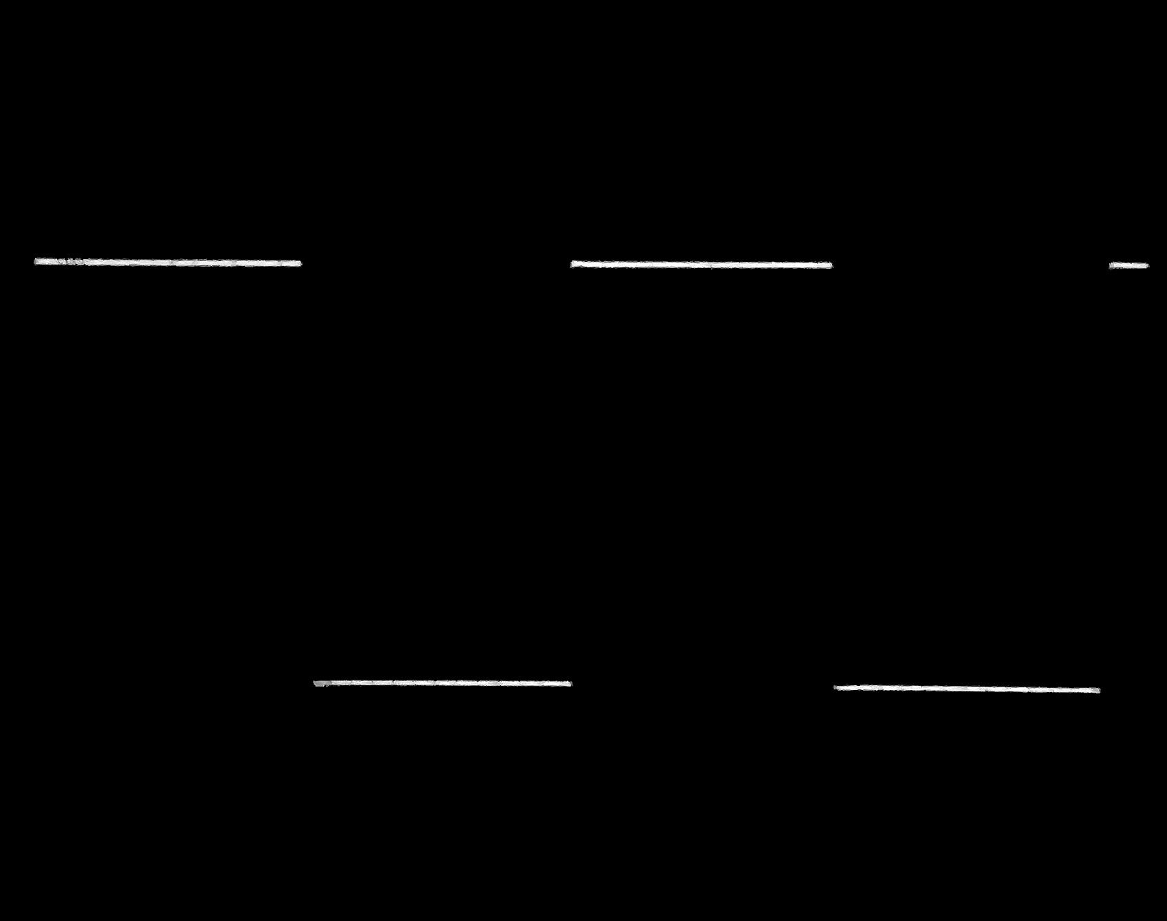

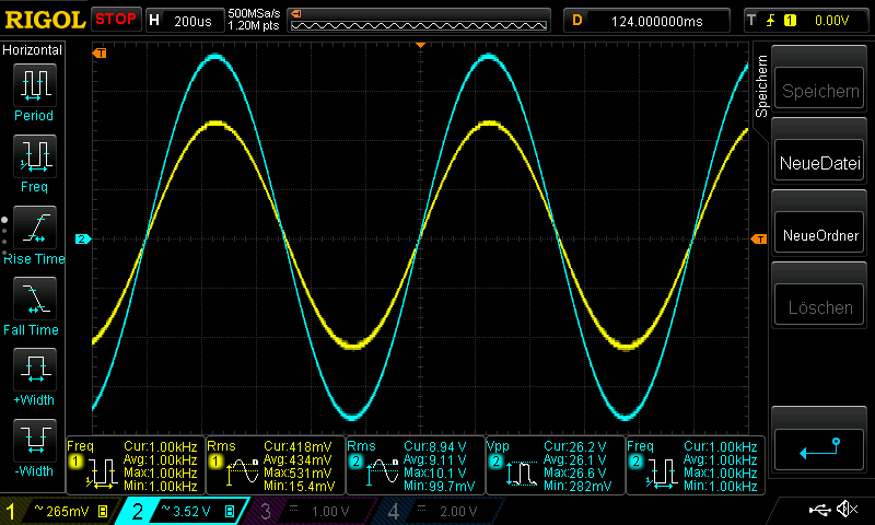

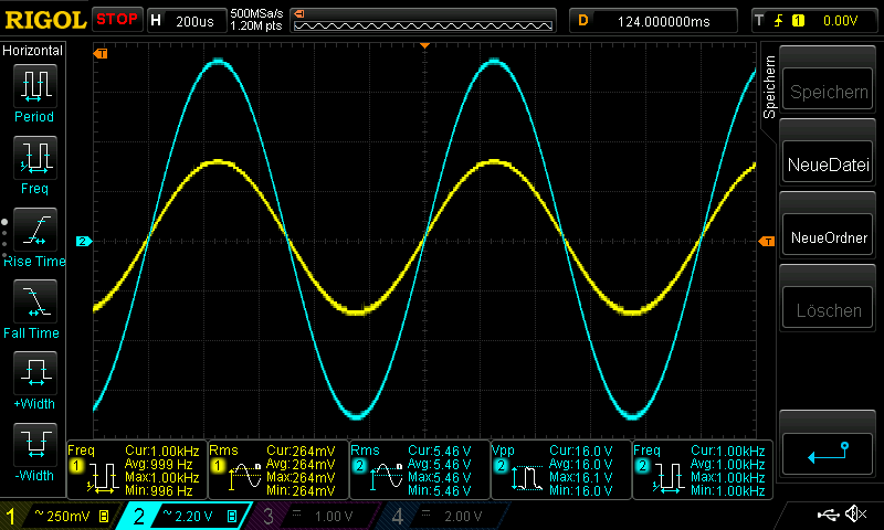

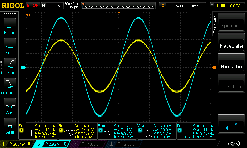

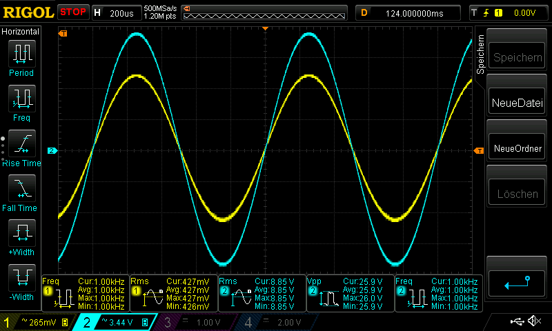

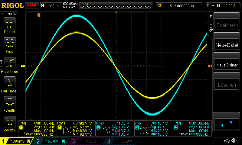

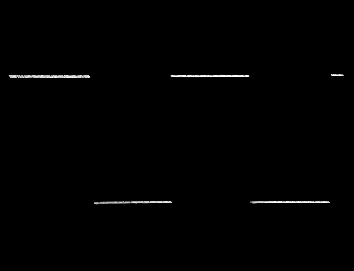

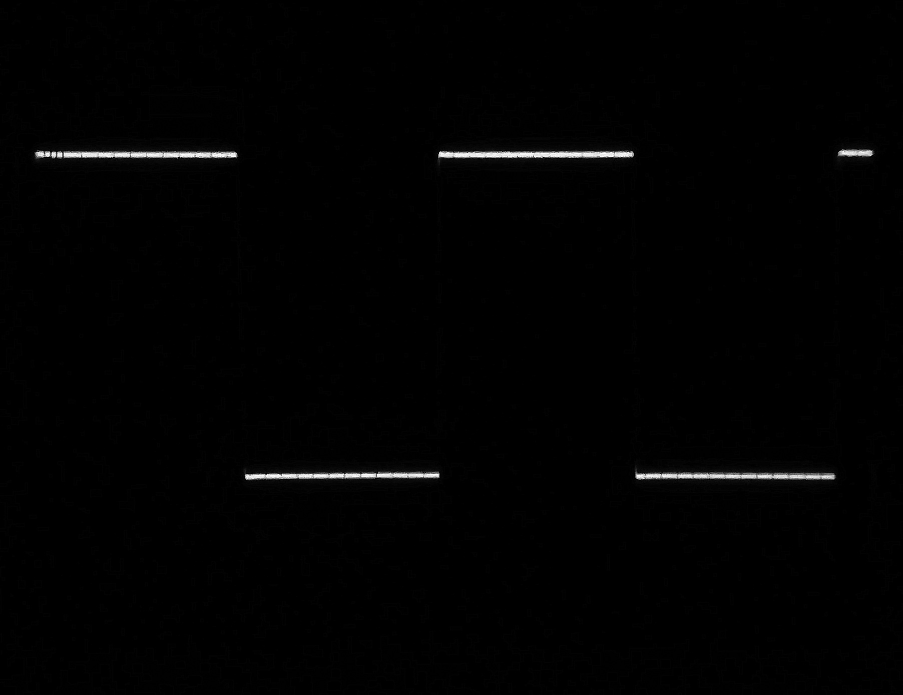

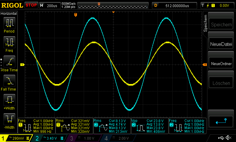

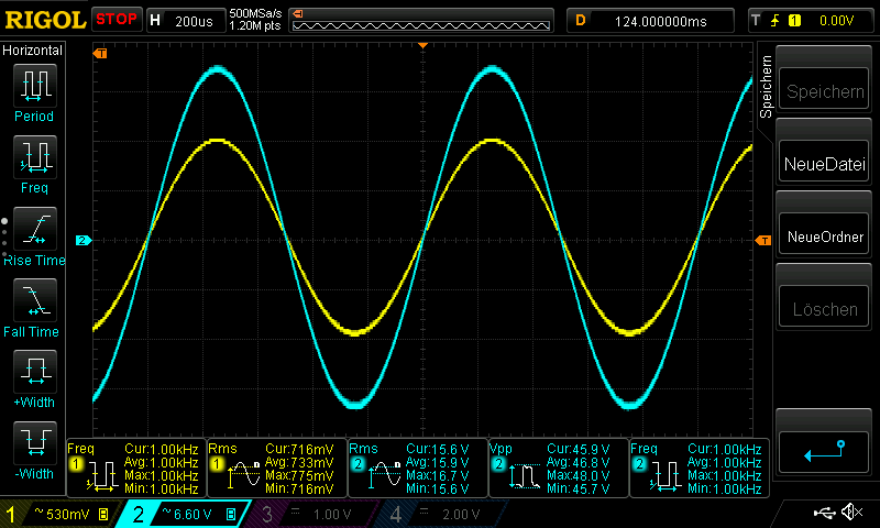

As suggested by Chris in posting #399, 2.7 Ohm in parallel with 100nF or 1uF.
Still my unregulated power supply with +/-24V.
Picture 1: 1KHz, 20Vpp, 2.7 Ohm in parallel with 100nF
Picture 2: 1KHz, clipping, 2.7 Ohm in parallel with 100nF
Picture 3: 1KHz, 20Vpp, 2.7 Ohm in parallel with 1uF
Picture 4: 1KHz, clipping, 2.7 Ohm in parallel with 1uF
In conclusion, the triple LM1875 is pretty unimpressed by capacitive loading.

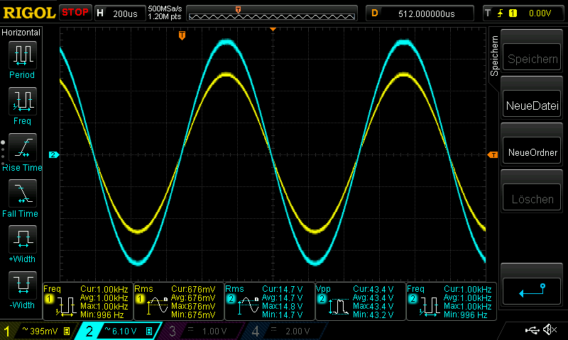

I was asked about the -3dB bandwidth. I tested with two signal amplitudes (2.7 Ohm load / +/- 24V supply):
20Vpp gave 100KHz (slew-rate determined / triangular)
2Vpp gave 180Khz (slew-rate determined / triangular)
I also tested the slew-rate with 2.7 Ohm load and 20Vpp square-wave. I arrived at 3.3V/us. A "raw" LM1875 is specified to 8V/us but I have reduced the speed with the 100pF in the feedback.

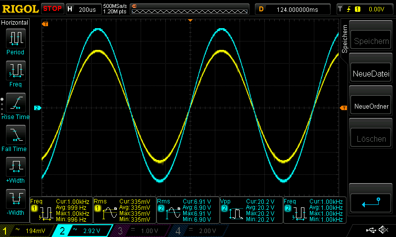

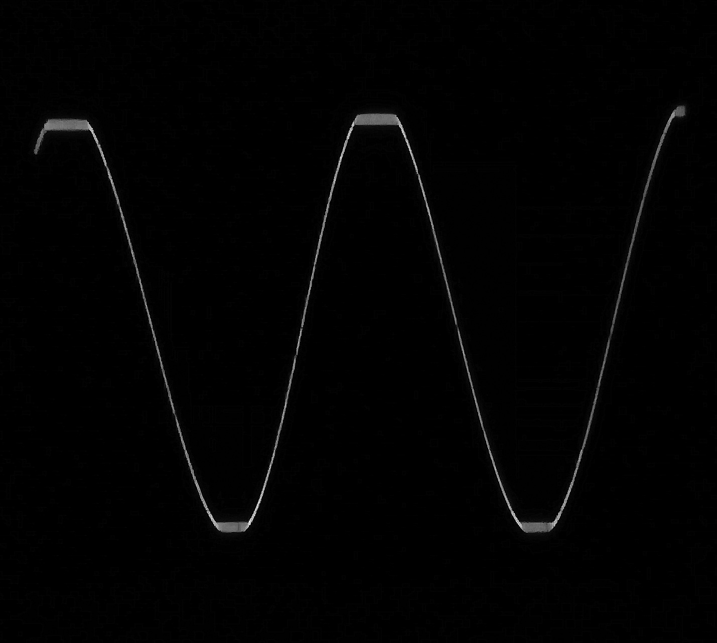

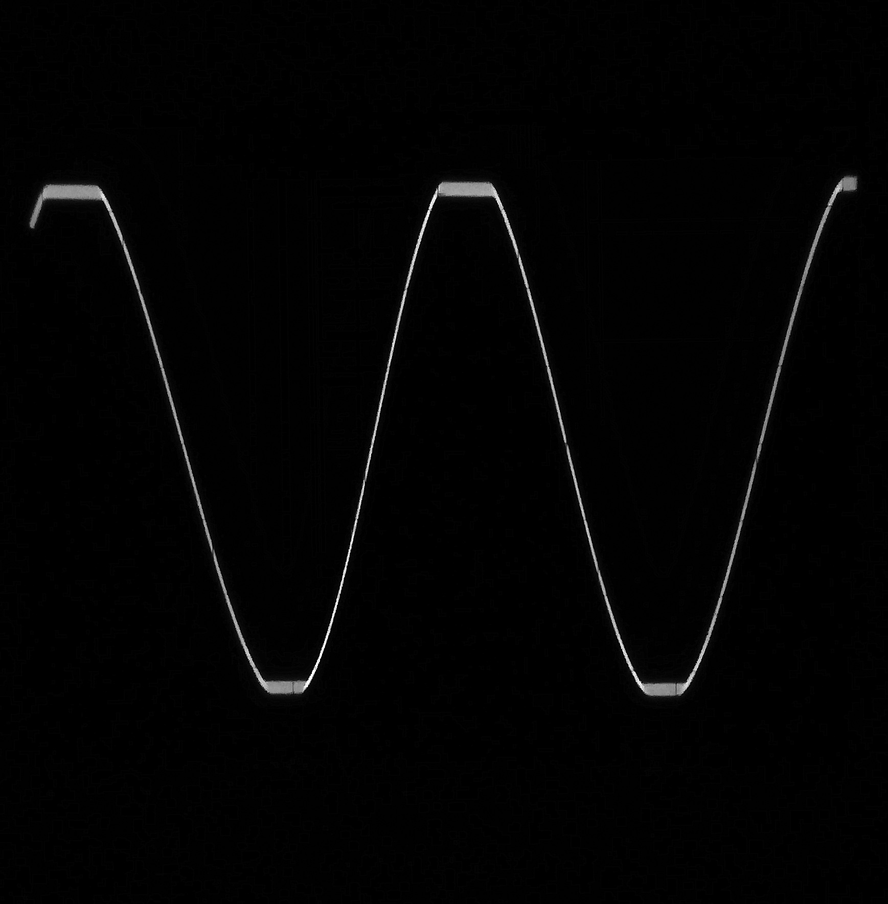

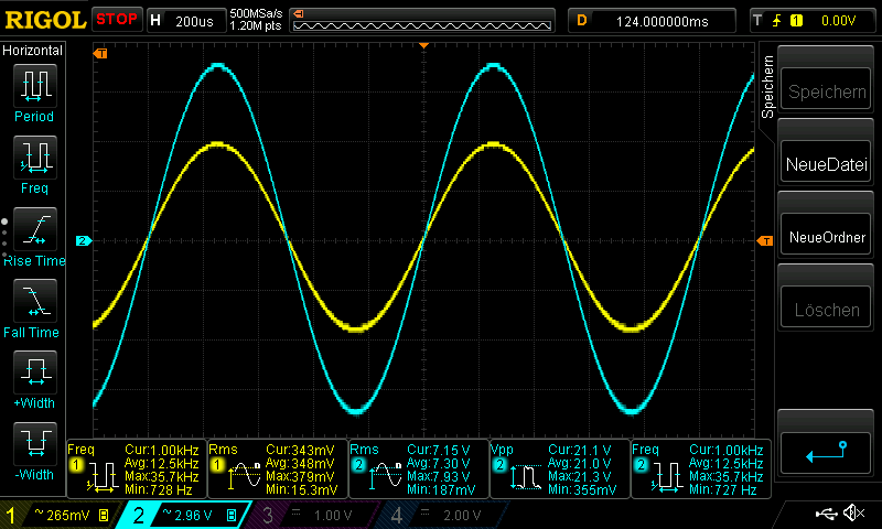

As requested, only 100nF or 1uF but no resistive loading. Actually, it does not change much.
Picture 1: 1KHz, 20Vpp, 100nF (no resistive load)
Picture 2: 1KHz, 20Vpp, 1uF (no resistive load)
NB: foil capacitors.
