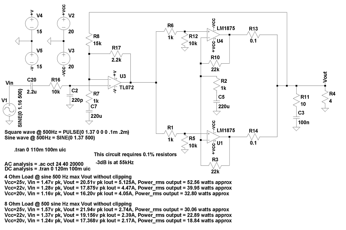

Refer to post #465 by Preamp for his circuit that this modifies.
Changes have only been tested in LTSpice simulation.
Changed a few resistor & capacitor values.
Changed feedback ground resistor/capacitor to a single ground resistor/capacitor. Attempting to get electrolytic capacitors of exactly equal value would be near impossible. If they vary in value then the gain will change depending on the frequency. Imbalancing this circuit can mean dead opamps. All resistors R1, R6, R5, R12, R10, R3, R13, R14 should be 0.1% tolerance as both LM1875 circuits have to be matched for gain and equal output current and power dissipation. See application note AN-1192 Overture Series application note for more info, which are more like caveats.
Changed zobel network to single at output.
Output appears clean on a square wave as long as voltage is below clipping level. All other results are in the attached picture. All AC voltages and AC currents shown in notes in picture are peak not rms.
Easy way to calculate power from waveforms in LTSpice:
Power_rms = Vout_pk x Iout_pk / 2
Can someone check for errors. Also changes welcome.

I find the single C5 a very interesting idea that can eliminate different dynamic behavior from the two LM1875. If a single Zobel network after the load-balancing resistors is as good as two separate directly on each output, needs to be evaluated in test as I guess the simulation model may not be very precise on such behavior.
In my eyes, R17 leaves a frequency independent pretty low loop-gain that does not leave much distortion-correction in that loop.
Originally Posted by RufusGartz (Annex post 484) o.a
"Vcc=22v, Vin = 1.37v pk, Vout=19.156v pk Iout=2.39A, Power_rms output = 22.89 watts approx"
Is that the simulated outcome of 2x LM1875 (paralleled) at +/-22V powersupply?
I had expected a (much) higher output, with my present non-composite setup (single LM1875 at about 22V) it allready outputs about 25W.
i guess its into 4R

Hi Fred,
With two LM1875 in parallel, the total of the two can handle double the current. But, if you do not use that current to drive a load with half the impedance and still use 8 Ohm, the output power remains the same. Rufus calculates 23W, you measure 25W in 8 Ohm - that is close. It is only when you use 4 Ohm or use a BTL coupling with an 8 Ohm load that you have a real increase in output power. Rufus calculates 40W in 4 Ohm.
Thanks FauxFrench for the explanation, it is all clear (and nicely confirmed by the 4 ohm
outputs also given by RufusGartz in the same Annex)

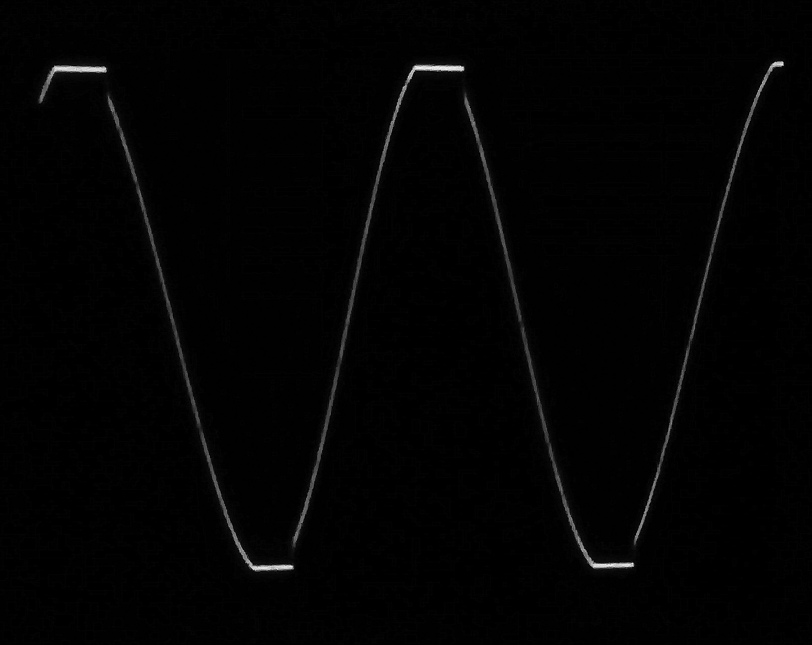

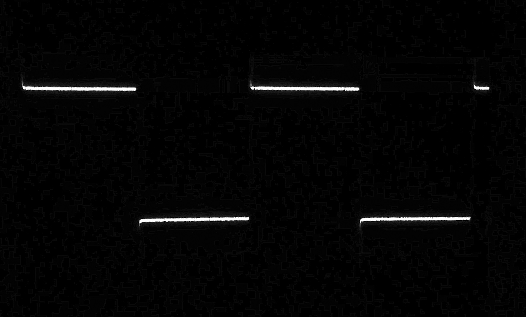

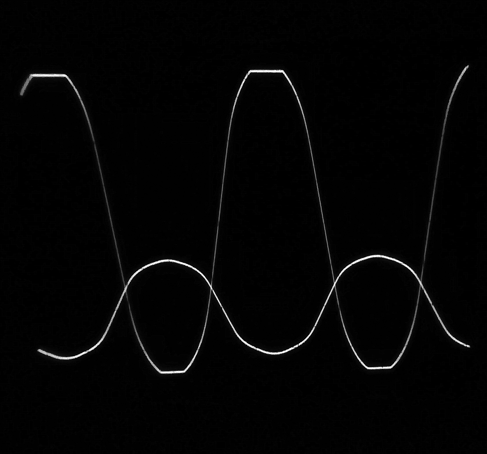

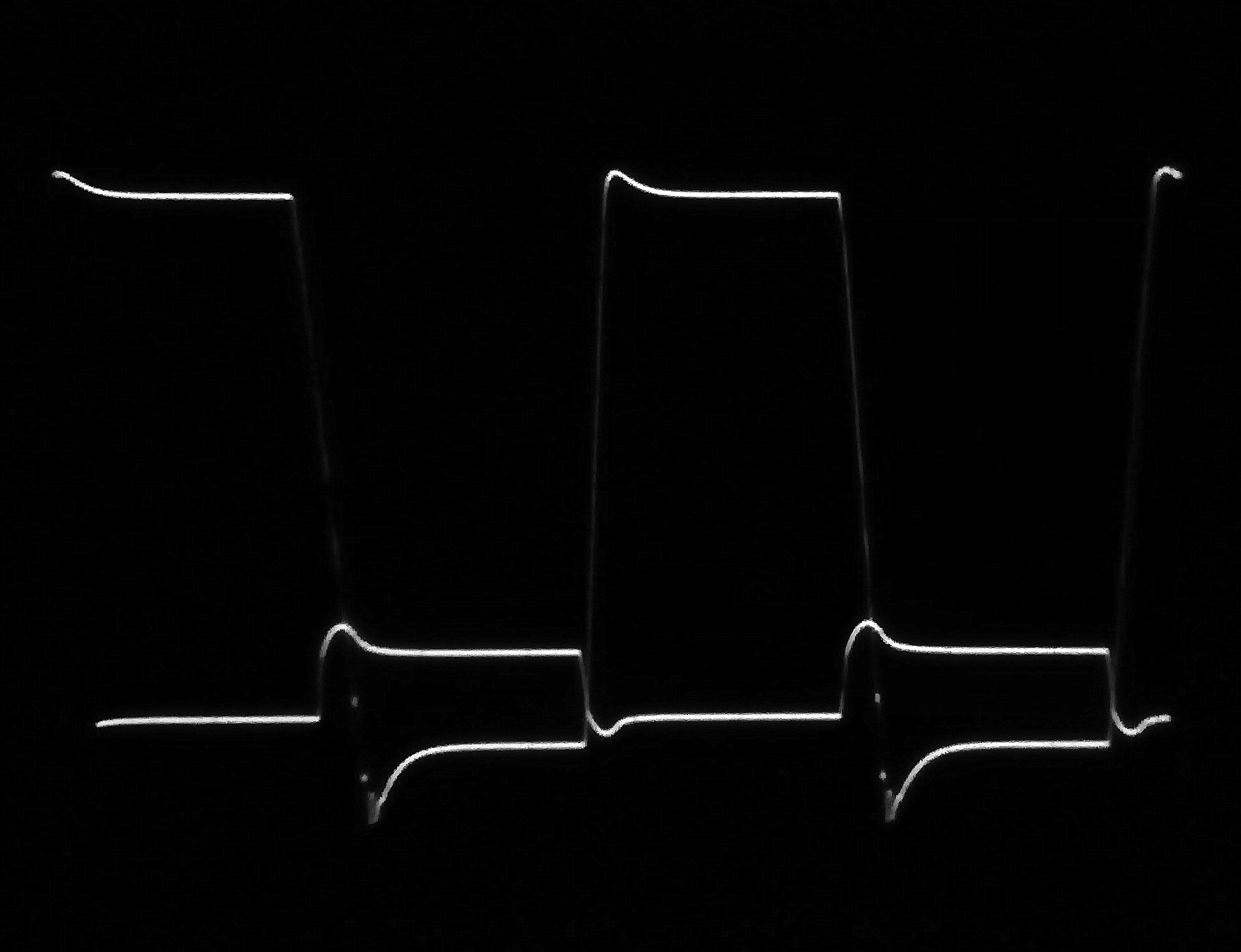

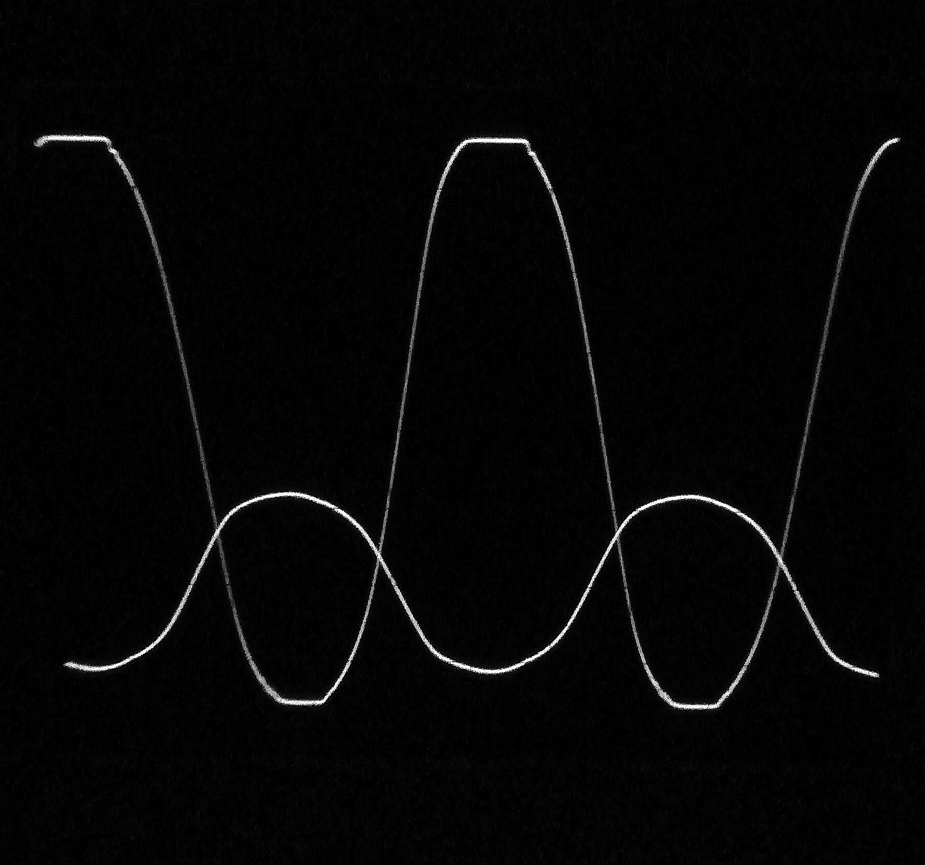

I got my regulated symmetrical power supply on it tonight. Very low dynamic output impedance. A quick test with +/-24V supply and 4 Ohm indicates much less "woolly" saturation tops than with my unregulated supply. I will try to take photos tomorrow.
With my low-impedance regulated power supply adjusted to +/-22Vdc and with 1KHz at the input, I got the following results:

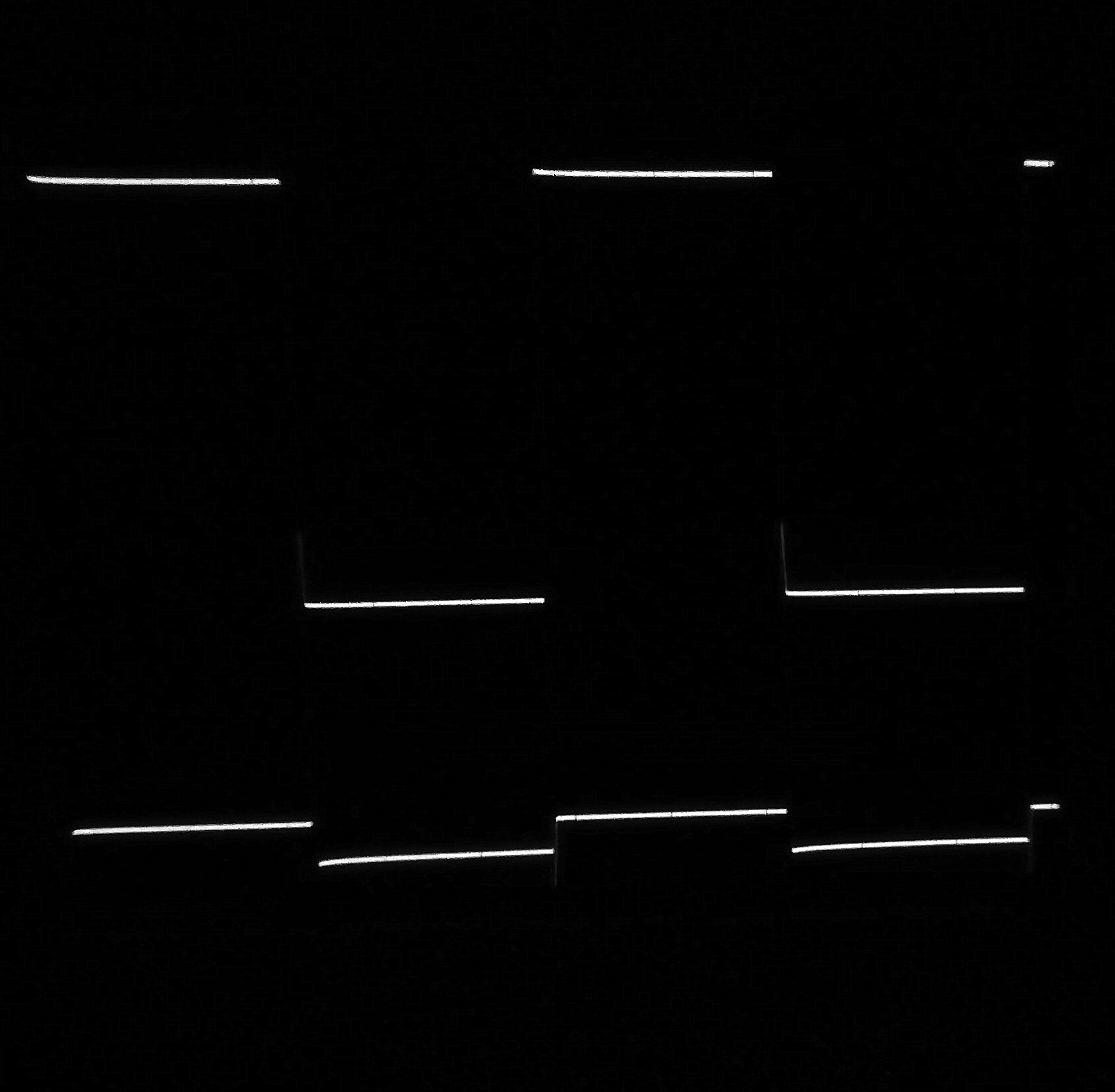

Pict.1: Clipping at 36Vpp in 2.7 Ohm. Vertical part due to recovery of OP-AMP output.
Pict.2: Square-wave at 15Vpp in 2.7 Ohm. Spikes at start difficult to see.
With my regulated power supply, the clipped flat tops are much less "woolly" than with the unregulated power supply.
I will try to remove the SQW start spikes by clamping the OP-AMP output.

With the regulated supply the voltage is kept constant even with the amp driven into clipping. The unregulated supply interacts with the clipping amp, as it´s voltage breaks in at load. That is the difference and what you expect from a "stabilized" supply.
Nice to see it so clearly.
Don´t come to the conclusion regulated will sound better, you will never listen to an amp clipping that much, but rather buy or build a stronger amp if you must hear that loud.

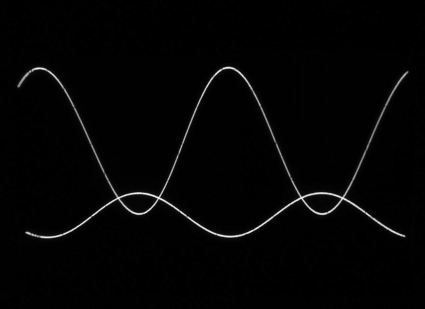

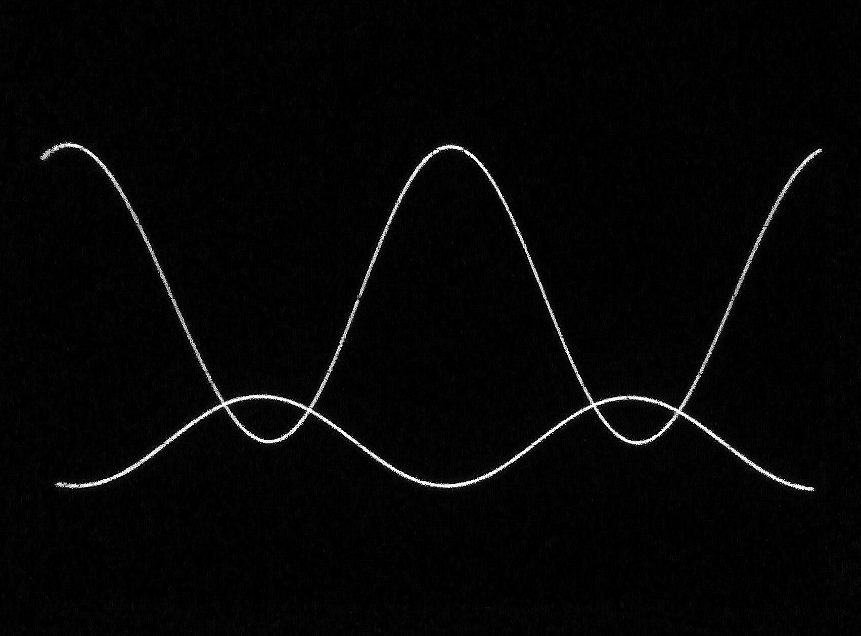

An inherent problem with composite amplifiers seem to be the difference in reaction-speed of the OP-AMP and the power AMP(s). Normally the OP-AMP reacts faster than the power AMP(s) and remains in the linear working area when the power AMP(s) saturate. That leaves unpleasant dynamic spikes when tested with a square-wave at the input. The OP-AMP output tends to make large voltage excursions if not clamped to remain in the linear area and to avoid unnecessary large excursions. I implemented a very simple amplitude clamp – two 4V7 zener diodes back-to-back, from the output pin and back to the inverting input. That can only be expected to leave increased distortion at high amplitudes but it improves dynamic behavior.
A better amplitude clamp can be implemented but with my compact Vero-board design, only simple solutions fit in.

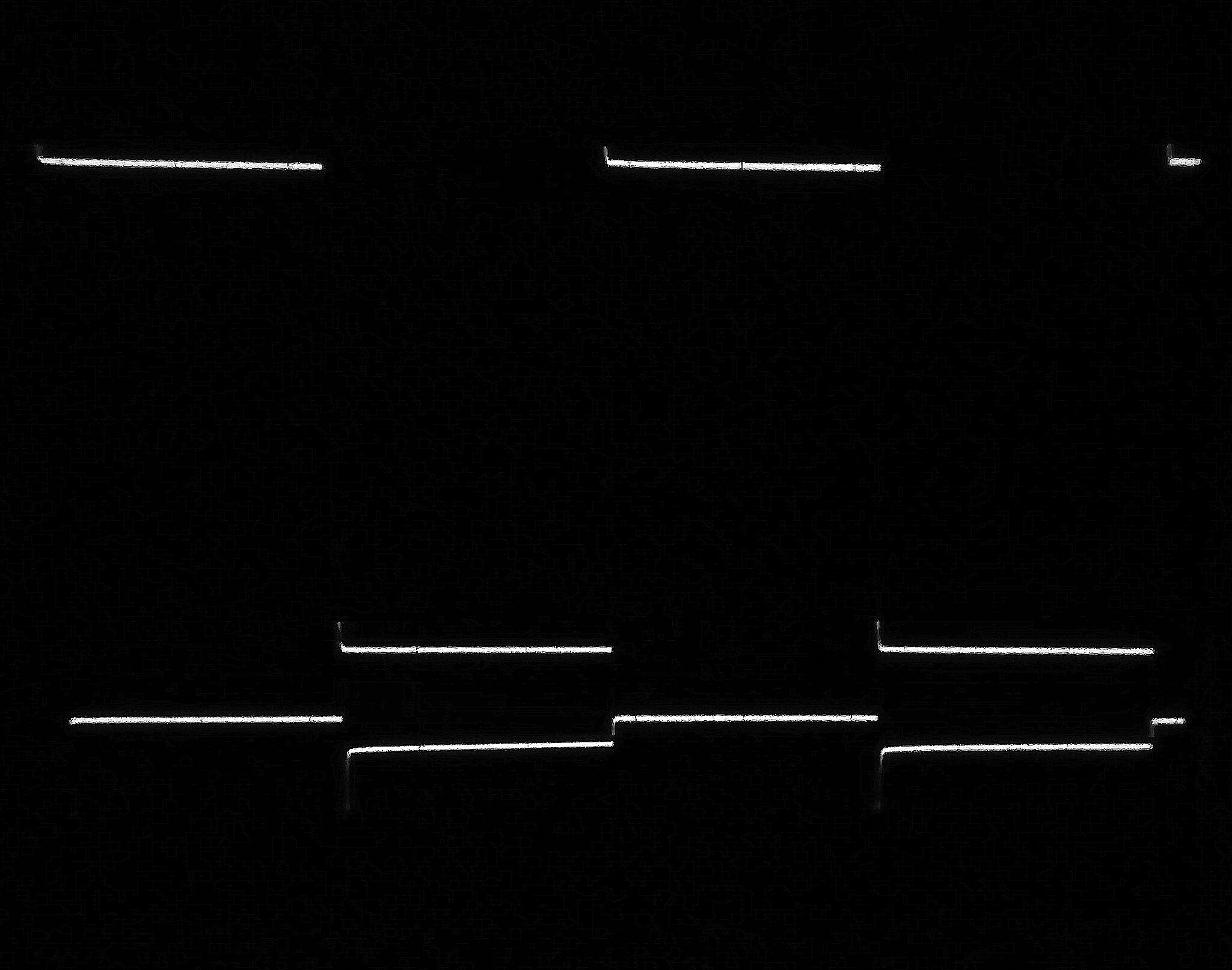

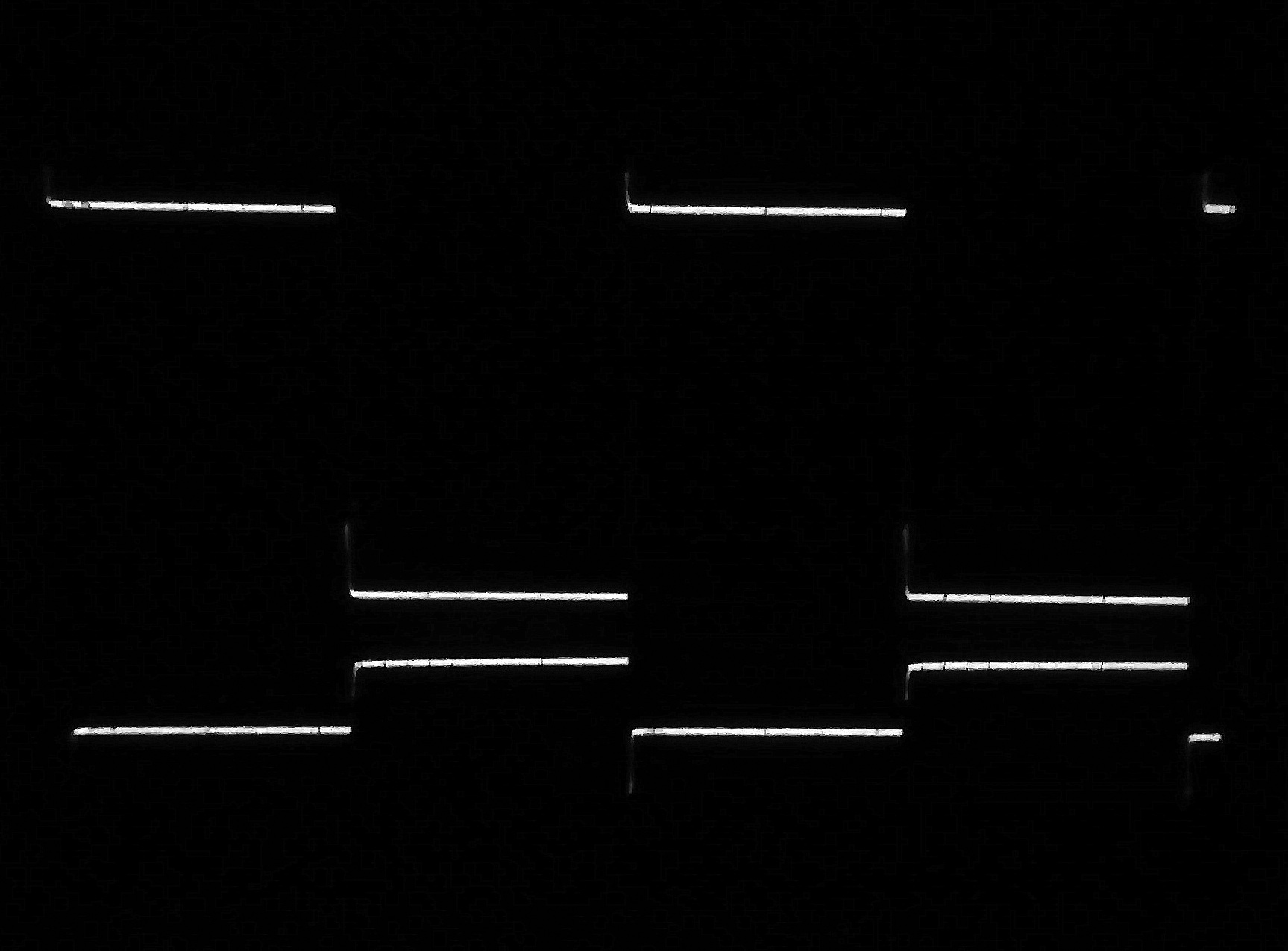

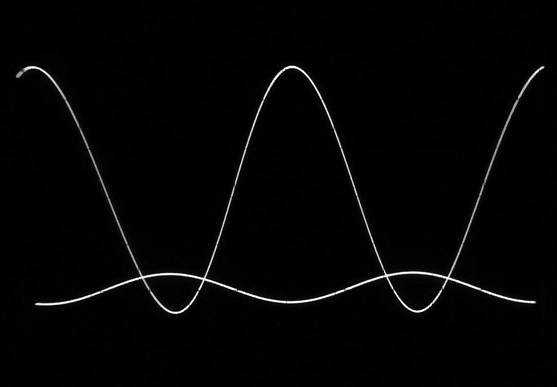

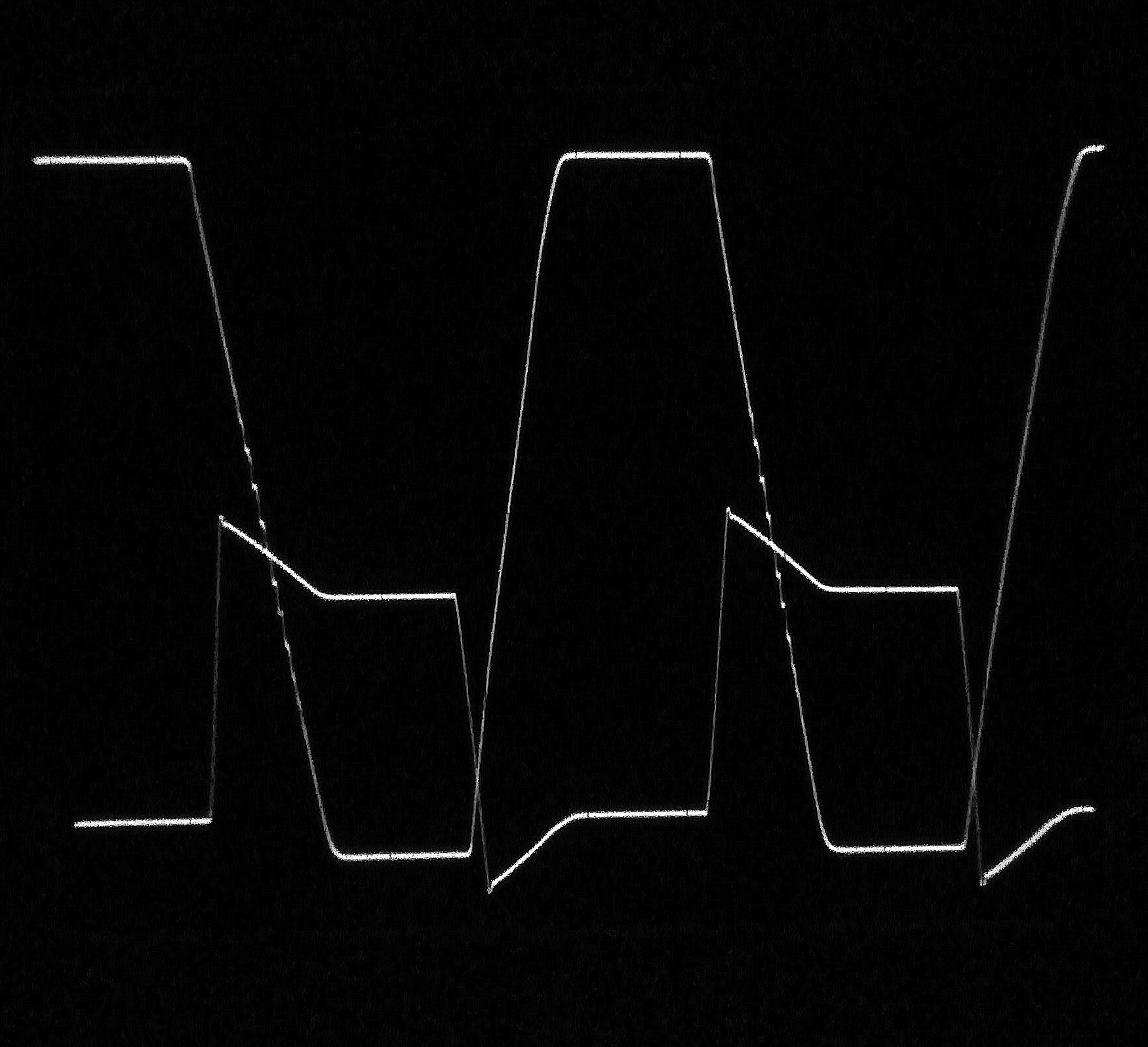

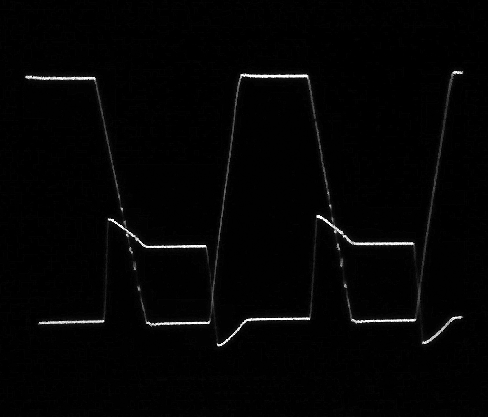

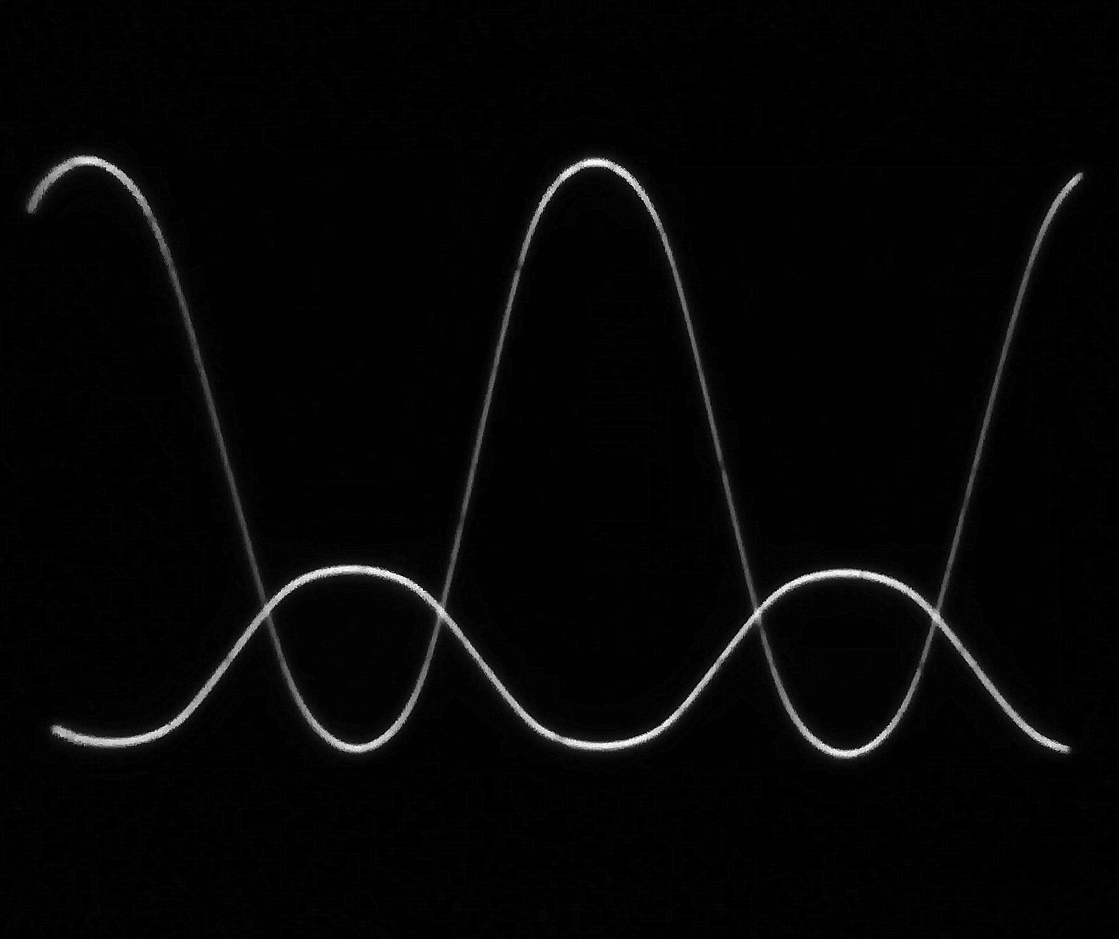

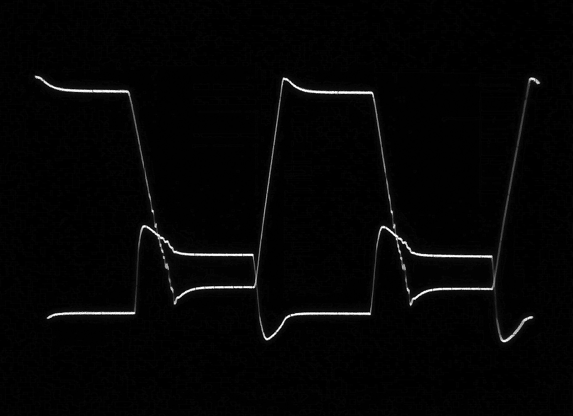

I tested with my regulated power supply at +/-22V and with 20KHz input. 2.7 Ohm load. The dynamic behavior is improved wile the increase in distortion cab be seen at amplitudes near saturation of the power AMPs.
The upper curve is the power output, the lower curve the output of the OP-AMP.
Picture 1: 10Vpp
Picture 1: 10Vpp
Picture 1: 20Vpp
Picture 1: 20Vpp
Picture 1: 30Vpp
Picture 1: 30Vpp
Picture 1: Clipping at 35Vpp
Remember that these test results are at 20KHz, thus at the very top of the audio band. I will try to repeat the measurements at 1KHz.
I fully agree with you that better looking curves do not necessarily mean better sound. But to palstanturhin: this is the way to battle the fine oscillation at the saturated tops. To others - this demonstrates the difference and advantage of using a regulated power supply. Better looking curves but more importantly a voltage that remains constant disregarding loading. At low loading the amplifier is not stressed from a high supply voltage and at high loading, the voltage remains constant such that you get the output power you expect. Remember that my +/-24V unregulated power supply dropped to +/-18V with hard loading!

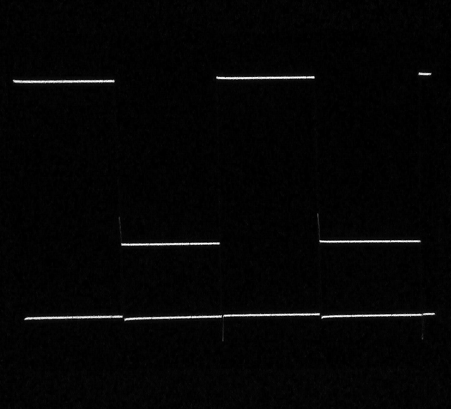

And now the results with amplitude-clamp and 1 KHz. Else, same conditions as above.
Picture 1: 10Vpp
Picture 2: 10Vpp
Picture 3: 20Vpp
Picture 4: 20Vpp
Picture 5: 30Vpp
Picture 6: 30Vpp
Picture 7: Clipping at 35Vpp
Picture 8: Clipping at 35Vpp
The very steep change of levels (slope) for square-wave is unrealistic with music.
