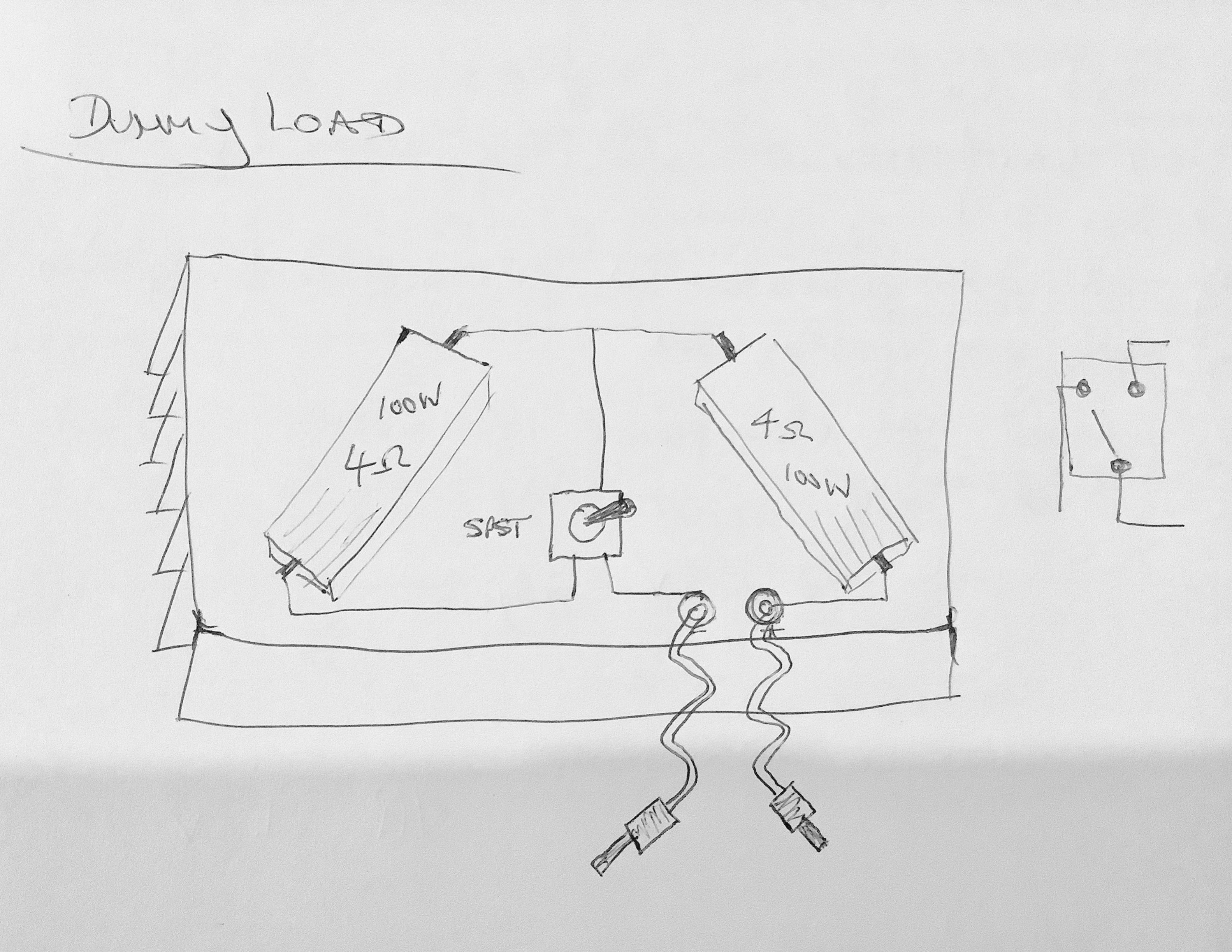

power resistor
please avoid this clip to connect these 2 resistor - solder this - its safer and better contact !

Is this 4/8 ohm dummy load suitable for these chip amps?
hi
i personally would avoid a switch because you will be foreced to switch during power!
i use something like that...usd in cars setup... its soo cheap
search for 8 ohm resostors and build a board with 8R and 4R (8R parallel 8R)
for 2 channels ...big heatsink and fan is required...
