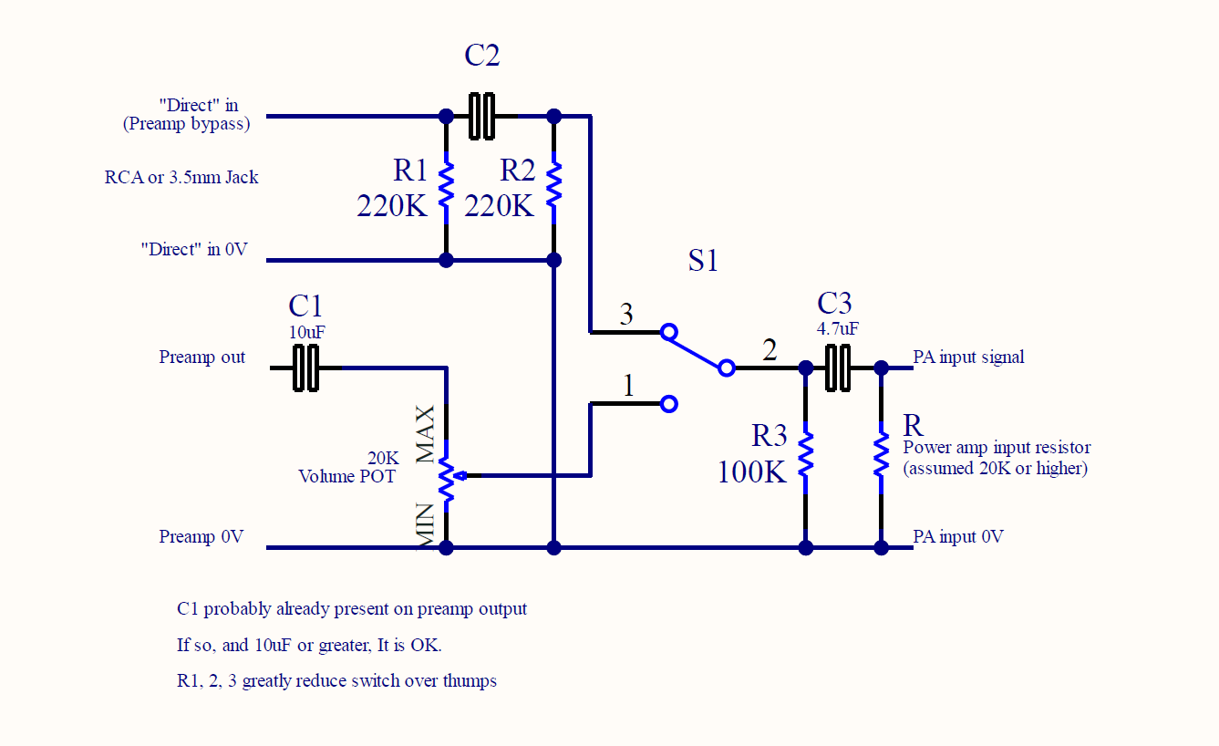

Suggested wiring

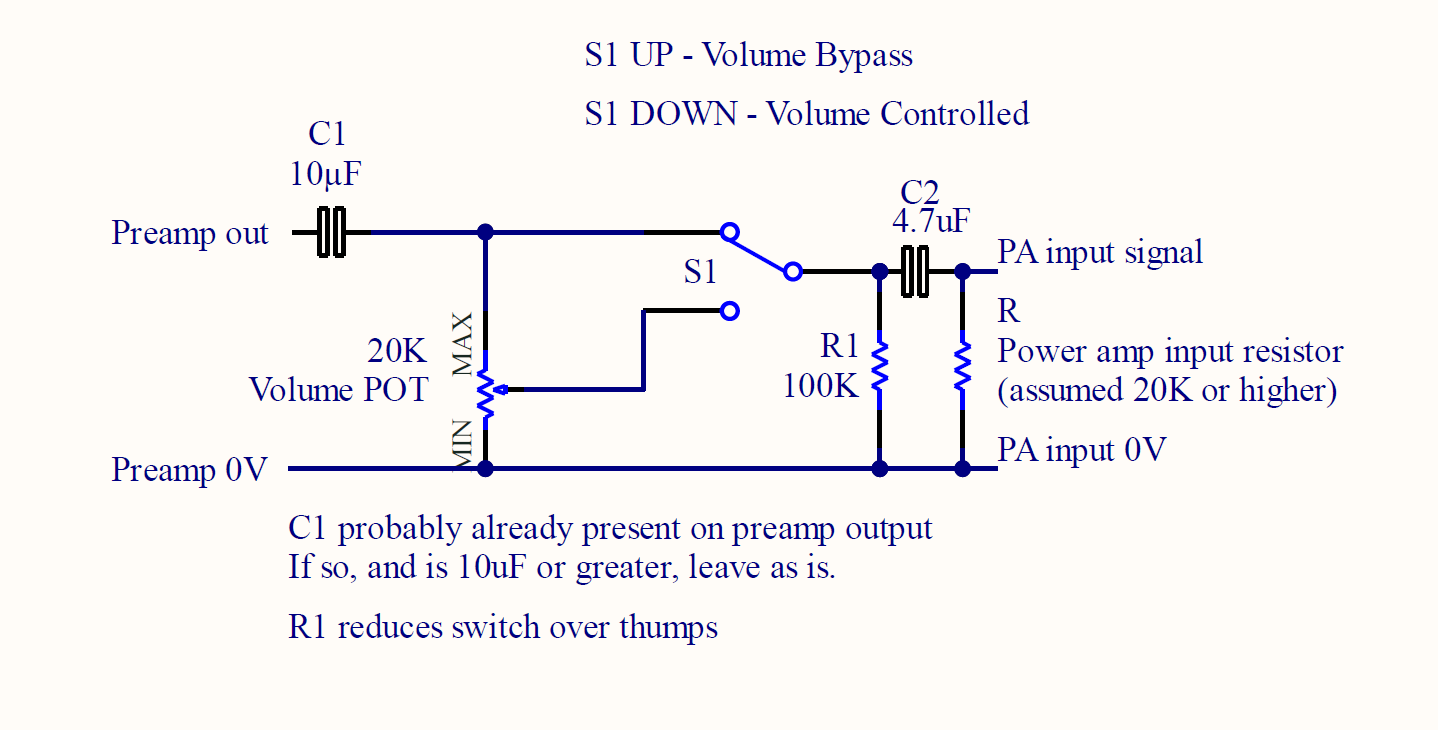

OK. Maybe just a pot bypass switch then, no need for additional input RCAs.
Are there preferred switches for this application?
Any good quality switch will do, nothing spectacular. You'll have to think how it'll fit in your front/back panel wherever you decide it goes.
