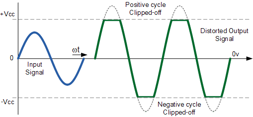

That happened when a signal in a amp is clipping...
under heavy load the supply goes down --> signals are cut on their top ends.

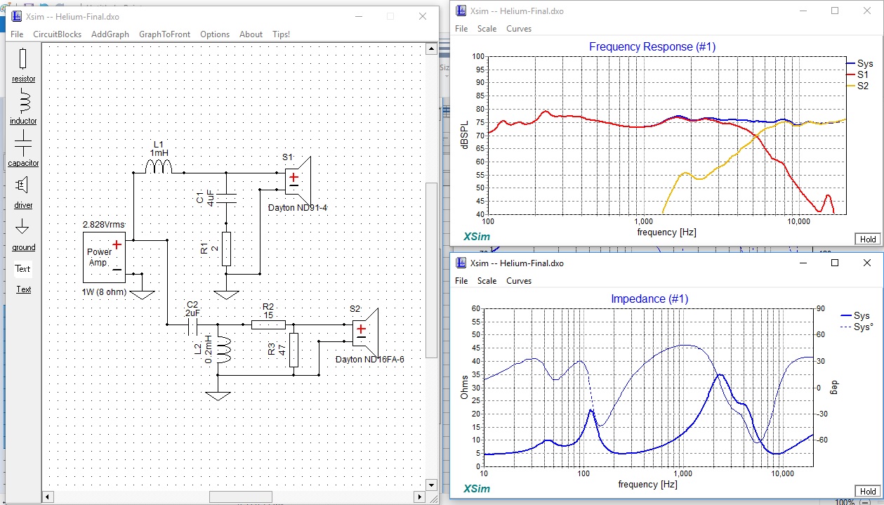

The speakers are DIY Helium Micro Monitors. The full range driver is rated at 30w and they have a nominal impedence of about 5ohms according to the designer IIRC
I don’t currently have any distortion.

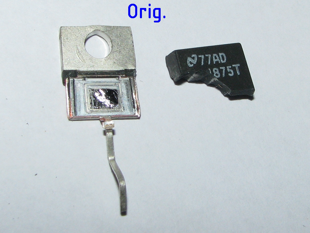

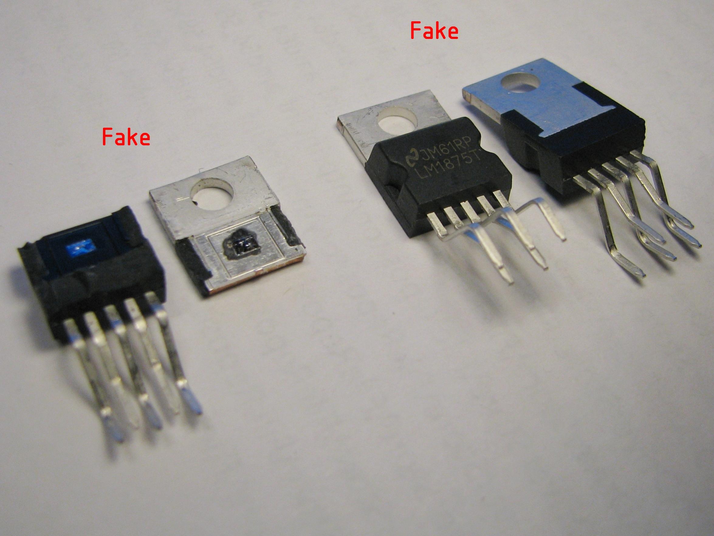

Some Pictures. 1st is a TDA2030, the Rest different LM1875 I found on my HDD. No Pics from the Net, all by me, and I think they're all original LM1875, because to fake these things is economically absolute Nonsense.
The Chinese just buy totally huge amounts of the parts needed, and so they can sell an Amp for 2€/$.
Fake and original LM1875 - crystal dimention.
