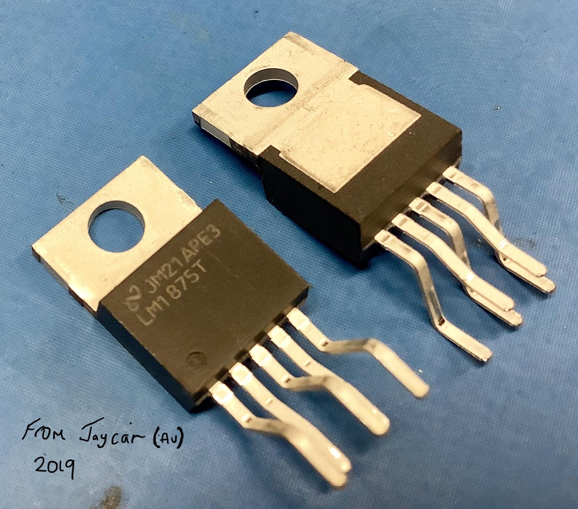

I have another pair of LM1875 chips bought from an reputable electronics shop and the only difference I can detect is much crisper screen printing.
Got a pic of these and I assume from Jaycar.
