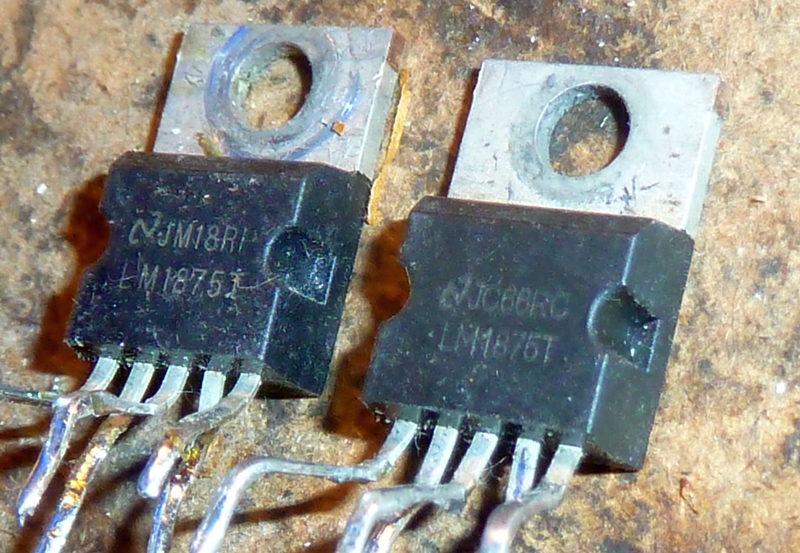

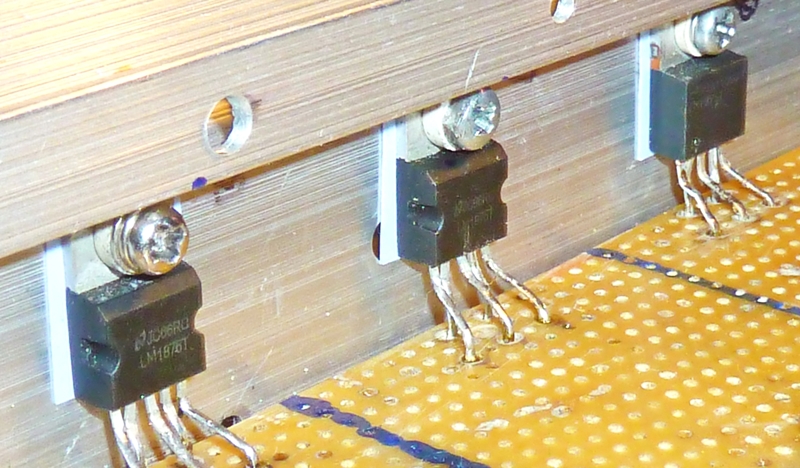

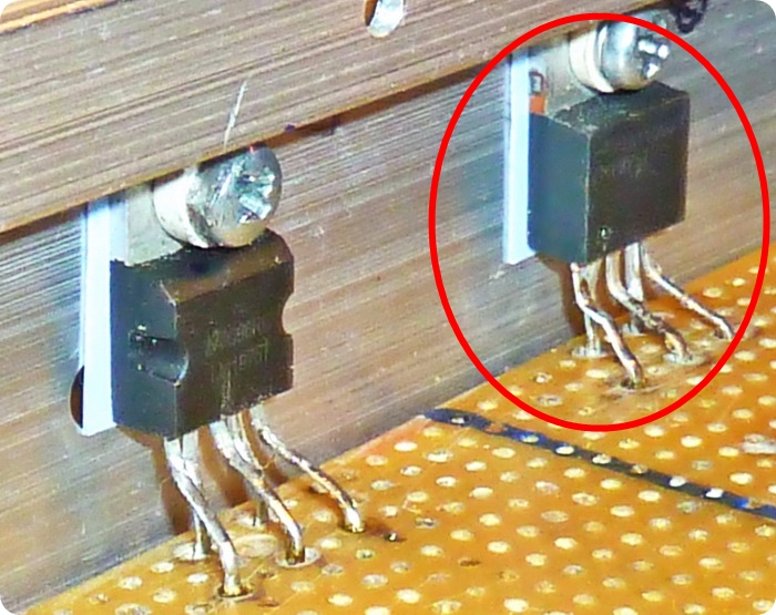

The LM1875 that come in my Kit have some "endidures" on the sides, which has made me suspect and think that they are actually TDA2030. Something like this:

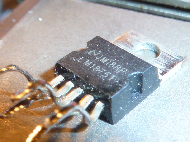

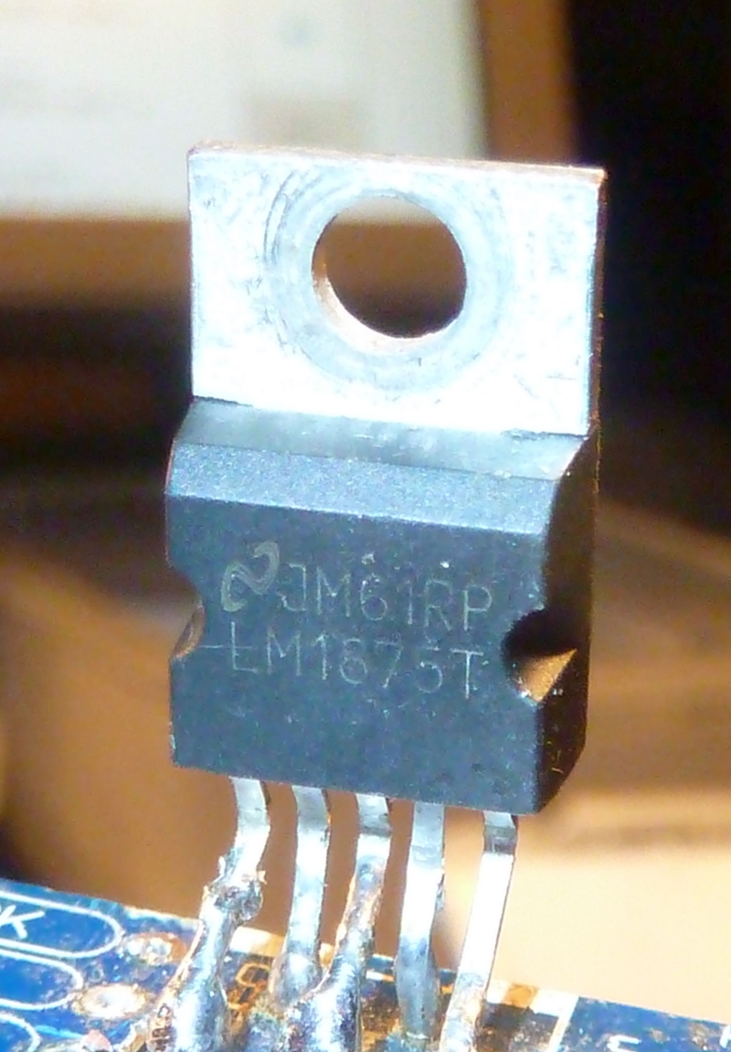

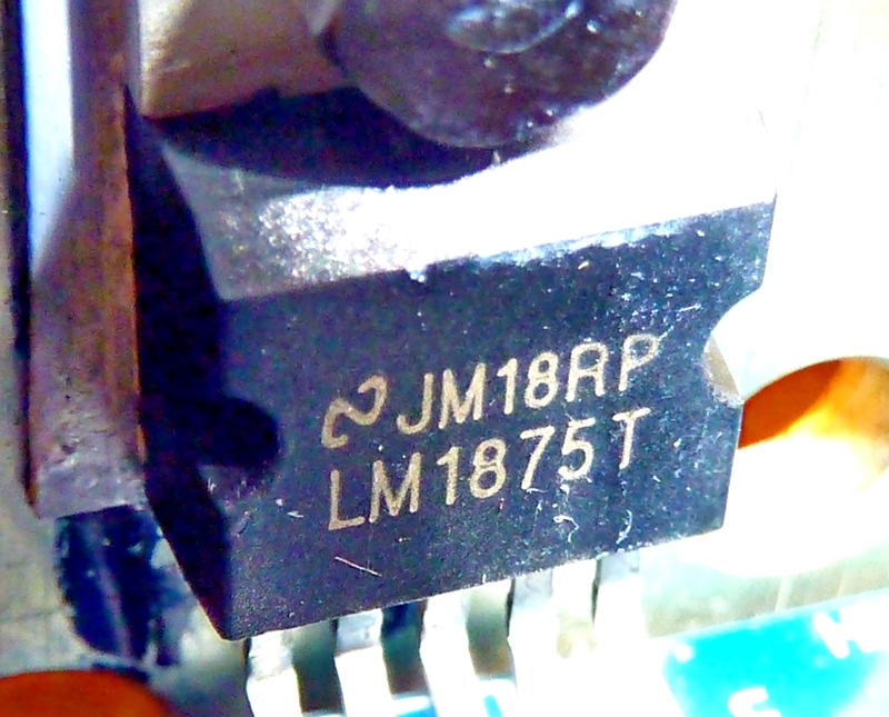

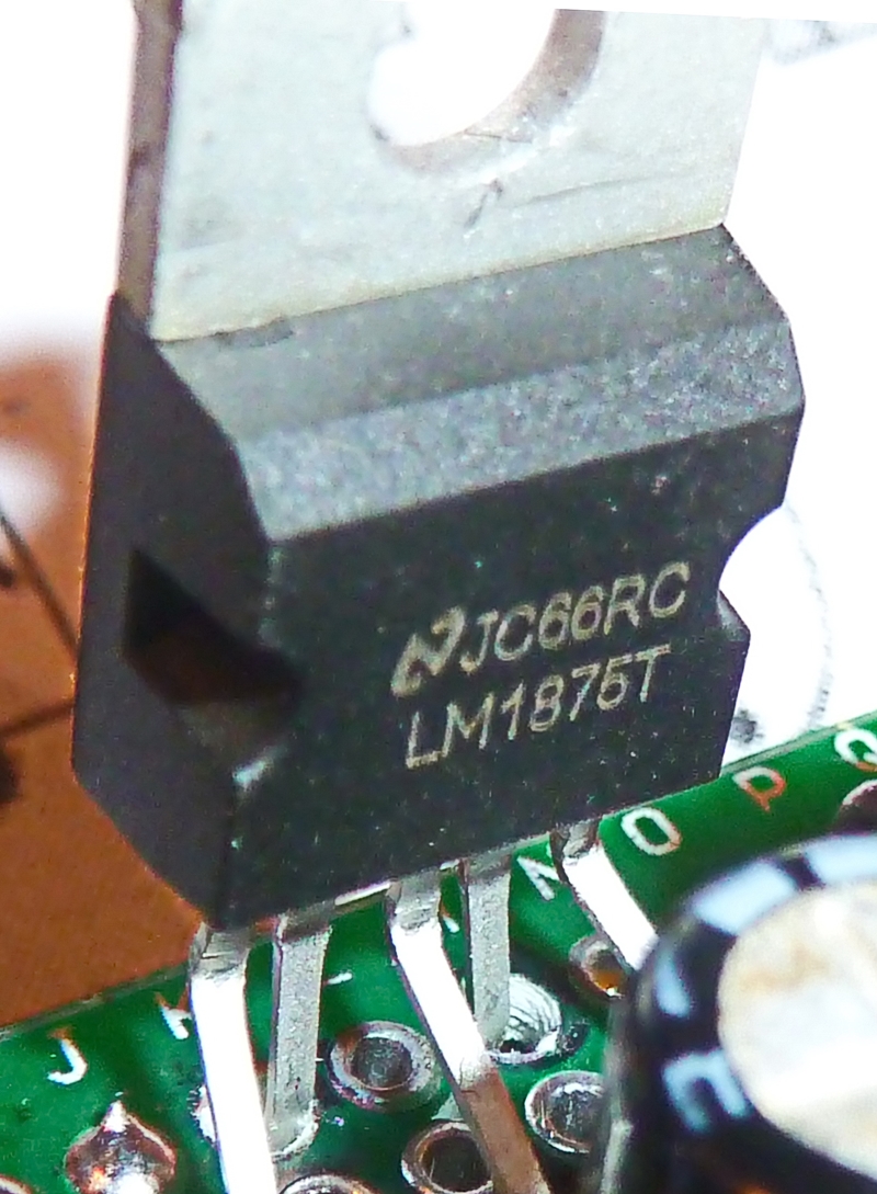

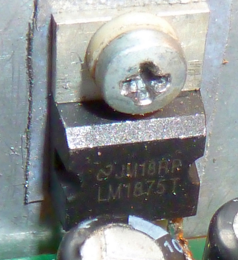

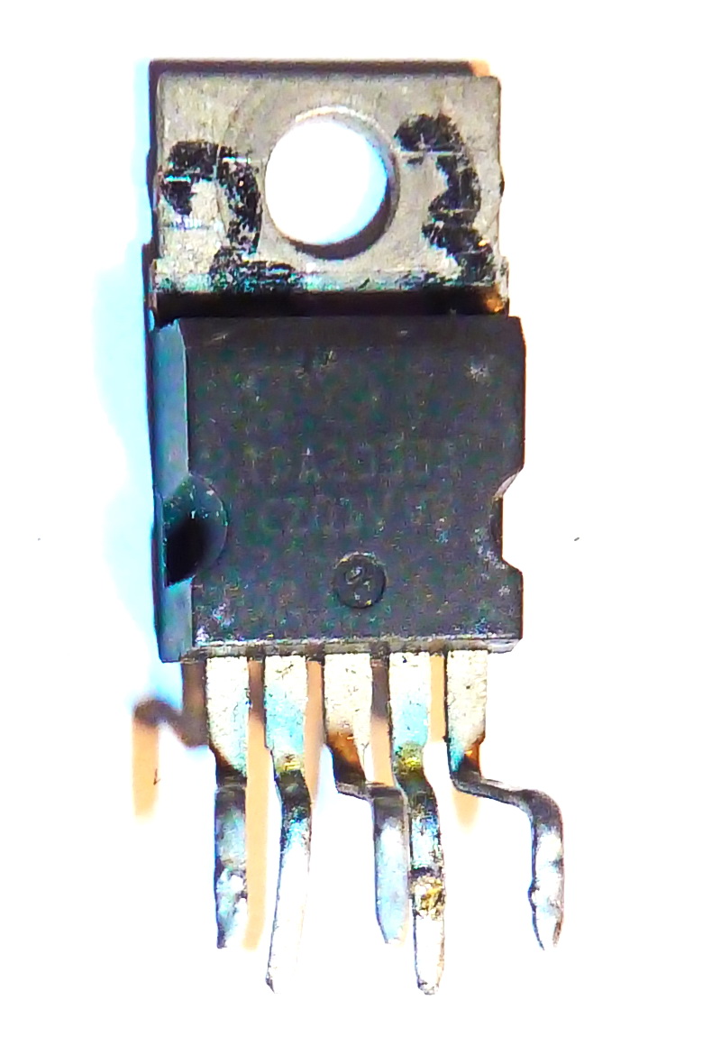

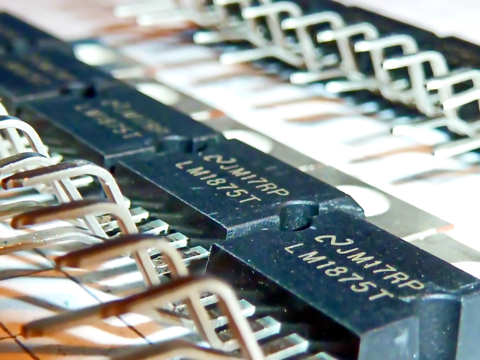

Some Pictures. 1st is a TDA2030, the Rest different LM1875 I found on my HDD. No Pics from the Net, all by me, and I think they're all original LM1875, because to fake these things is economically absolute Nonsense.

I question the authenticity of those ICs. I've been buying Texas instruments / National Semiconductor parts for a while and they never have the semi circle indentations on the sides nor the bevel along the top of the encapsulation of TO-220 parts (the ones I've gotten anyway). Go to the TI forum on their site and ask them. They will likely tell you that these are counterfeit parts.
Sure they may work but they will not reach the rated power of an authentic part, less reliability due to the smaller die size and may lack circuit protections and won't deliver as low as distortion.
You are talking about the right one. I noticed the different cases, too. As far as I imagine could the right Version be the older Production, while the newer Ones look like the one on the left. Both Versions take +/- 27V and sound great without getting hot.
Yesterday I received some original LM1875T (€ 3.31 per unit in Mouser) and they have no endidures.

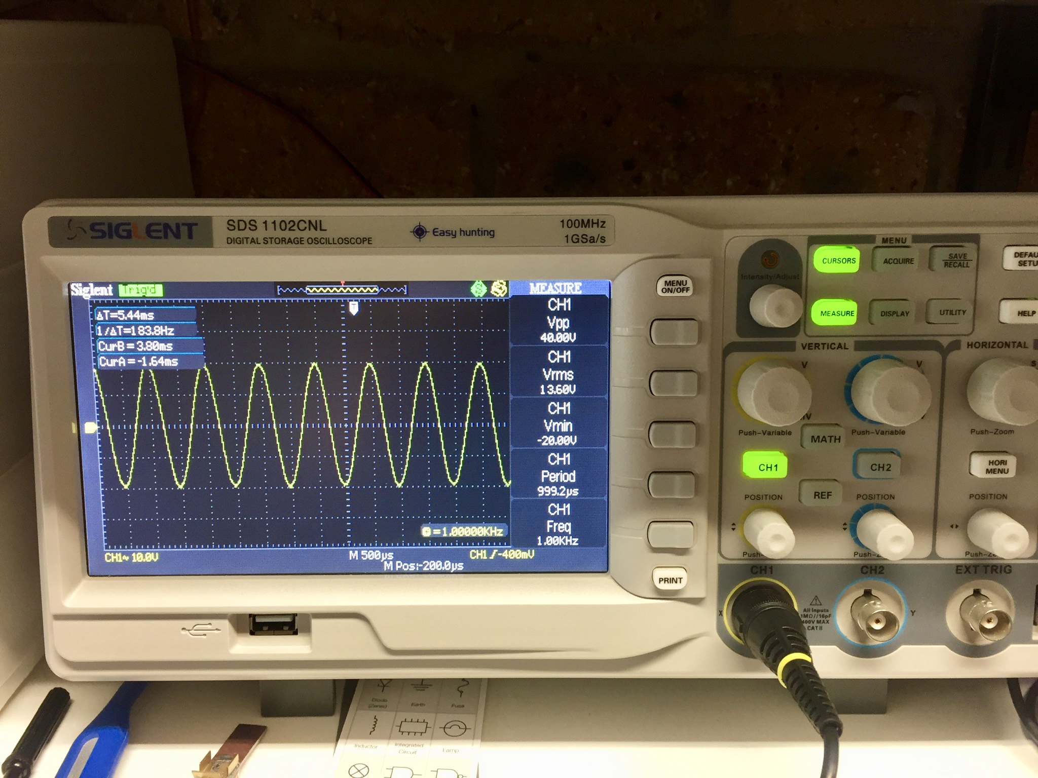

I was not using a bench power supply. Did I do wrong measuring the output RMS voltage using the DSO scoping across the load?
I don’t think the preamp is clipping when the source is the ipad min at max volume because: with the amp at low volume I can see clipping starting when the preamp is at @95% volume. I don’t get near this level during these tests. The preamp is supplied by a 15Vdc regulated supply. I cannot drive the amp to clipping without the preamp, the source voltage is too weak.
Here is a couple of pictures of my setup.
This time when I am pretty sure the preamp is not clipping:
> The load is measured as 8.15 ohms
> The supply rails sag to +/- 25.5Vdc just before clipping as measured at the amp power supply connection on the board. (I only had the load on one channel)
> The Vrms measured across the load with the DSO just before clipping is 13.6V
That gives me 22.7 W/ch in my build.
Do I have a measurement, calculation or build issue?

I'd say it's right. According to the spec sheet for LM1875 is 25W @ +-25vDC @ 1% THD. You're not far off it. Are you measuring supply voltage at the IC itself? Perhaps there are some losses in the wiring and board itself.
