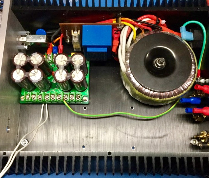

Back from holidays and some home renovations. Started assembly.
Retapped the chassis screw holes and assembled using stainless star washers. Sanded a patch between the front plate and side plate (star washers would not fit). Chassis now fully earthed.

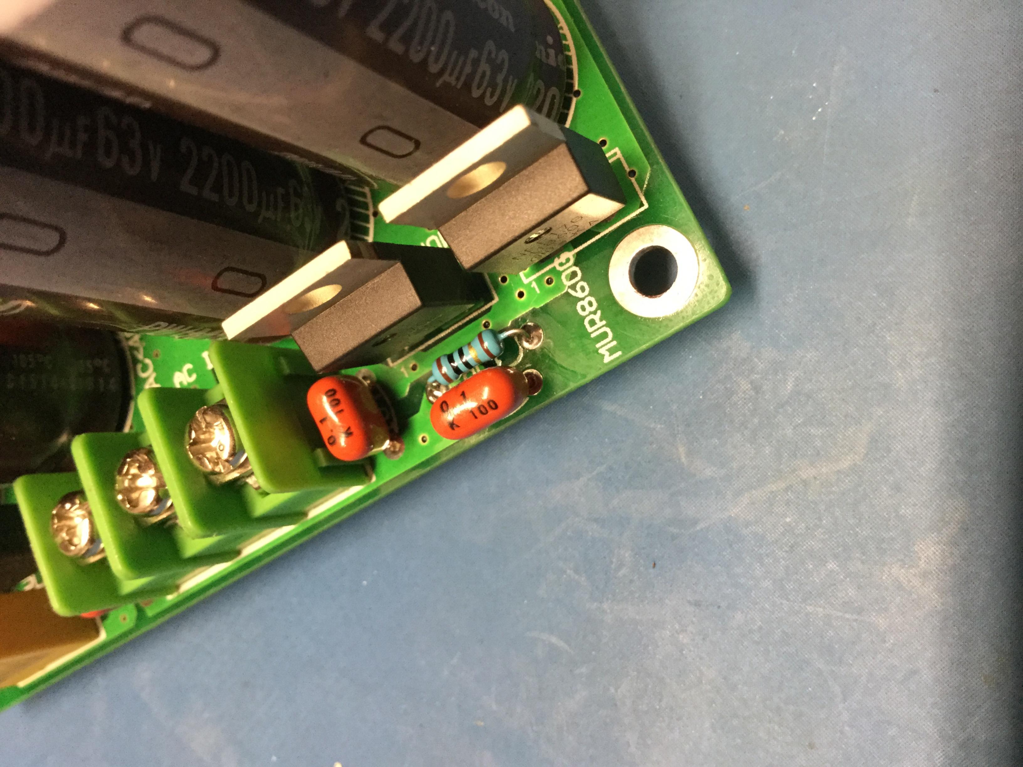

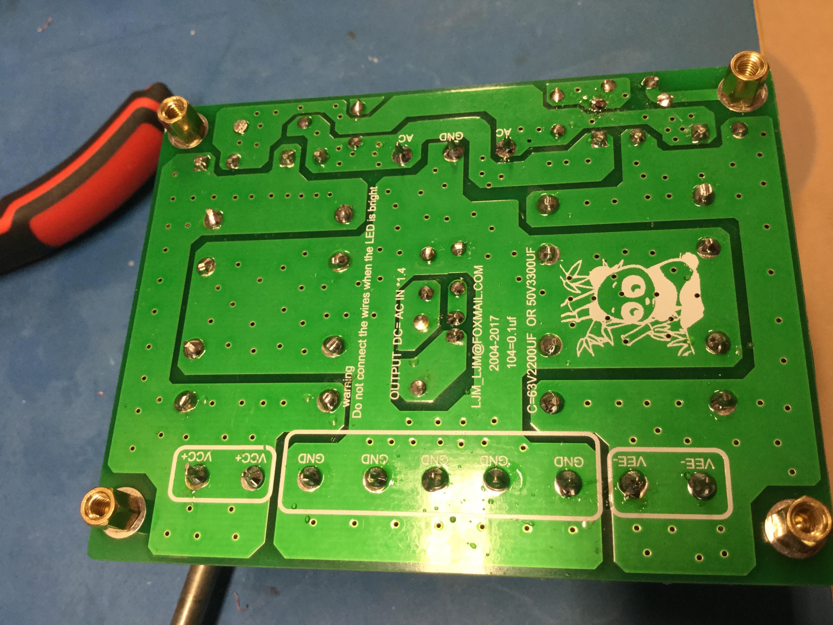

Problem: on the power supply board, a 10R resistor connects to a track that get earthed to the chassis when screwed down; this keeps blowing. The input voltage to the board is about 21v AC from the 18v transformer. When the screw is isolated from ground there are no issues and the output voltage is +/0/- 29v DC? What could be going on here?

Is the resister and its connected capacitor providing a route to ground for any DC on the input? In which case has the cap shorted and is letting high AC current to leak to ground?
PS no connections made from the ouput terminals in the above desciption ( forgot to mention)
Another Q, does the 10nf X1 cap across the 240v switch naturally leak current? Even with the power switch off I measure a 1 volt AC between te terminal of the secondary windings on the small potted transformer.
Power supply issue now sorted out with help from the Power Supplies Forum.
There was a short between an earthed mounting washer and the positive DC rail that was detected with a 100V insulation tester (nice spark!). The PS (8800uF per rail) was tested at 25V and delivered 2.5 A into an electronic dummy load with about 1.8V P-P ripple.
Next I will check the speaker protection board.
In the meantime I have replaced all the resistors and some of the capacitors on the LM1875 boards with branded parts (Panasonic caps and Dale resistors) so I need to do some bench testing before assembling it all together.

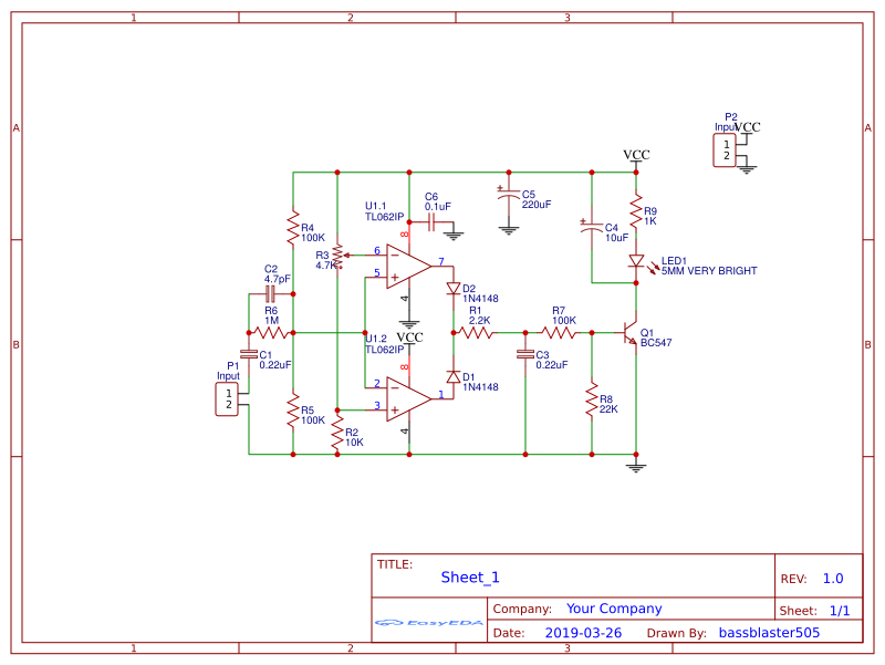

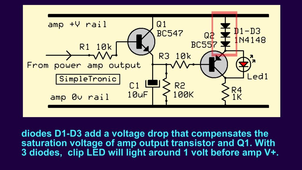

I always wanted to add a clipping indicator but couldn’t find a circuit until now.
Does anyone see any issues making a small to take two of these circuits, one for each channel?
Also, are there flush mount light pipe LED holders available for a nice install without a bezel on the front panel (8mm thick)? I think I use this method for the power indicator LED.

Also found:
>this PCB on EasyDA but there is no description. 10 JLCPCB boards for $7 shipped. Opamp based circuit
> and another 2 channel kit on eBay at about $20
Both are quite small but I think I need two boards for the first one.
