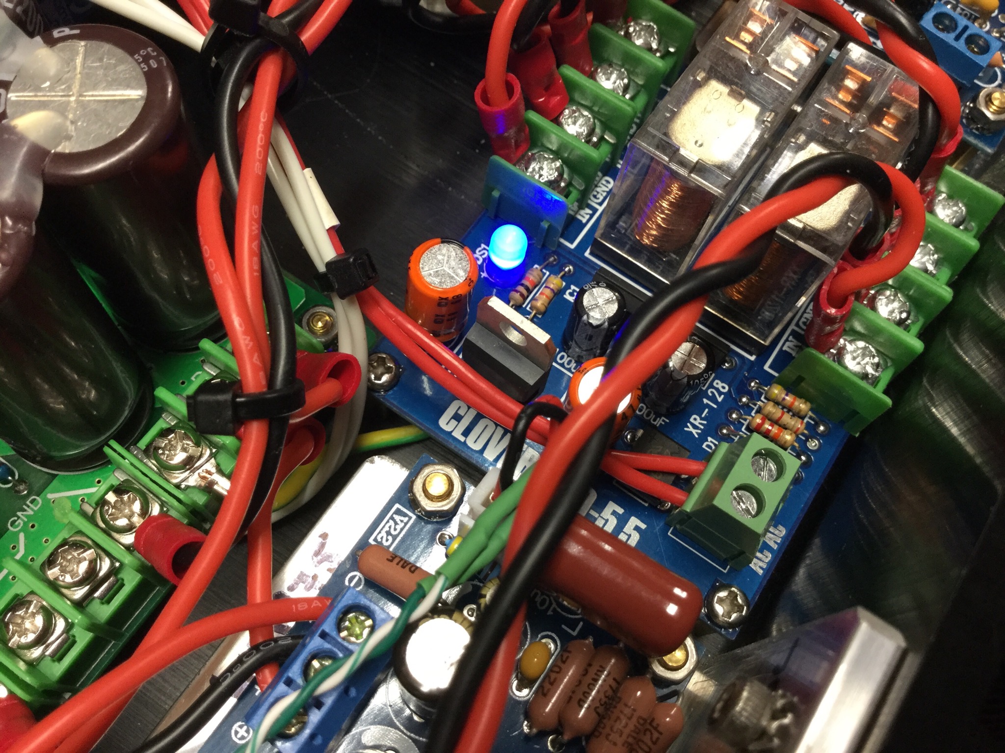

The mosfet shown on the speaker protection board gets to about +80c. Is that too hot and should I install a heatsink? One is indicated on the PCB but was not supplied.
(New found respect for electronics technicians, what a fiddly job)
Not a MOSFET, it is a 12V linear regulator LM7812CV. 125C max operating temp. Think I will find a heatsink.

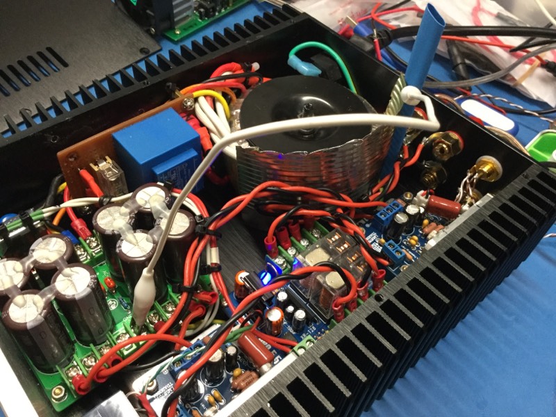

It is the amplifier closest to the toroid that is buzzing. And the buzz is gone when the pot is at zero volume but present at the same volume throughout the range ( I can hear it because the speakers don’t output until the end of the full turn). Wonder if the pot is dodgy as there is some LC/RC instability at max rotation.

Bulldog clip on the TO-220 dropped the temp by 20C for now.

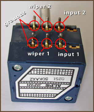

Volume pot
Volume pot
I’m not saying that this is what transformer shielding is supposed to look like 😀 but this made no difference.
Any advice on the volume pot selection? I have to fix that first.
You have correctly identified the POT pins, however not how you connected it up.
Would be of help to have diagram of how you wired the pot into the circuit...
The connections at the pot were fine. The polarity of the amp board input plug was wrong. I think they were assembled at the factory backwards.
No buzz anymore and normally functioning volume control - thanks Blu.

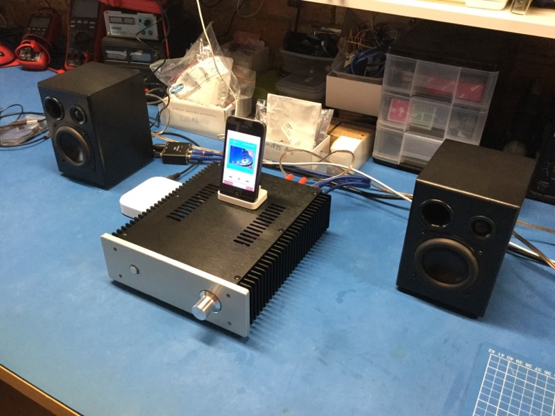

Here you go, one DIY stereo. Hope it inspires someone else.
(PS only consumes 15W at full vol)

Great job! You must be very satisfied.
Forgot to say thanks for the initial layout guidance - that helped me get going.
