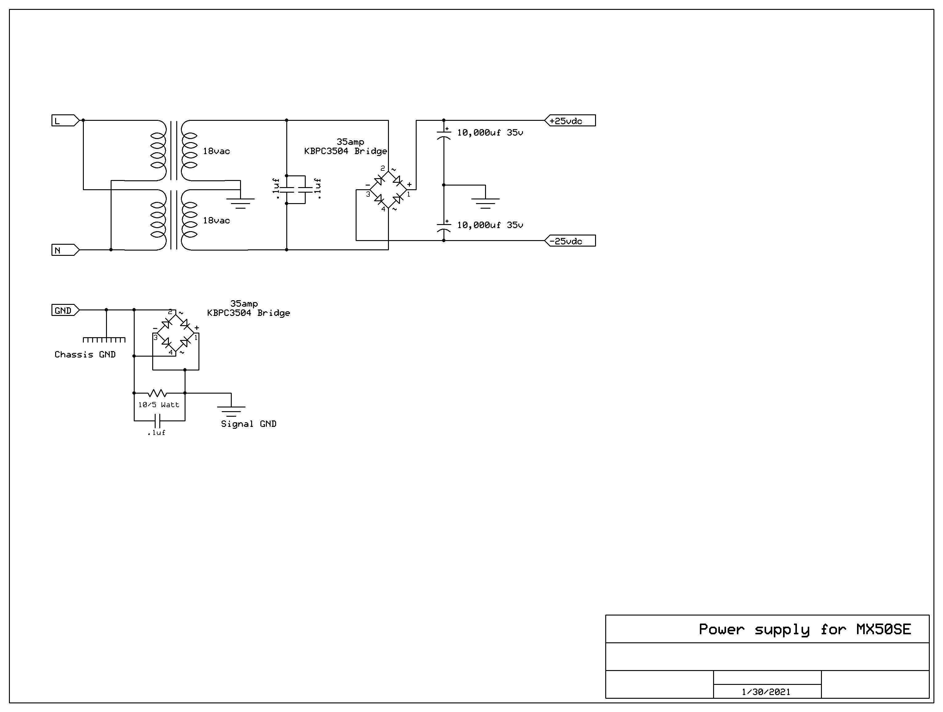

Signal Ground to chassis ground update
Thanks Kozard...

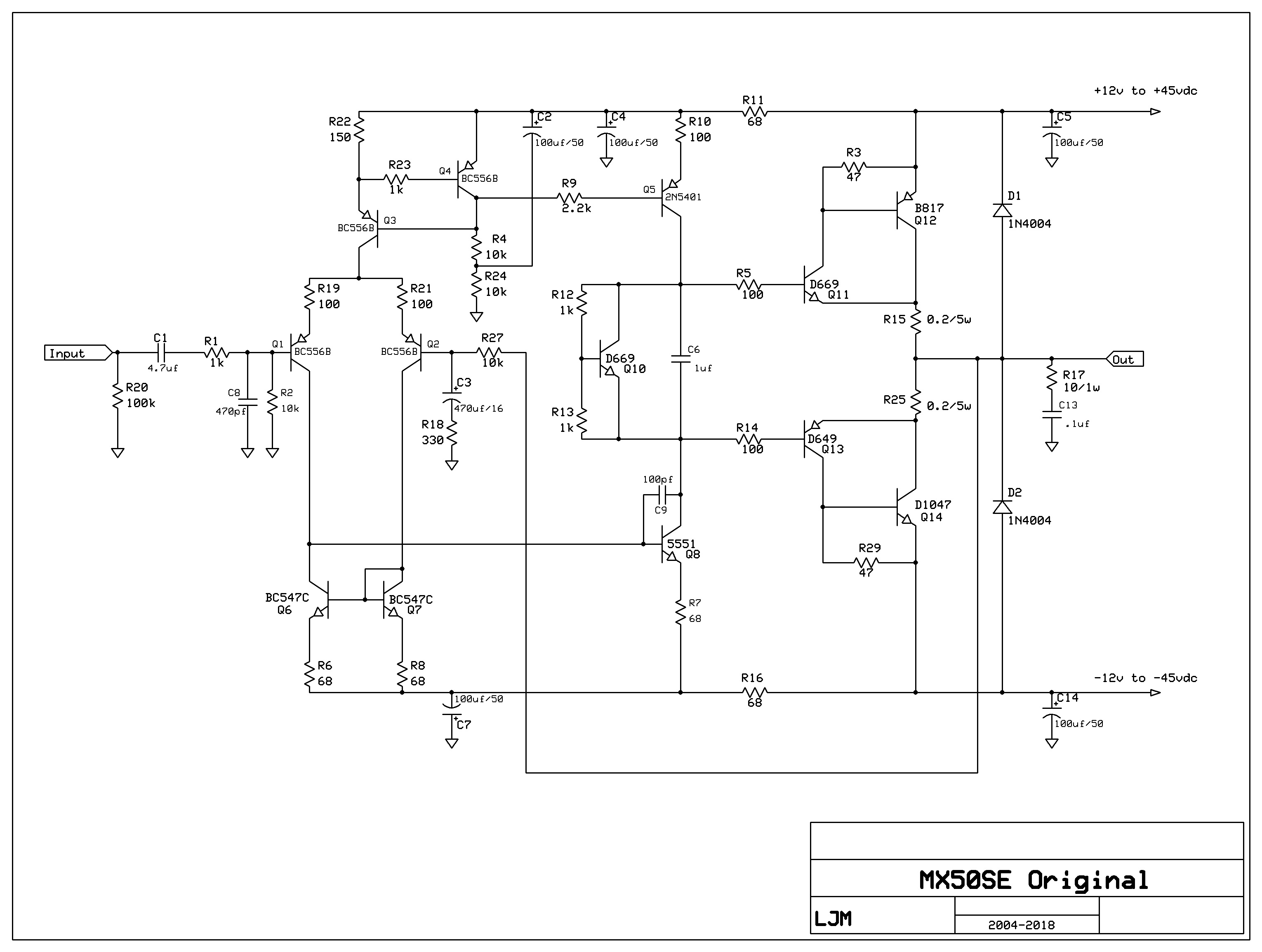

  4. Build and test the stock design first before any mods. Give it a week or so of regular use and listening before mods.

  6. Build and test your power supply alone first before connecting it to your new amplifier.
Before you power up the modified design you could even post clear pictures and others can try to spot issues before you power it up.

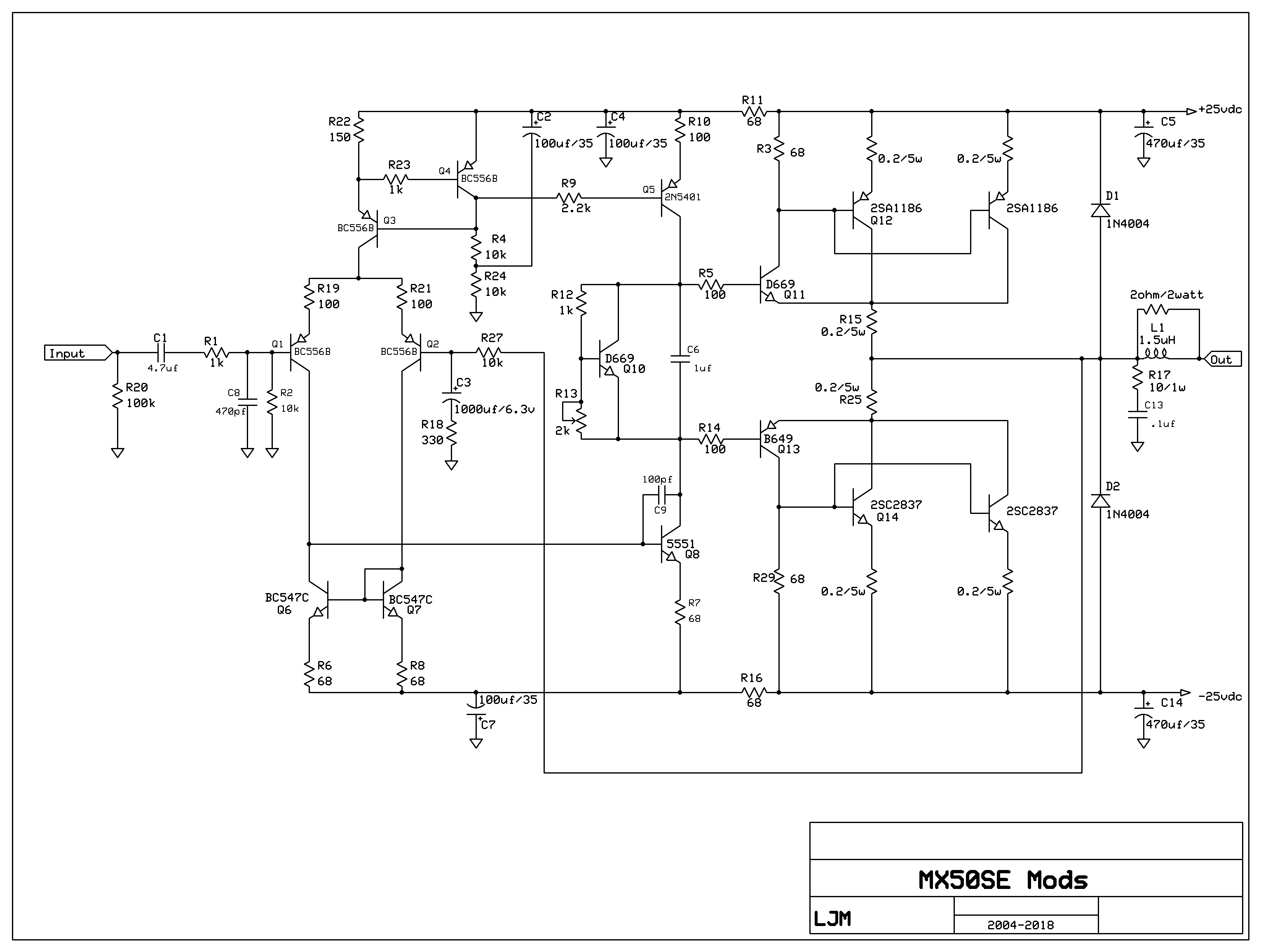

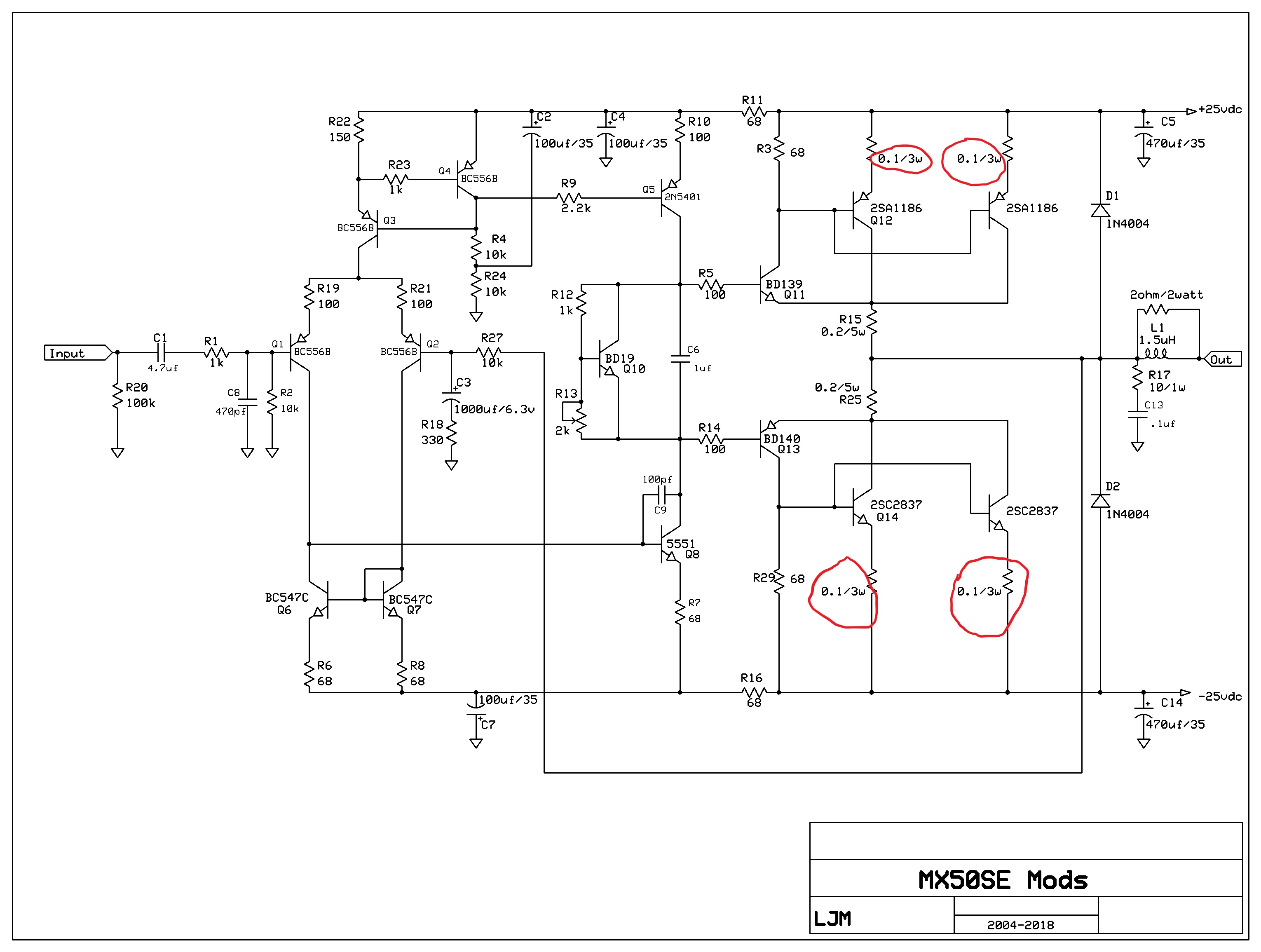

On the LJM 20.5 he uses 0.05 there. I used 0.12 (all I had) when I paralleled four CFP pairs.
So I would use 0.1 if you have it. If you don't then 0.2 will not cause a problem.
I wonder what the dependence (of distortion) is on emitter sharing resistor values on paralleled CFP outputs? Can anyone else comment and shed light on that?

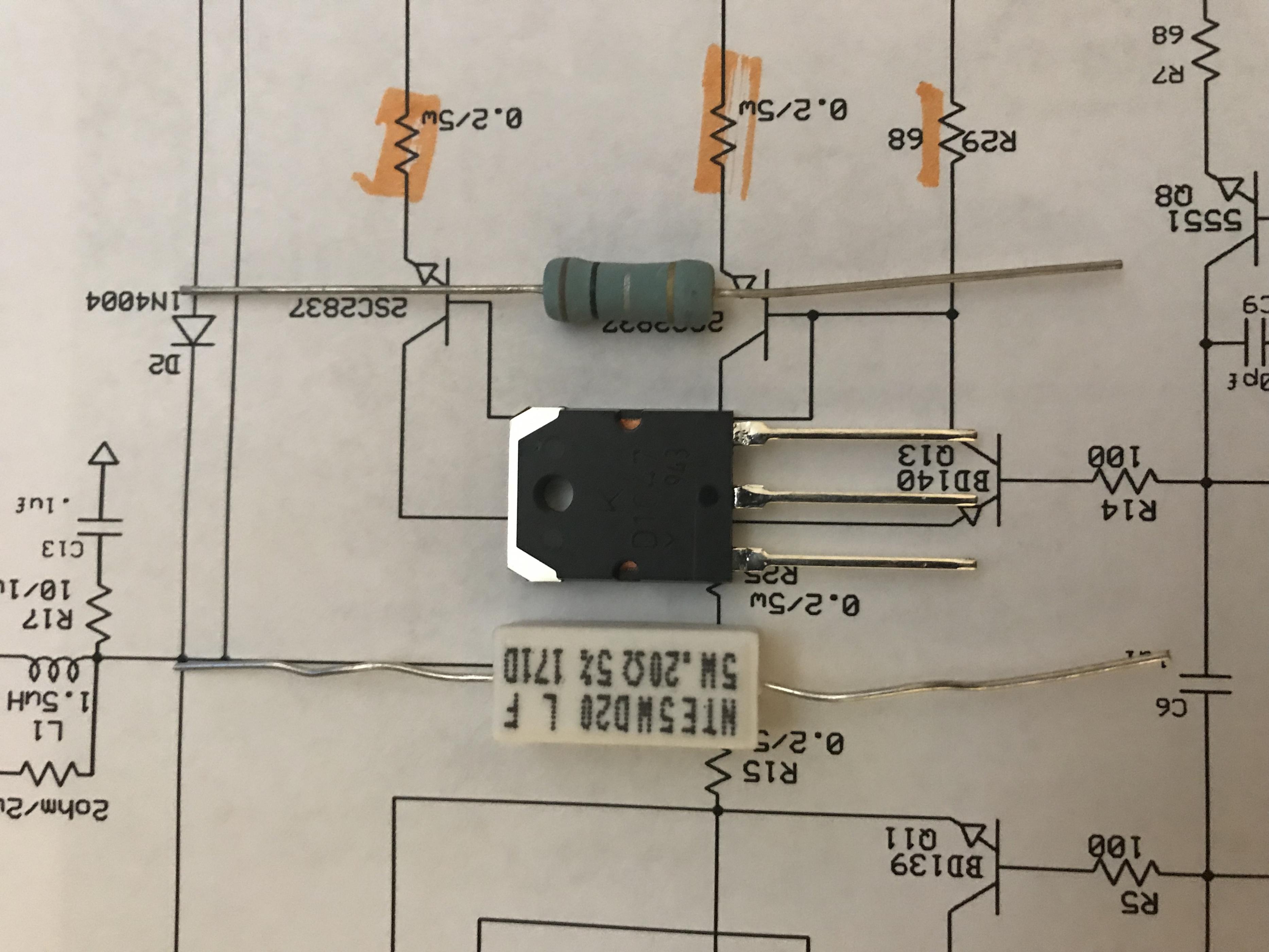

I was looking through my parts bins and found new old stock 0.1 ohm and I think 3 watt resistors that were used for soundstream amp emitter type out-puts.
Is 3 watt's going to be OK?

Yes. The added resistors are emitter sharing resistors so that the added paralleled output transistors share the current in a sufficiently equal fashion.
The other existing resistors are where you will measure the bias current which needs to be sufficiently stable as well as the correct value.
On first power up you need to check and set the bias current. Start from no bias and slowly work upwards as the amplifier heats up to normal operating temperature.
Also on first power up you need to check the output offset. The output offset and the bias control are a couple of important first diagnostics. If either are not working immediately power it off and find the fault. Use a Dim Bulb Tester or current limited laboratory supply for first testing. You don't very much more than your bias currents for the first checks to make sure nothing is in backwards, shorted or damaged.
If you let it draw current until a 5A slow blow fuse goes then you will likely have smoke before you find a serious fault. The components on the power amplifier board may (quite likely) blow up first and protect the fuse.
