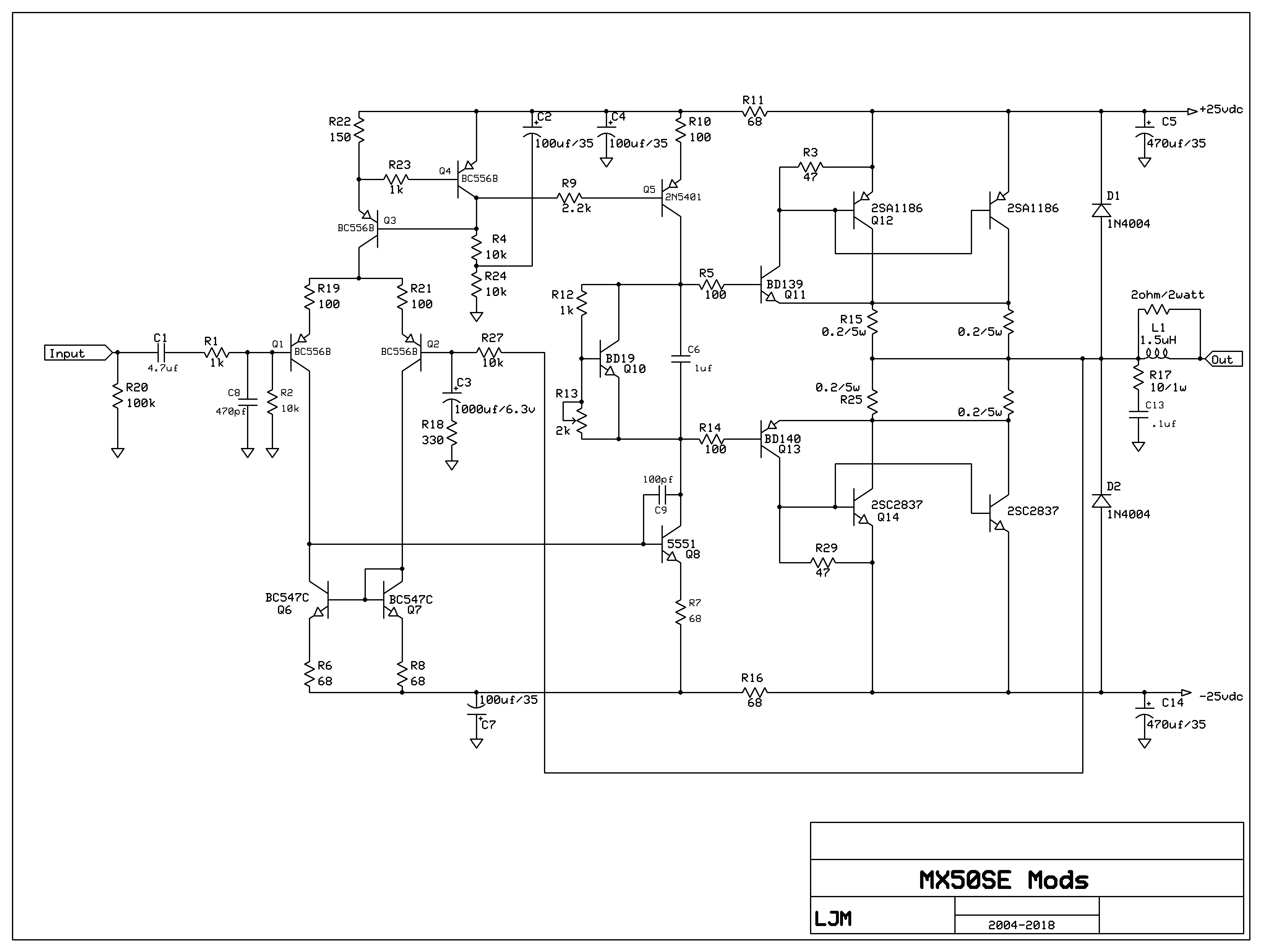

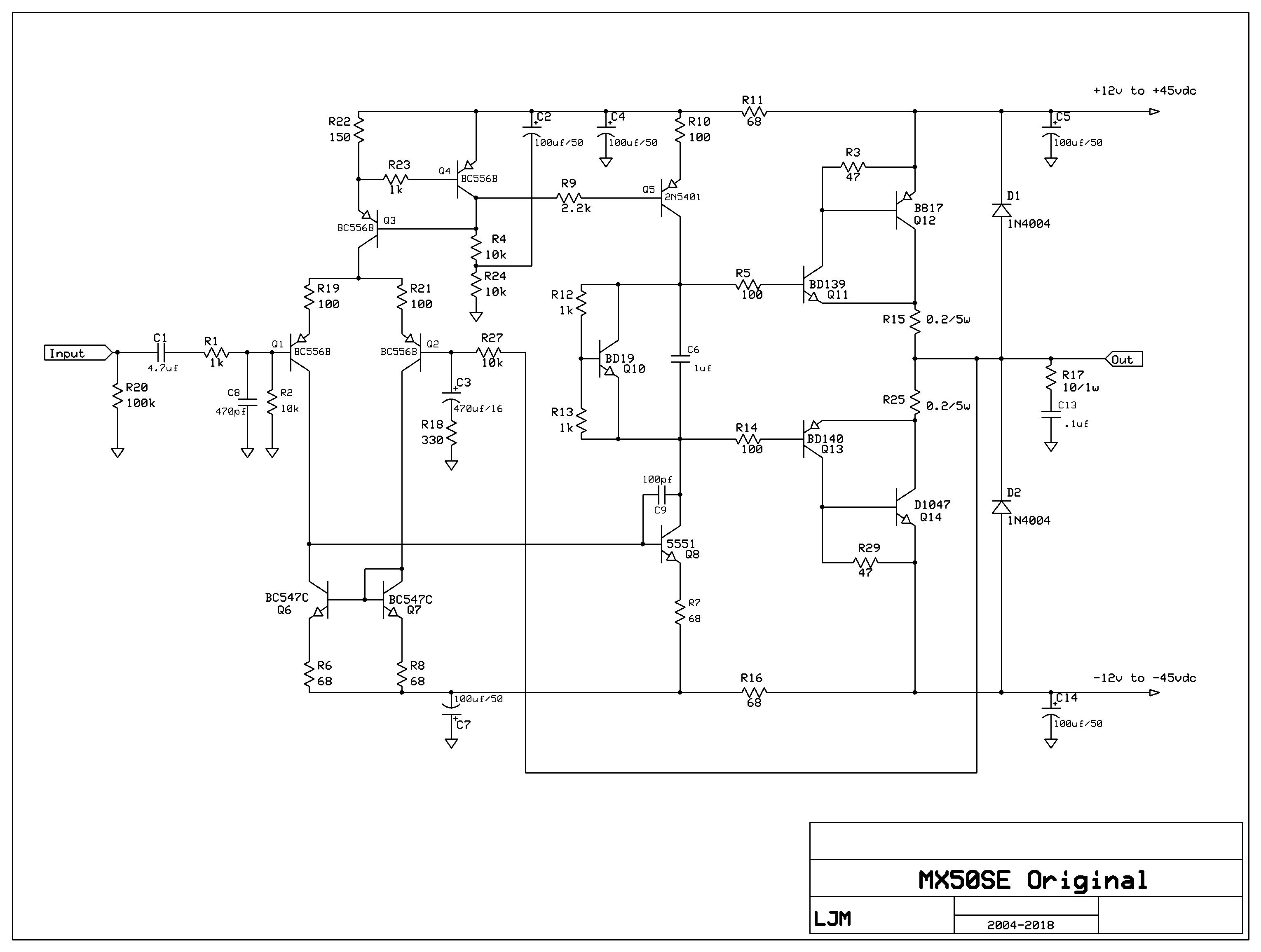

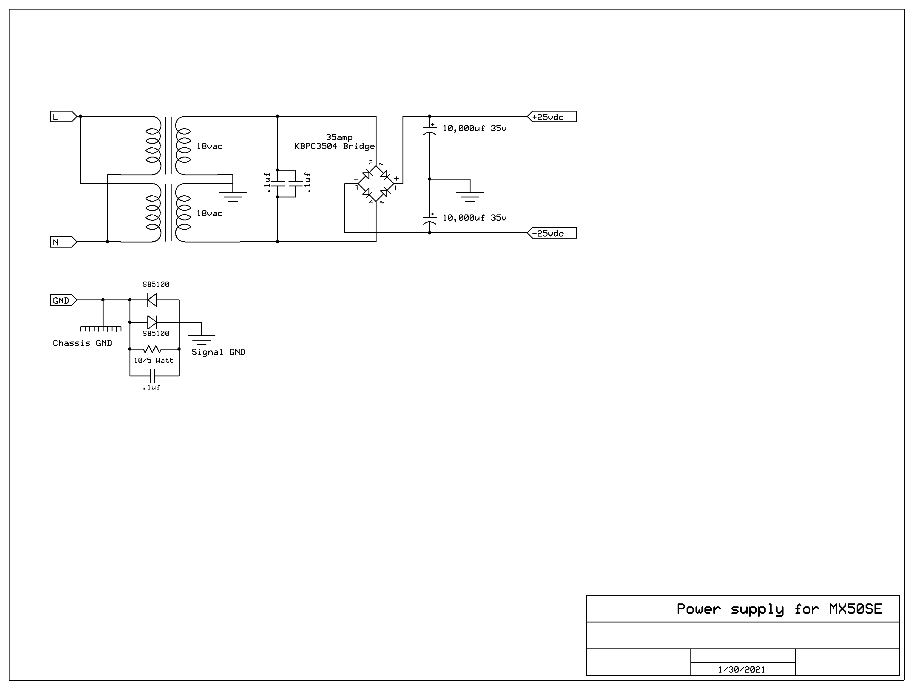

MX50SE board mods
After reading all the threads on the MX50 and MX50SE (more than once) and gathering info for improvements, I decided to try and put it all together. Before I finalize the install of all this into a chassis I wanted to make sure I wasn't missing anything and possibly get more opinions, suggestions from experienced people on this forum.
1. Was told to try and use +-25vdc on the rails. K, got it.
2. Purchased a AS-4218 400VA 18V - 0 - 18V Toroid.
3. Purchased a KBPC3504 35amp Full wave bride.
4. Purchased two 10,000uf/35v audio grade caps from mouser
5. So with 25v rails I can use 35v capacitors on the board which allows
470uf/35v cans to fit on the board.
Plus, correct me if I'm wrong, Caps should be at about 80% of the voltage
to function correctly at the rated uf.
6. Replace the 470uf/16v cap with 1000uf/6.3v. Does it have to be NP?
7. Replace R13 (1k) with a 2k multi turn pot.
8. Created two 1.5uH air inductors for the out-puts and 2 ohm 2w resistors
paralleled with them.
9. Purchased a Gump's grocery Speaker Protection Board from Amazon.
10. Purchased four of 2sa1186 and four 2sc2343 from Digi-Key. All have case
code Y.
11. Purchased four 5watt 0.2 ohm for adding the extra pair of final transistors.
12. When adjusting bias for this configuration, I guess I could do the notch
distortion method but then of course check the voltage across the
collector resistors.
Am I missing anything?
I am not planning for an auditorium sound system just something that sounds excellent.
I've attached the stock and modified .SCH that can be edited using ExpressSCH. It's a free download program. I had to change these to a .txt file so you have to change the extension back to .sch after you download it

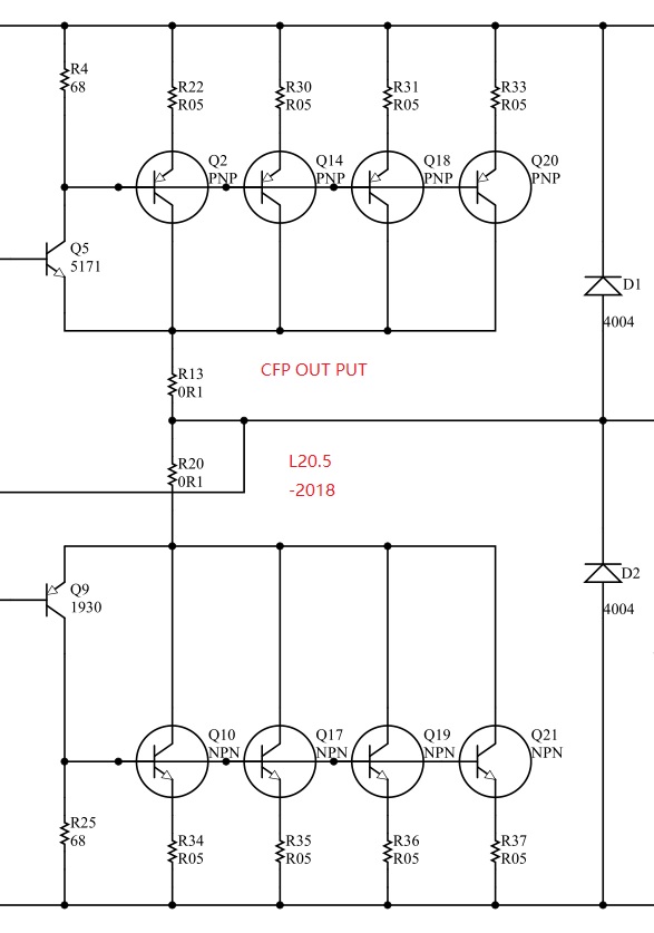

Please see the attached schematic to see how to add emitter resistors for current sharing in a paralleled CFP output. They must be in the emitter of each output.
No.
I have used 0.12 Ohm each for paralleling four CFP pairs and LJM uses 0.05 Ohm in the L20.5
If your outputs are well matched you can use those lower values.
I measure the distortion (at several power levels) while I adjust the bias and observe how a particular amplifier behaves.
You can also use this software (Room Eq Wizard) and method with the (power amplifier) adapter cable: Howto - Distortion Measurements with REW
REW is pretty amazing software. I also used it to measure my speaker impedance. They were rated as 8 Ohms "Compatible" and they measured 4 Ohms with a dip down to something like 3.5 Ohms.
Always monitor the voltage across the emitter resistors and of course check your offset voltage before starting too.
Please see the following two links with regards to grounding and your loop breaker which I see (in your third schematic) has 5A diodes:
Earthing (Grounding) Your Hi-Fi - Tricks and Techniques
Audio Component Grounding and Interconnection
