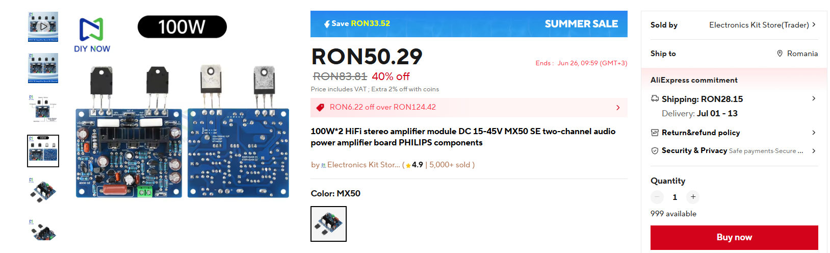

Recently I've purchased a MX50 dual pcb + components kit from aliexpress.
https://it.aliexpress.com/item/1005...t_main.16.1fb13696tti5pw&gatewayAdapt=glo2ita

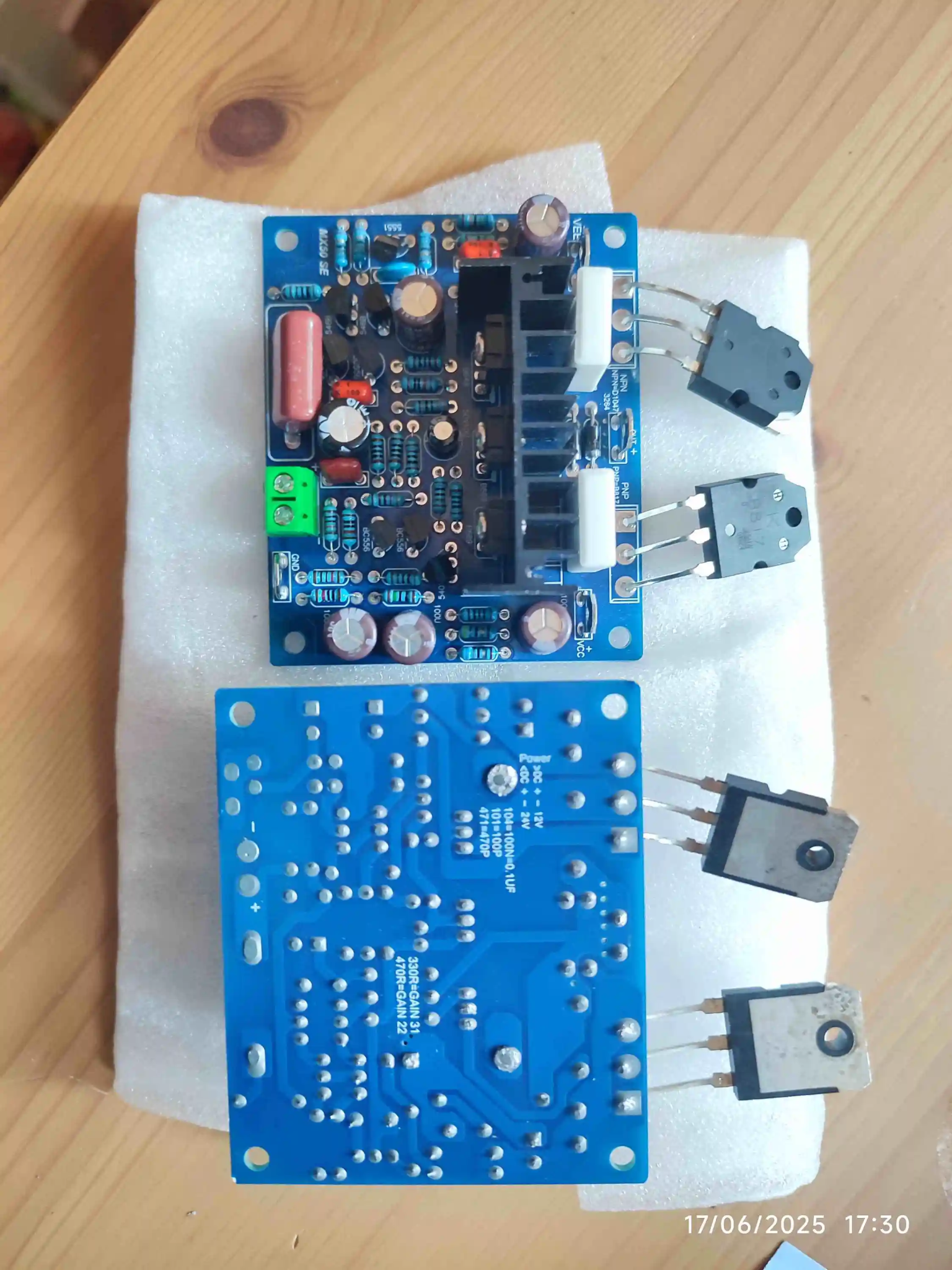

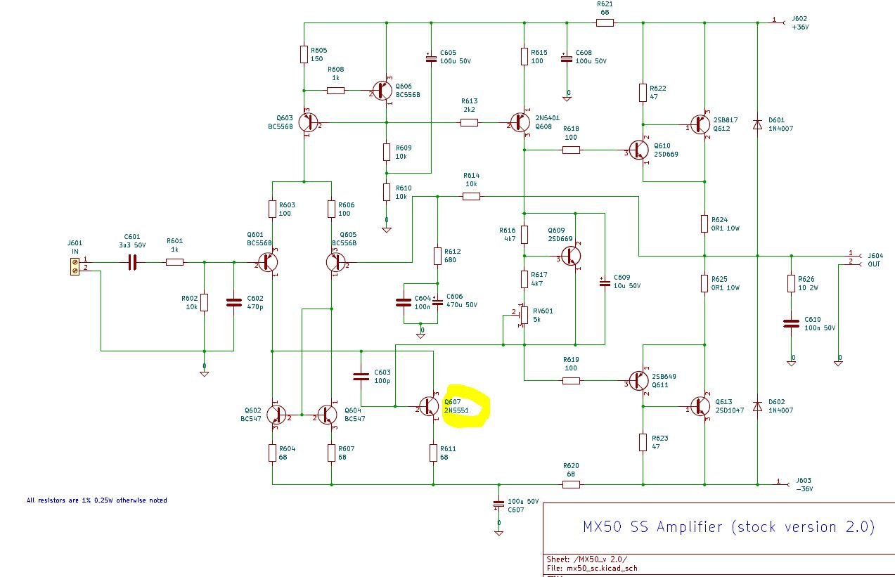

During assembly I've noted some differences between my past assembly and this one.
Now I have a trimmer (5k to regulate bias), but mainly I've discovered difference in BJT 2n5551 (Q), strange configuration, different from usual.
Is it plausible or a complete mistake in design?
Could it work?
Tkankyou.

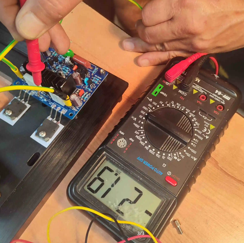

Hello!
I have received(packed just in plastic bags..) with bent transistors. Both the board are defective, they output Dc current on speaker output...
I have asked for a refund...does anyone have a valid link for original and working LJM MX50SE finished boards? I thing I have found LJM's store on taobao...but they do not ship to Romania..
Hello!
Hello. I think you have purchased counterfeit goods.
The current MX50SE is genuine. There will be a 502 (5K) adjustable resistor on top.
It's the genuine product.
And it will have the LJM logo. And an image of a panda.
Yes, this is genuine and there is no problem. The genuine version will have a 502 adjustable resistor.Hello.
