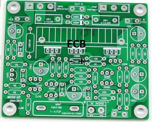

hello,
here the picture of the pcb, the condensator is the one circled in red
i've built the amps with the electrolytic, will see...

Is it a yellow monolithic ceramic capacitor? Can you post a picture? I have built many LJM kits and that capacitor across the Vbe multiplier has never been an electrolytic. Always a monolithic ceramic capacitor as shown in my attached image. Please post a picture of your capacitor to prevent a mixup.

thanks kozard for reply 🙂Is it a yellow monolithic ceramic capacitor? Can you post a picture? I have built many LJM kits and that capacitor across the Vbe multiplier has never been an electrolytic. Always a monolithic ceramic capacitor as shown in my attached image. Please post a picture of your capacitor to prevent a mixup..
it's definitely an elecrolytic one, same make as the others : Nichicon
no need for a picture, but can i stay with it , if so which sens to put it, i mean where should the + and - go ?
the amp has not been fired yet so if really a bad idea i will have to request from vendor, or buy new ones, at expensive postage fees 😡
second, is the value of 10µf a need ? as i saw many picture of the pcb with 105 printed instead of 106 on mine ? i ask as if i can find 1µf from trashbin pcb, i will do that. Should be more common value in ceramic.

In that position I have seen 1uF all the way to a huge 100uF 50V (in a Denon AVR-3808). From my understanding a 10uF electrolytic will work fine. The capacitor leads are connected to the first two leads of the Vbe multiplier 2SD669 (traces on the back of the PCB). The 2SD669 pinout is ECB so you need the negative lead connected to the first pin (left side) and the positive lead connected to the second pin which is the right side of the capacitor footprint. See the illustration I have attached.
I suggest you still upload a photo of the capacitor, the PCB and the entire kit. Something seems wrong. I have quite a few LJM kits and I have never seen LJM use an electrolytic there before. I wonder if your kit is genuine or if something is perhaps off. Where did you buy the kit?

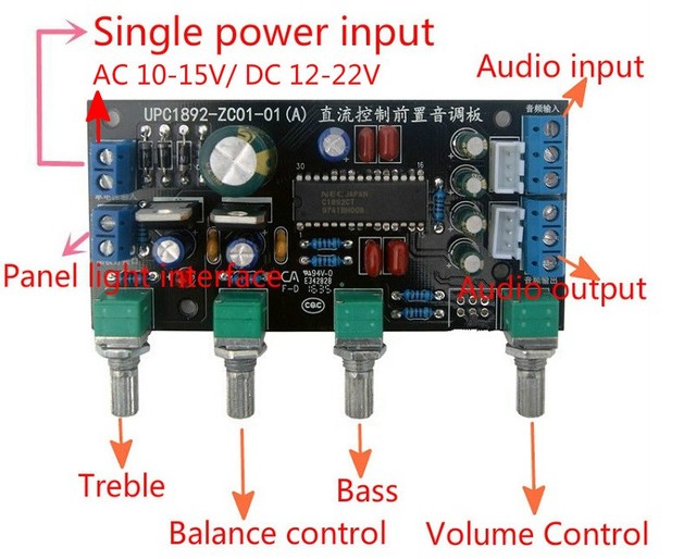

re,
i'm going to use this preamp, if it is a preamp...
so i don't know the ratio in terms of output, the main input will be the headphone output from a PC (green jack)
i kept the resitor (330R) a bit lifted, so it will be more easy to remove .

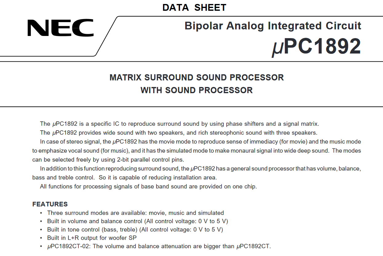

I am not familiar with that board. I don't know if that is a preamp or if it is a surround sound processor. (See attached datasheet screenshot.) I don't know what gain it has (if any).
For small computer speakers and close listening levels you might find that you have a bit too much gain. However I don't know what your input signal level will be.
it's ok, i was not aware of bipolar electrolytic
Odd that it is a 10uF BP. Not bad, just odd since I have not seen that in any LJM kit before.
