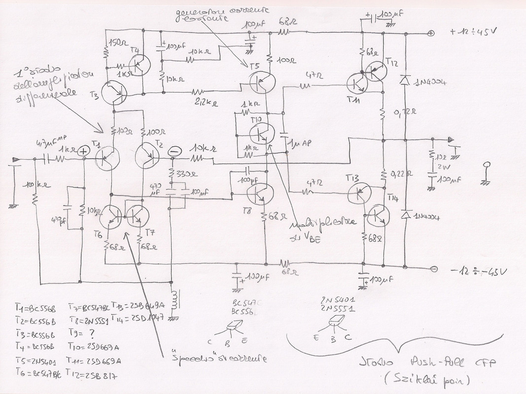

I too, like many of you, am playing with this small but very efficient amplifier.
At the lowest voltages, the quiescent current of the amps actually stops at about 30mA, but as soon as the voltage rises, also to obtain more power, the quiescent current rises and even a lot.
Not wanting to polarize the final transistors in class A, I too have adjusted the resistance between the base and the emitter of the VCE multiplier, obtaining the correct quiescent current at +/- 40V of power supply.
What I haven't read from you is if the 2N5401 transistor overheats.
Mine yes, and by touching it it releases part of the heat to the finger, allowing it to vary to the quiescent current of the amps by a few mA.

MauroDiY... Do you think I should try some pairs of new old stock 2SC5200 and 2SA1943 or 2SA1302 and 2SC3201 that I've had for years when I repaired soundstream amps? I will be using a 250va 30-0-30 toroid. +-42vdc
In my humble opinion, +-42V is a little bit too much high supply at power rails, T5 in the schematic I provide below gets hot if you push over +-30V in my amps. Furthermore, the more T5 gets hot the more the idle current rises thru power bjts.
I think if you wanted increase the supply voltage to +-42V, you have to trim the bias current of the power bjt, reconducting it to 30mA, modifying ohmic value of resistors around T9 on the schematic annexed to this post.
I would to replace power bjts with a 2SC5200-2SA1943 pair or TTC5200-TTA1943, too. Just bought a few couple of TTC5200-TTA1943.
Why ? Becouse they seem more robust looking at the datasheets. I haven't already tried, but in my opinion there isn't any reason wht they wont work good, just think we have to check the idle current.
