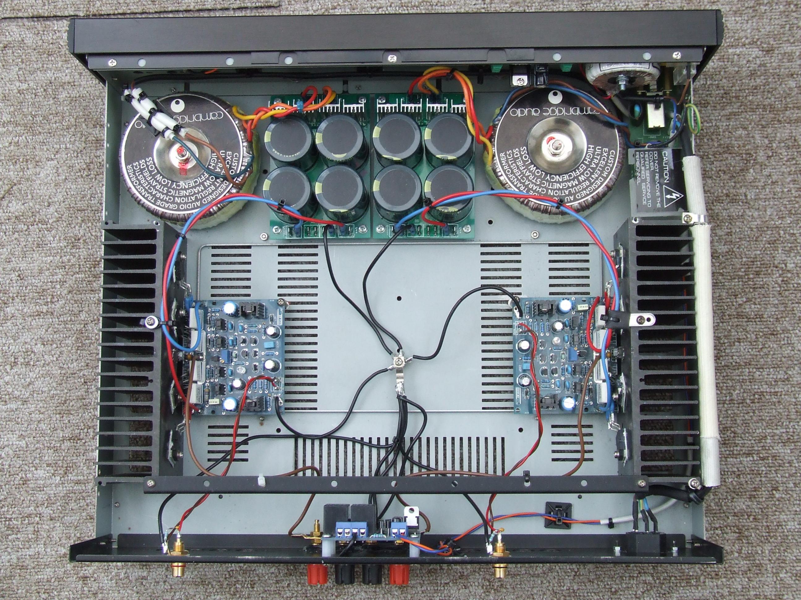

I used a star grounding system in my MX50(x2) amp (same as my MX50) - this is the system recommended by Douglas Self.
Your ground wiring is wrong!with dual power supply dont need one star ground but two star grounds indepedent ,each at its own big power capacitors,then from each a wire to a chassis point and from there one wire to dc protection.Speaker ground must taken from the point of insertion of tranformer wire ground on psu,separate for each channel,power ground from the other side after big capacitors ,also from this point a thin wire to the rca input ground separate for each channel.To apply the last one must separate signal ground and power ground at the amplifier board.Its a big improvement...
I don't have any noise issues. THD is very low as is THD+N (sinad).
Also - in Bob Cordell's book on power amps, he states that with dual mono you can have a single earth point but sometimes it may be necessary to separate the earths. However like I say, I have no noise issues at all.
Also - in both Cordell's and Self's books, they advise against using the ground lift resistor if possible. It could be required in older designs, but we have learnt a lot about grounding since then.
It's no matter of noise,but for distortion and interference.You converted a dual power supply to mono.About the 22omhs resistor it is a safety one not a ground lift,the power gnd is connected with signal gnd with the thin wire all the time.Signal ground lift resistor is a very bad thing.Star ground must be at the big capacitors for all constructions.
It's still a dual PSU with a common ground. If the ground wasn't common in the power amp, it would be common at the preamp (via the RCA cables).
Therefore each amp still has it's own PSU and only the ground is common.
This will even happen with mono blocks that are connected to a preamp with a common ground. The ground has to be joined somewhere in the chain, it's inevitable.
About the 22omhs resistor it is a safety one not a ground lift,the power gnd is connected with signal gnd with the thin wire all the time.Signal lift resistor is a very bad thing.
A safe way to lift the ground is a combination of diodes and a resistor. Otherwise it has to be a huge resistor to carry the full burden of earth current (could be as much as 13amps) in the event of a catastrophic short in a transformer.
Therefore a single 22 ohm resistor as an earth lift is unsafe.
Again - no. Slone, Self and Cordell all recommend taking the star ground away from the common link between capacitors, as that's where ripple currents are at the highest.
I suggest you buy some books and read them - I think you could learn something :)
