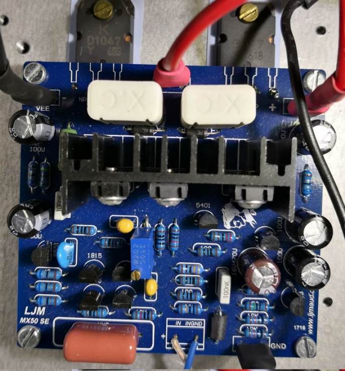

Adjusting the bias on the MX50SE is fairly easy. (The MX50 is a different amp, so only on the MX50SE)

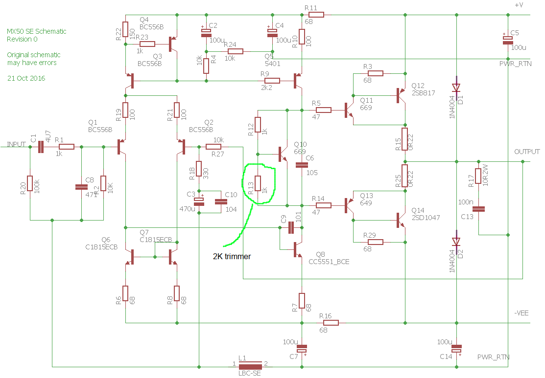

On my MX50SE I have simply removed the 1k bias resistor and replaced it with a 2k trimpot. If you bend the center pin on the trimpot out and connect (solder) it to the outer pin, and then adjust the the resistance between the two outer pins to 1k, before mounting it in the amp. Then it should be safe to power up the amp, and adjust the bias to what you want it to be. See the pictures below.
It works fine in my amp, mine came with the opposite problem that you have, mine had extremely low bias, I think it was around 2,5mA. It's been a while so I don't remember the exact numbers. But the trimpot fixed the problem.

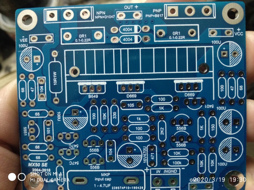

Hello,
I read with interest your solution to the BIAS setting problem, my PCB is MX50SE but the components are put in a different way. In your opinion, can I apply this solution for BIAS control? I can't find the 1K on my PCB ...

Yes, you should be able to do the same change to your board.
Your board is the new version, mine is the old version. But the amp should be the same. They just changed the layout and some component values.
The schematic is just one I found on the internet. It might not be 100% correct, but it should be good enough for you to locate the resistor you are looking for.
On the picture of your board I have marked the resistor I Think it is. But you need to compare with the schematic and check that it really is the right one. Since I don't have your board, it's hard for me to see exactly which one it is. If you preset the trimmer for 1kohm before mounting it, everything should be normal when powering up. So the risk is minimal. Just be careful the first time you start changing the value. Keep an eye on the bias current. It should be very easy to set and keep stable. If it behaves strange or becomes unstable, then you have chosen the wrong resistor.
The last picture is just a picture of my board. It's completely different, so it doesn't tell you much. Only that the trimmer can fit on the board, without having to drill any new holes.

... my PCB schematic should be this ..
... my PCB schematic should be this ..![]()
And the arrow shows the resistor you need to replace with a 2k trimpot.
Just follow the traces on the pcb, until you locate the correct resistor.
