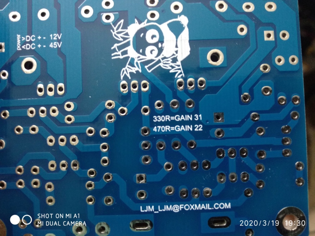

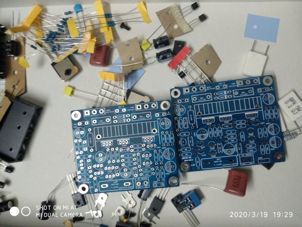

i received this amp kit, i am going to assemble it. Since you already have experience with it, I ask if the values shown on the pcb are correct or should changes be made? the gain is better for it at 31 or 22 .. Thanks
Hi.
All values are correct on pcb.
By default gain is set to 31 with 330R supplied resistor.
For better bass (excellent on that amp) you can increase 16v470uF cap to 1000uF (6.3v should work perfectly) and increase mkp input cap to 10uF.
Have good time assembling it.
Best regards.
