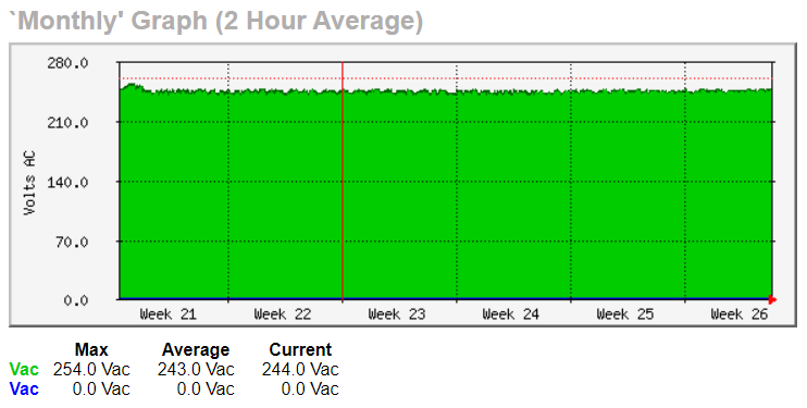

However the fact that my house is reading nearly 260 VAC suggests either a generous home supply or the meter.
Wikipedia claims "nominal supply voltage is 230 V +10%/−6%" = 256 VAC.

I'm in the UK and my mains (monitored via a UPS) has been as high as 255v but seems to average about 243v
So depending on where you are, your mains doesn't seem unusually high.
However if it's always that high I'd raise the issue with your electricity company.
The attached graph is my average mains over a period of a month.
