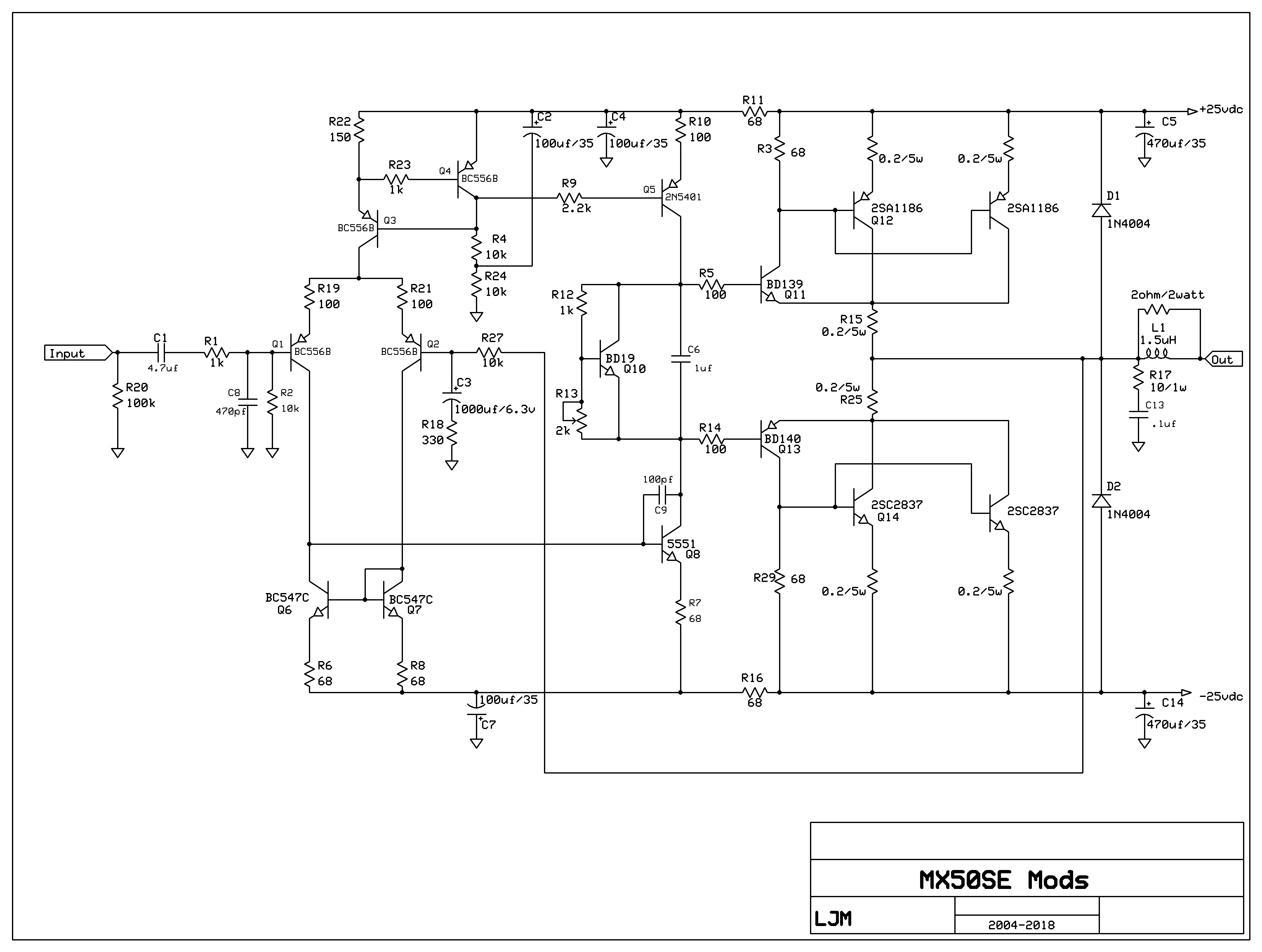

Please see the attached schematic to see how to add emitter resistors for current sharing in a paralleled CFP output. They must be in the emitter of each output.
I was following this thread and schematic...😕
MX50SE LJM 2015
Is this wrong...😕
I know the diodes are facing the wrong way
MX50SE LJM 2015
Is this wrong...😕

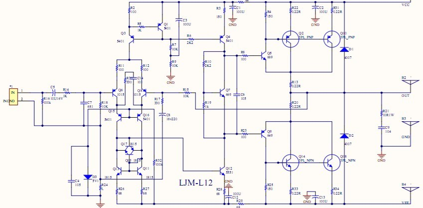

You mean the second schematic in post #4? I understand that the current sharing resistors must be in the emitter. (As they are in the parallel CFP LJM L12-2 and L20.5.) When one transistor conducts more emitter current than the other the voltage across the emitter sharing resistor increases raising the base voltage of that transistor relative to the one that is conducting less current. This opposes the in-balance in current and thus when the current sharing resistor is large enough you will achieve acceptable current sharing.
Consider if one transistor has a lower Vbe (either due to poor matching or due to higher temperature (or both)). That transistor will turn on at a lower Vbe and will draw more current than the other transistor at the same Vbe. That higher current will produce a higher voltage drop across the current sharing resistor which acts to raise the base voltage of that transistor and promote more equal current sharing.
And yes, the diodes are in backwards in that schematic.
Yes that one... I see that the emitters are going straight to rail voltage?
And the 68 ohm res is connecting collector from Q10 and Q11 to the emitters of Q12-Q15? Not between rail and emitters😕
So the collectors share one .2 ohm on each side but I see you put a .2 ohm on the emitters before they touch the rail voltage correct?
The 68 Ohm resistors will need to go to the rails and the emitter sharing resistors will need to go between the emitters and the rails.

Yes. That is how it is done on the L12-2 and L20.5 and it works properly. Follow the L12-2 schematic as that is actually quite close to a MX50SE modified to have two CFP pairs.

Well this seems like a fun to do mod... Will it be ok the use the 47 ohm base to emitter resistors? And should I use .2 ohm 5 watt on the emitter side to rails voltage?

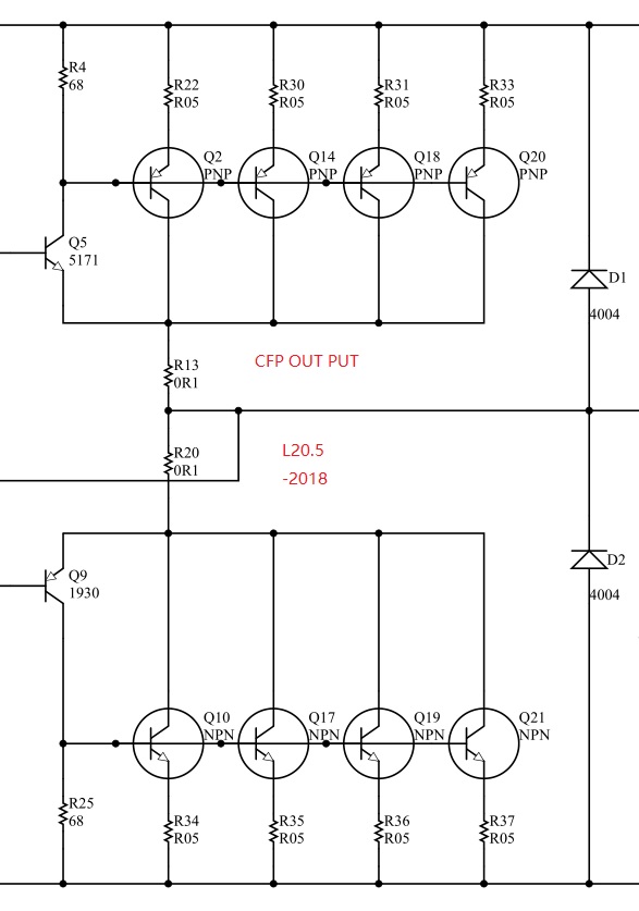

On the LJM 20.5 he uses 0.05 there. I used 0.12 (all I had) when I paralleled four CFP pairs.
So I would use 0.1 if you have it. If you don't then 0.2 will not cause a problem.
I wonder what the dependence (of distortion) is on emitter sharing resistor values on paralleled CFP outputs? Can anyone else comment and shed light on that?
I think so at your rail voltages. I have seen 150 Ohms in LJM's L12-2 schematic, 68 Ohms in L20.5 and 47 Ohms in my MX50SE. Larger values reduce the dissipation in the drivers and I believe I have read recommendations to do that on the MX50SE. But right now I can not recall the particular posts to reference.
