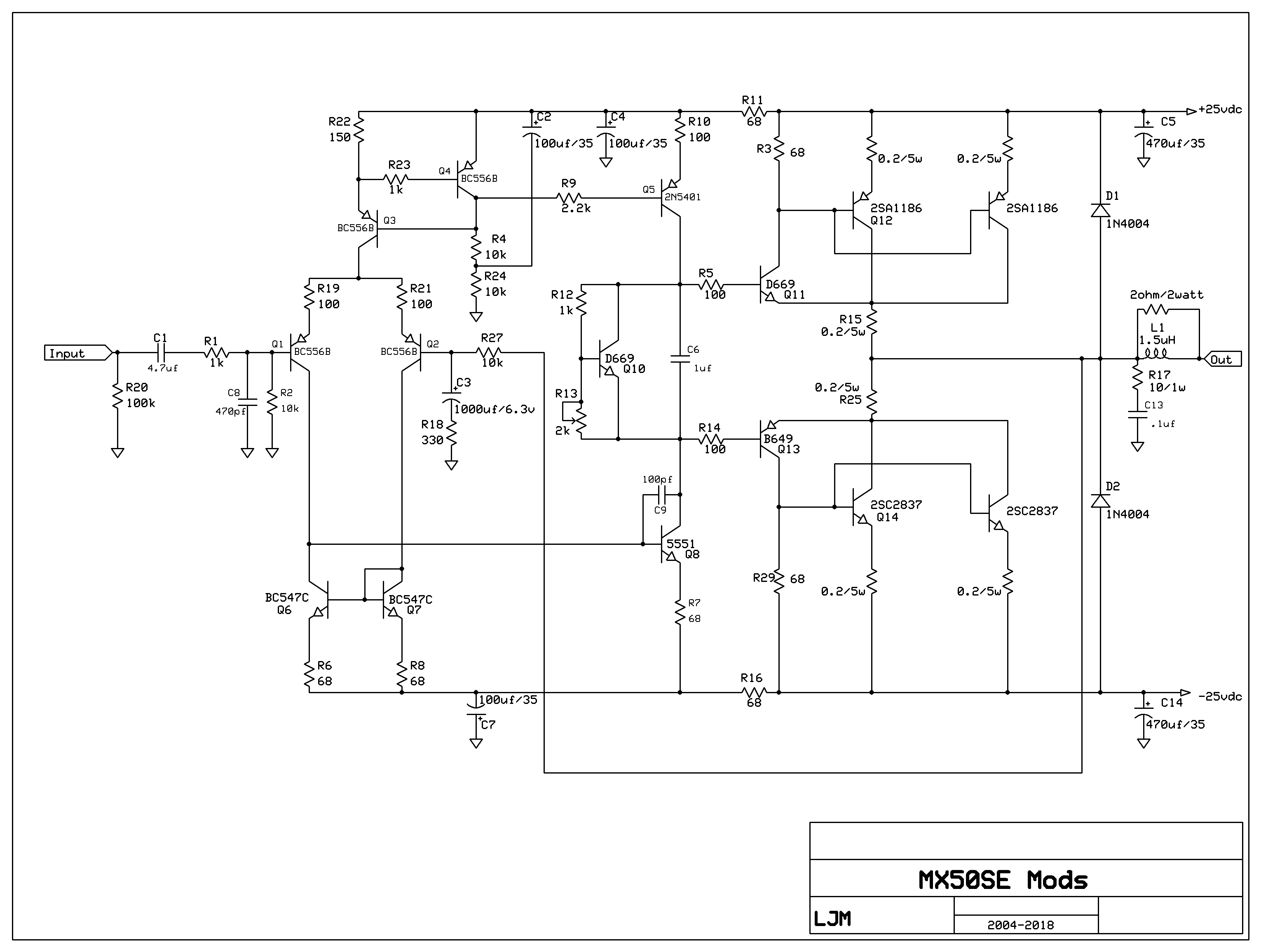

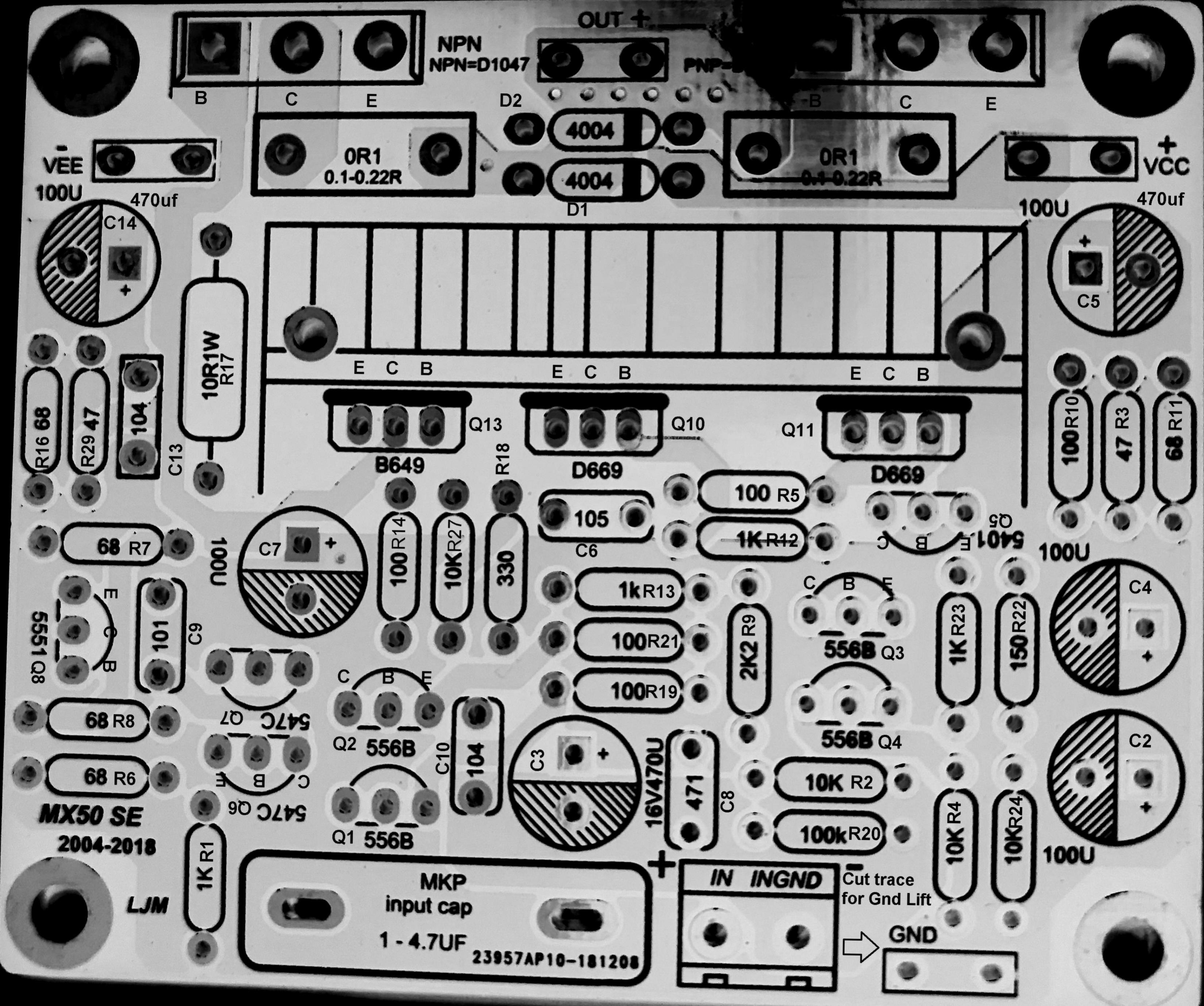

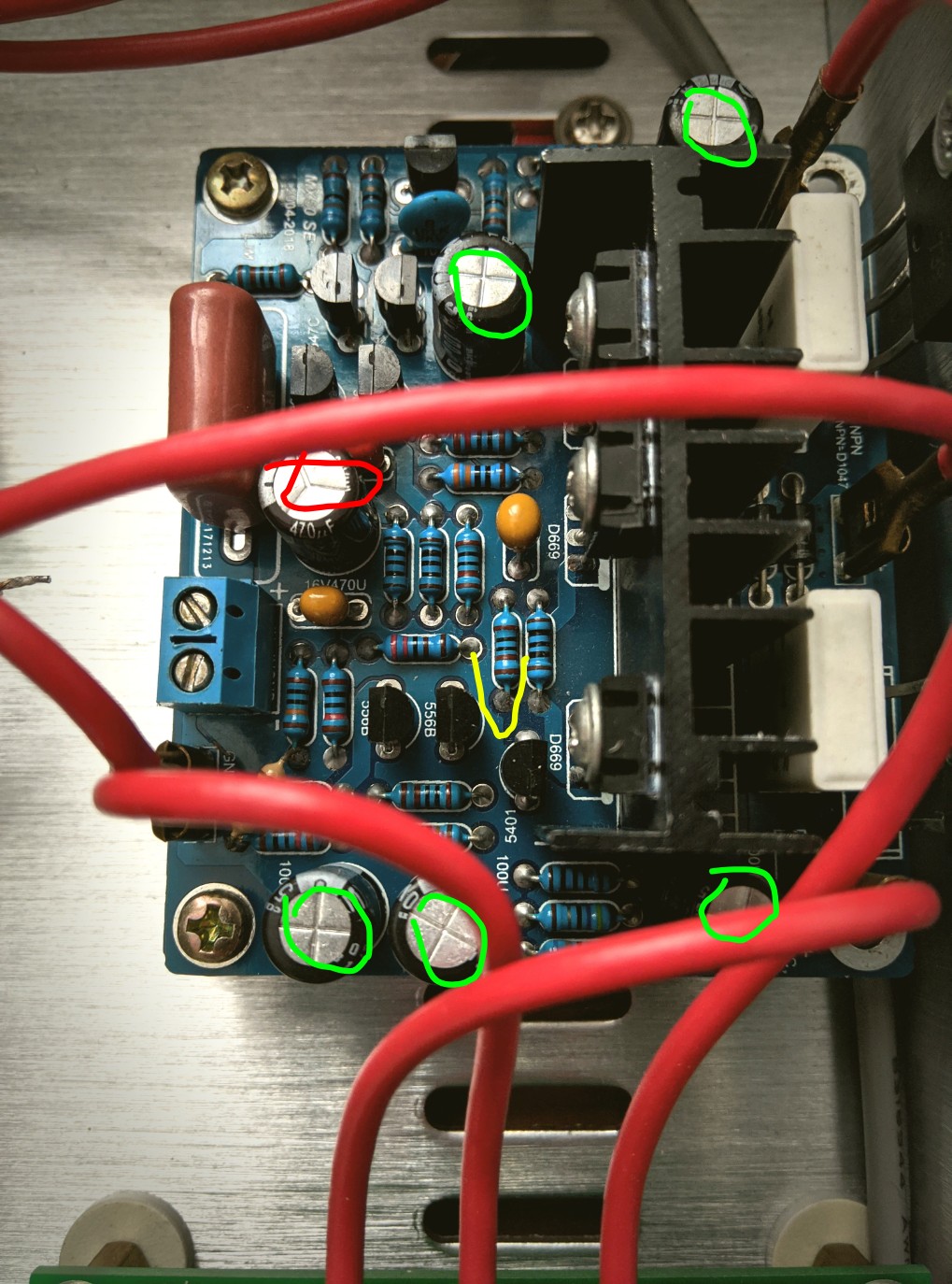

Hello. I measured the quiescent current on my amplifier, something very small. Only 6-6. 5 mV. Input voltage per us, +-30 V. Does the quiescent current depend on the power supply voltage of the amplifier?
Specify, instead of this resistor (highlighted in yellow) to put a tuning one? And, here is this capacitor (highlighted in red) at 470 uf which, you need to increase to 1000 UF? What does it affect? And also, the remaining electrolytes per 100 uf (highlighted in green), is their increase necessary or not?

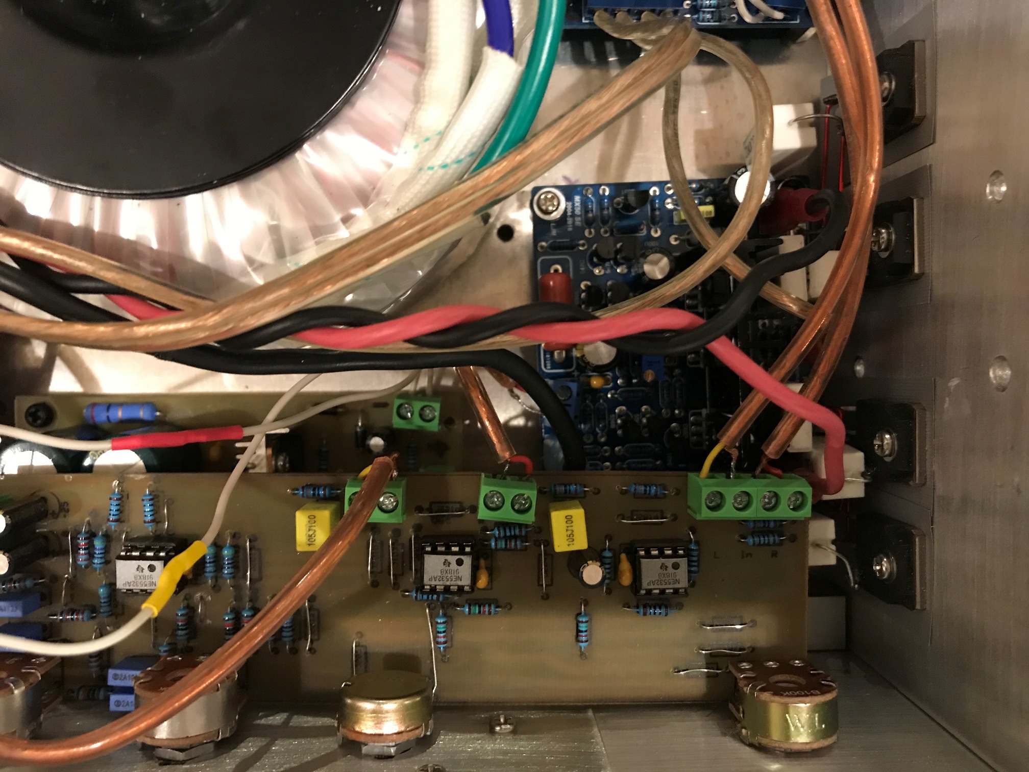

Hello... So I Installed a multi turn 2k pot in R-13 spot, the res you highlighted in yellow is R-12, should be R-13. I set mine to 6mv across the collectors, or you could clip on the the Emitters of Q-11 and 13. I replace C3 with a 1000uf/6.3v cap, did not harm anything. I think someone said it gives it a little more bass response. C-5 and C-14 I increased to 470uf/35v. My power supply is 18-0-18 so +-25 about. I lowered the voltage value of the cap's so they'd be at about 80% capacity, I left C-2,4,7 at 100uf/35v, and for C-5 and 14 a 470uf/50v cap wouldn't fit. The 35v is a smaller can size and fit no problem. I did double the final out put transistor's, PITA by the way, but it works perfect, does not get warm and is VERY powerful!!!
Thanks...I'm not using that pre-amp shown, did not like it... I'm waiting for R.E. Project 97...should be here any day now. The sensitivity of these amps is almost too much. I may bring it down in half.
As far as I'm going with it...

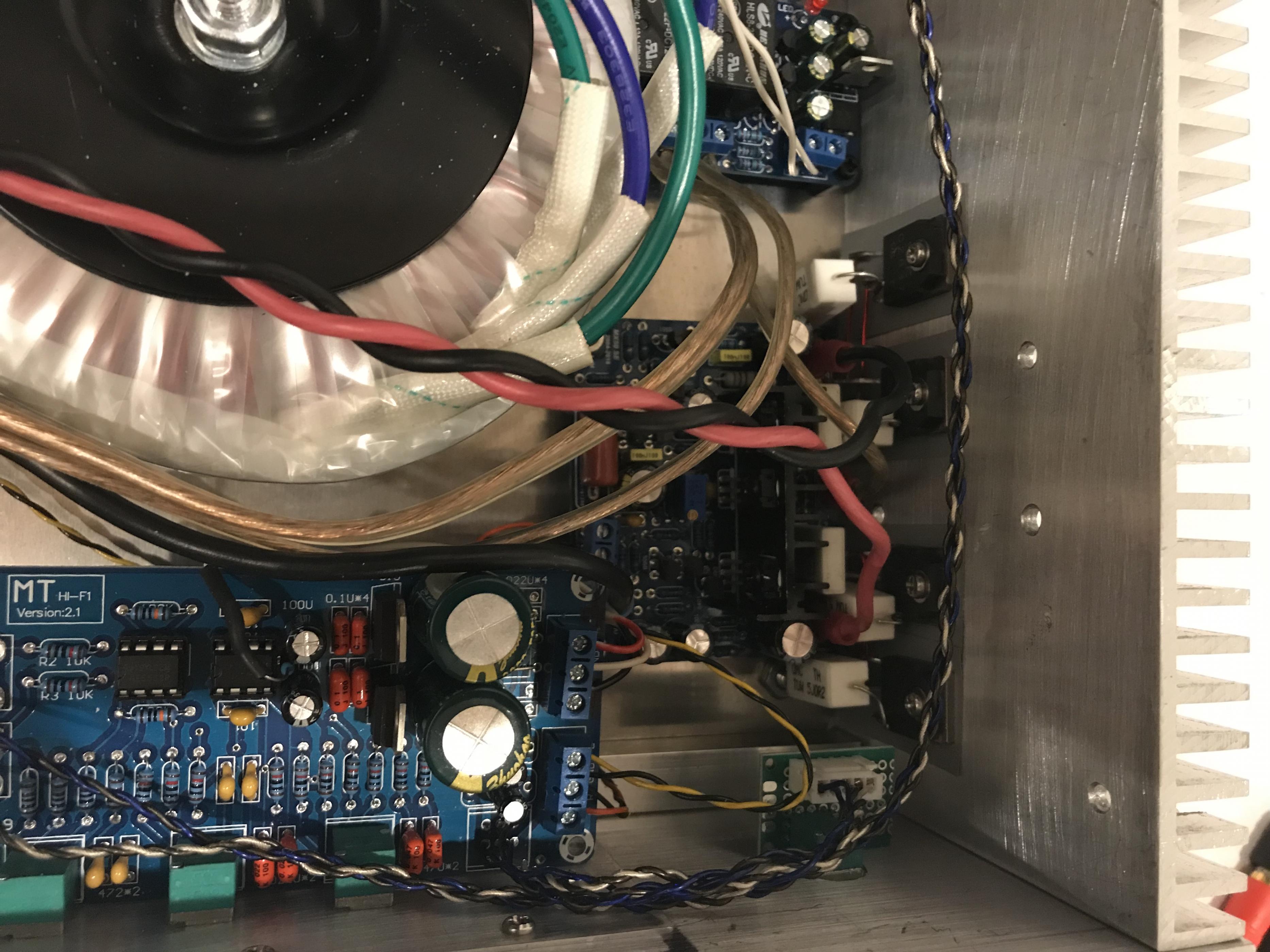

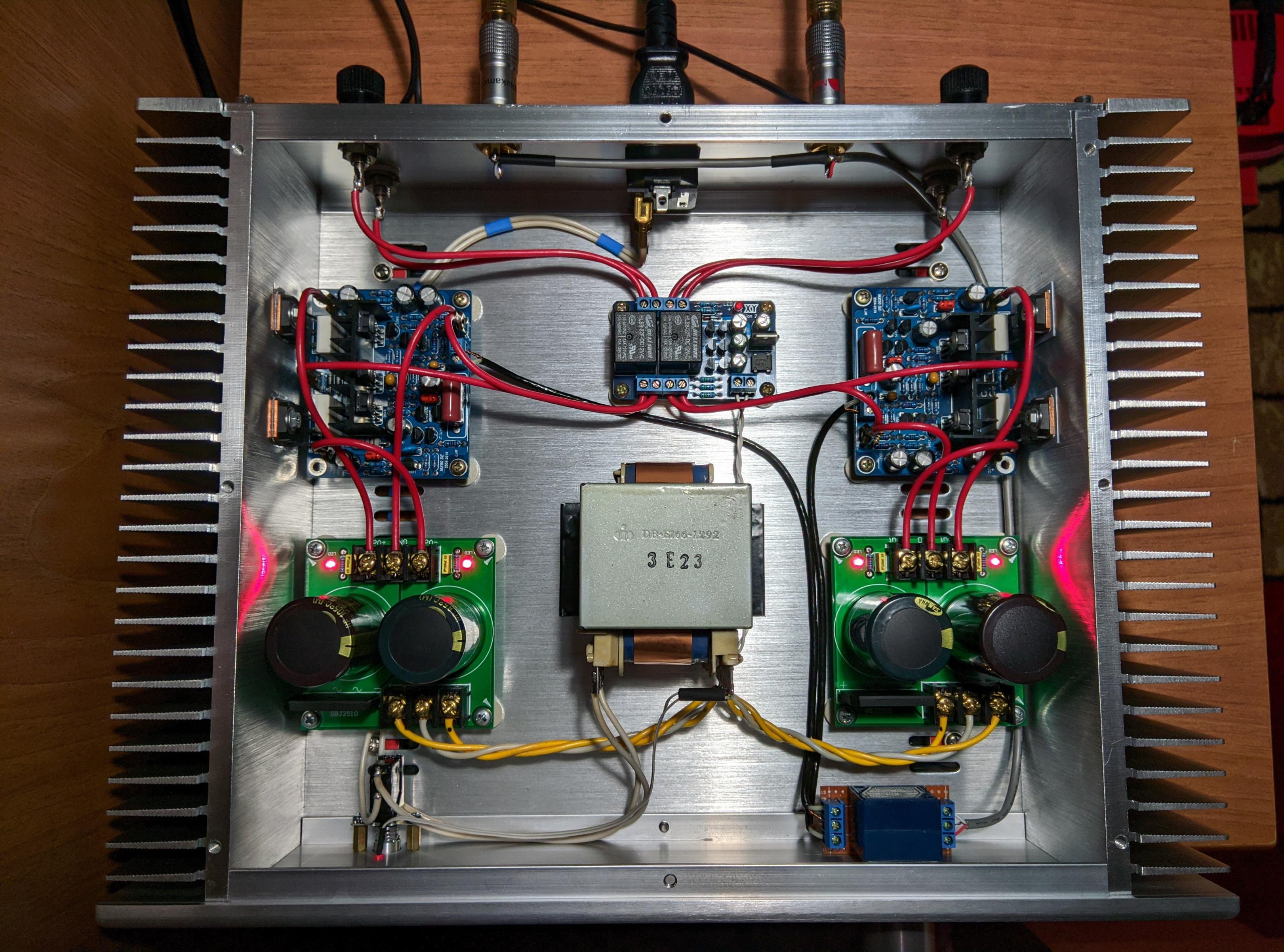

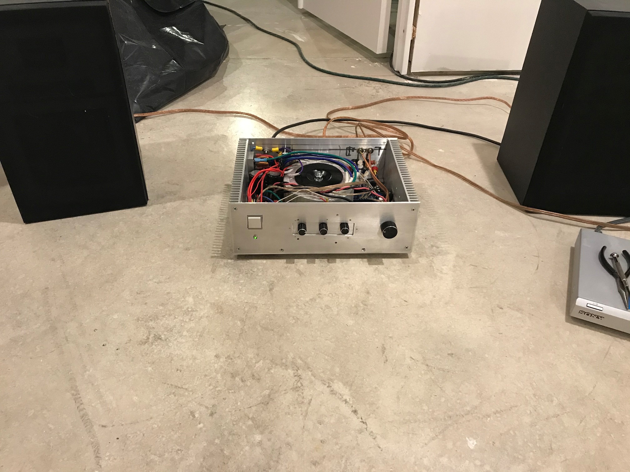

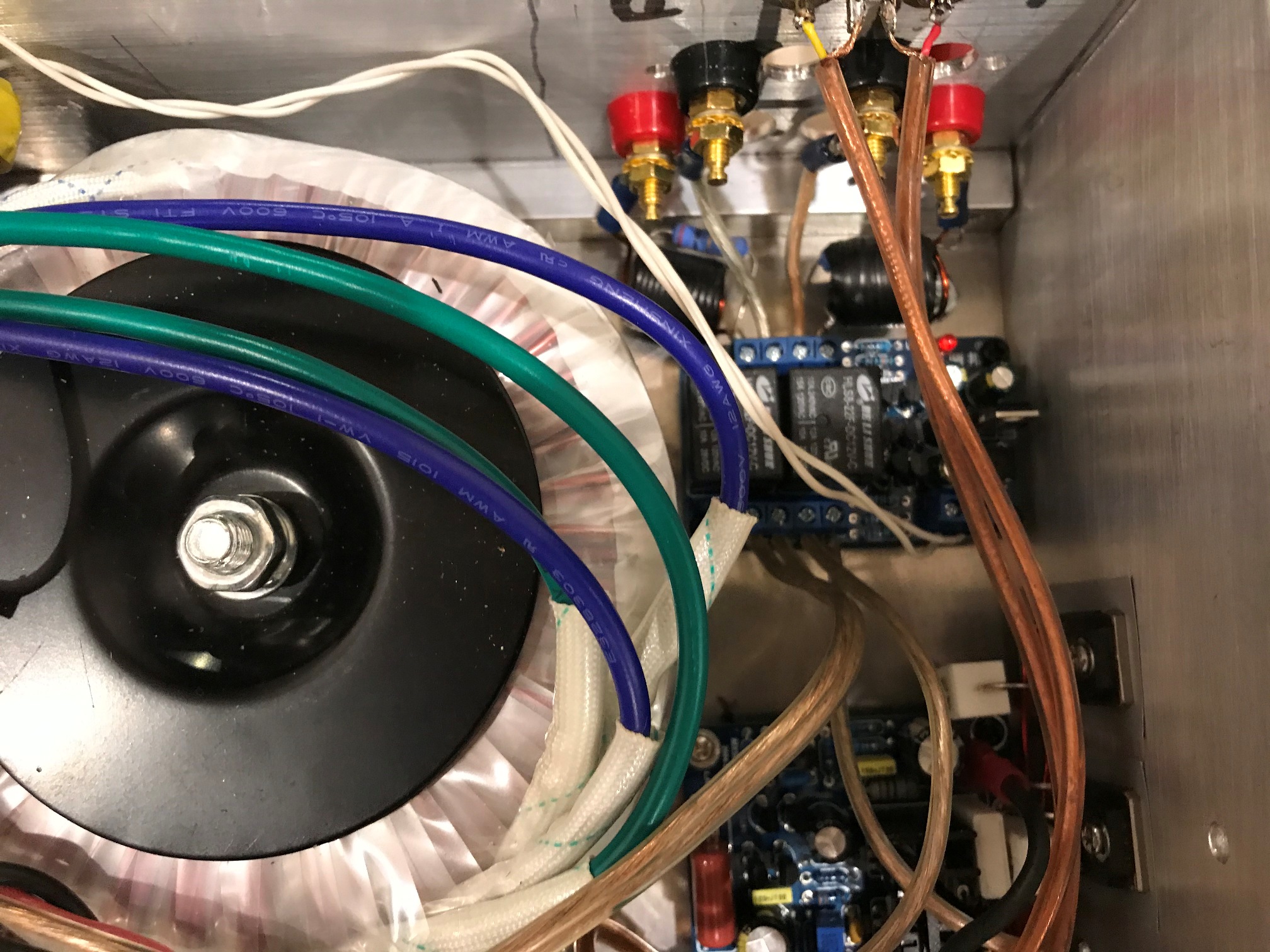

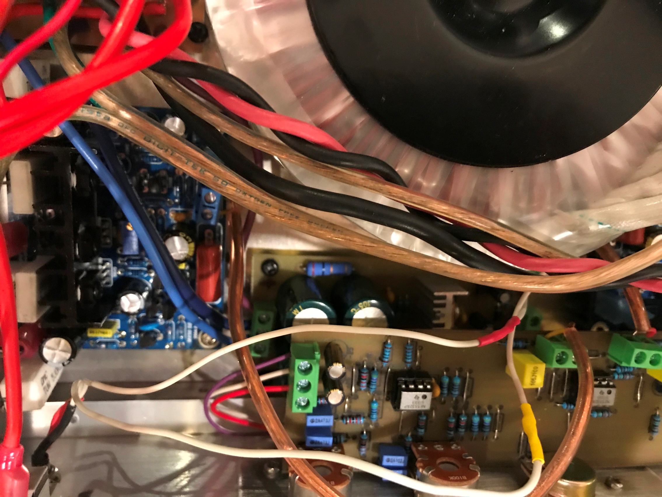

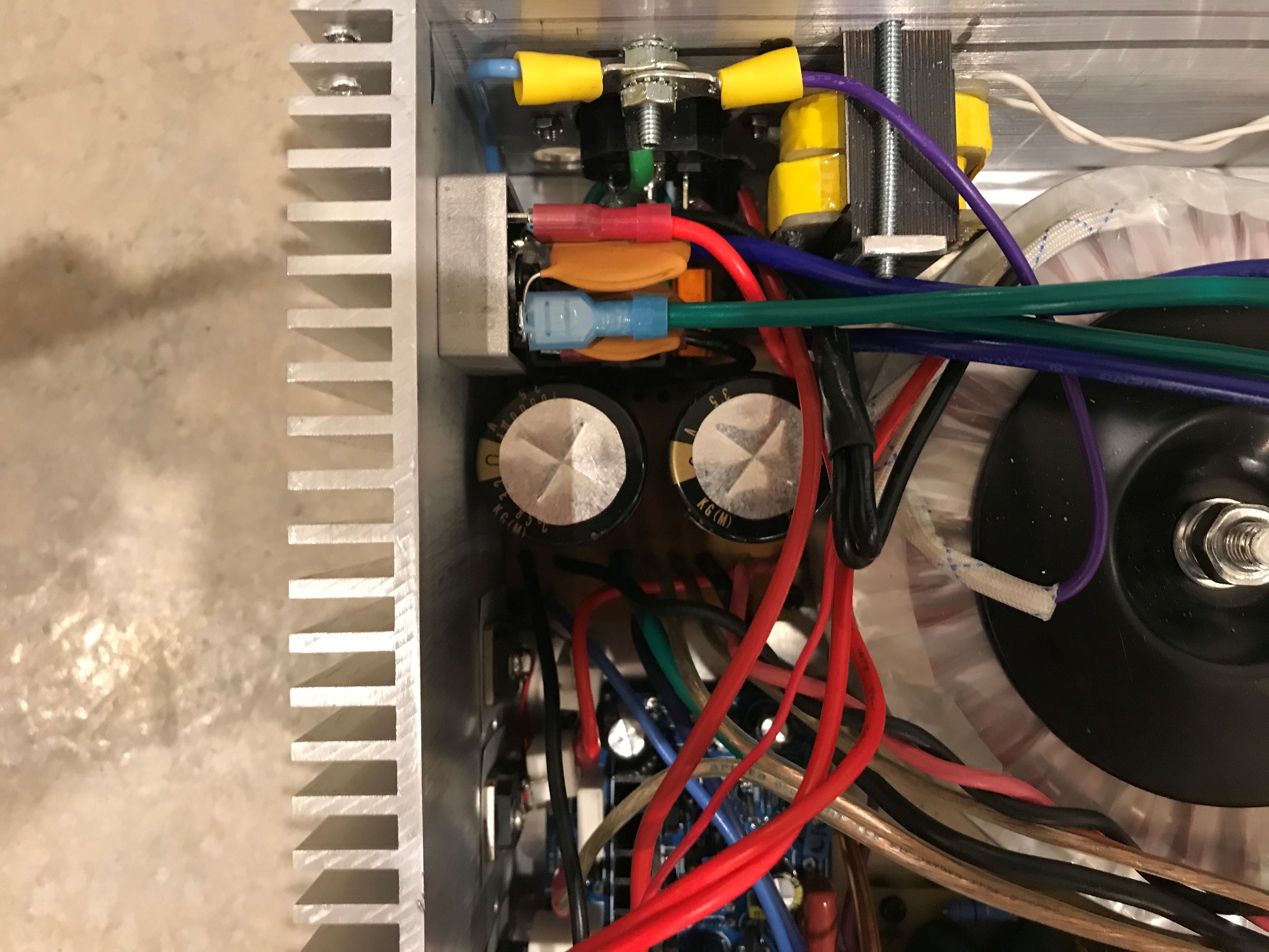

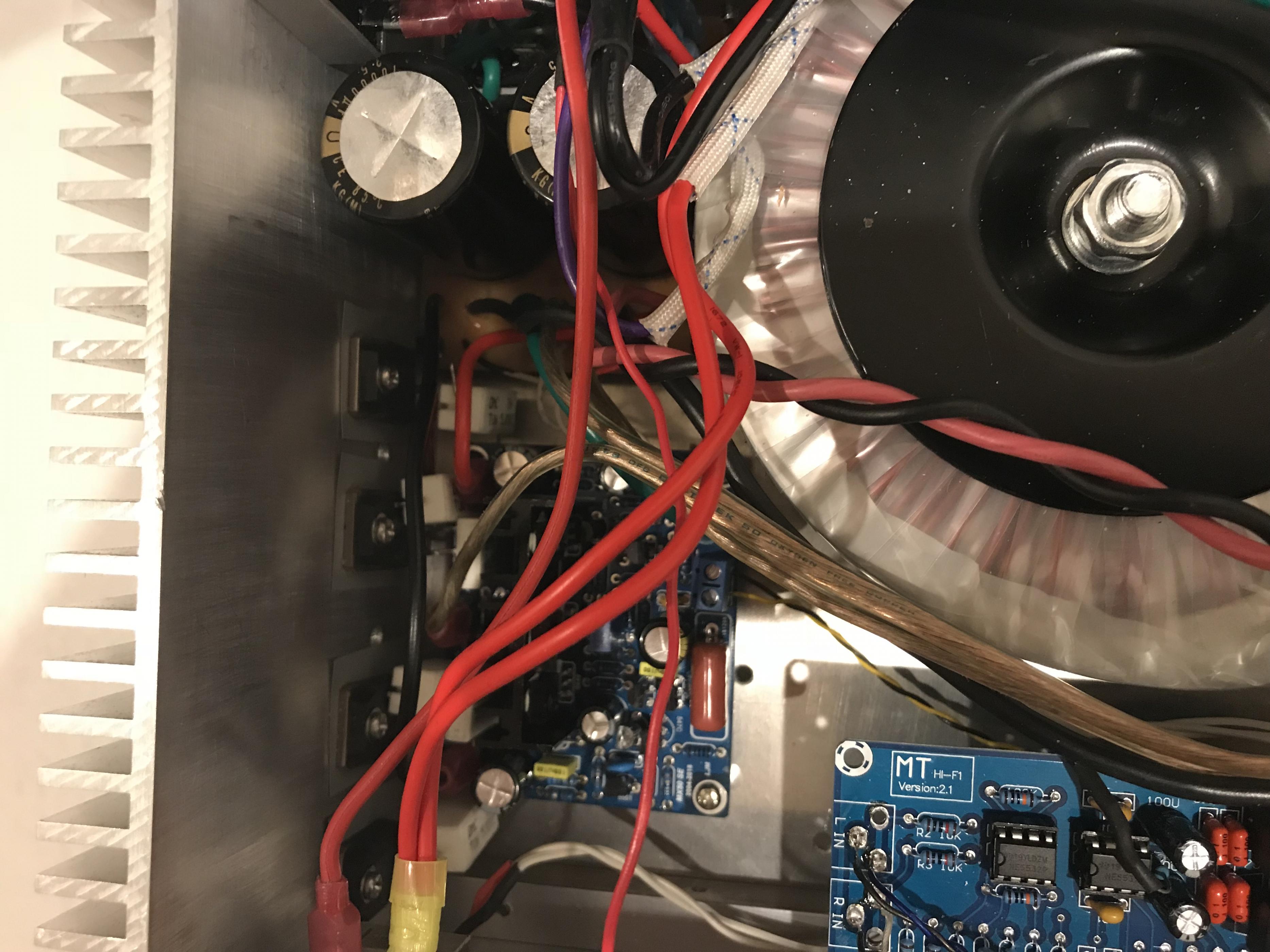

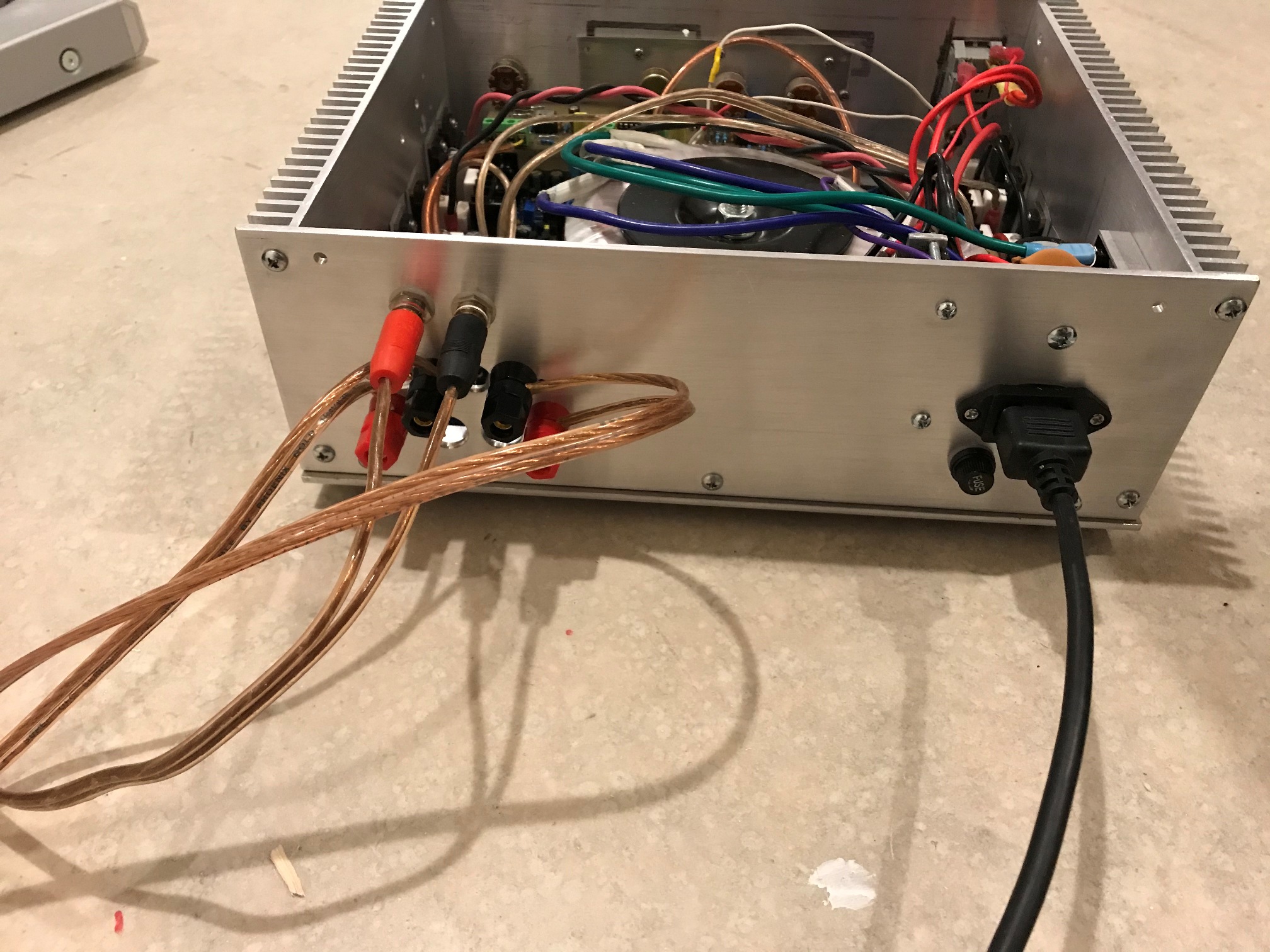

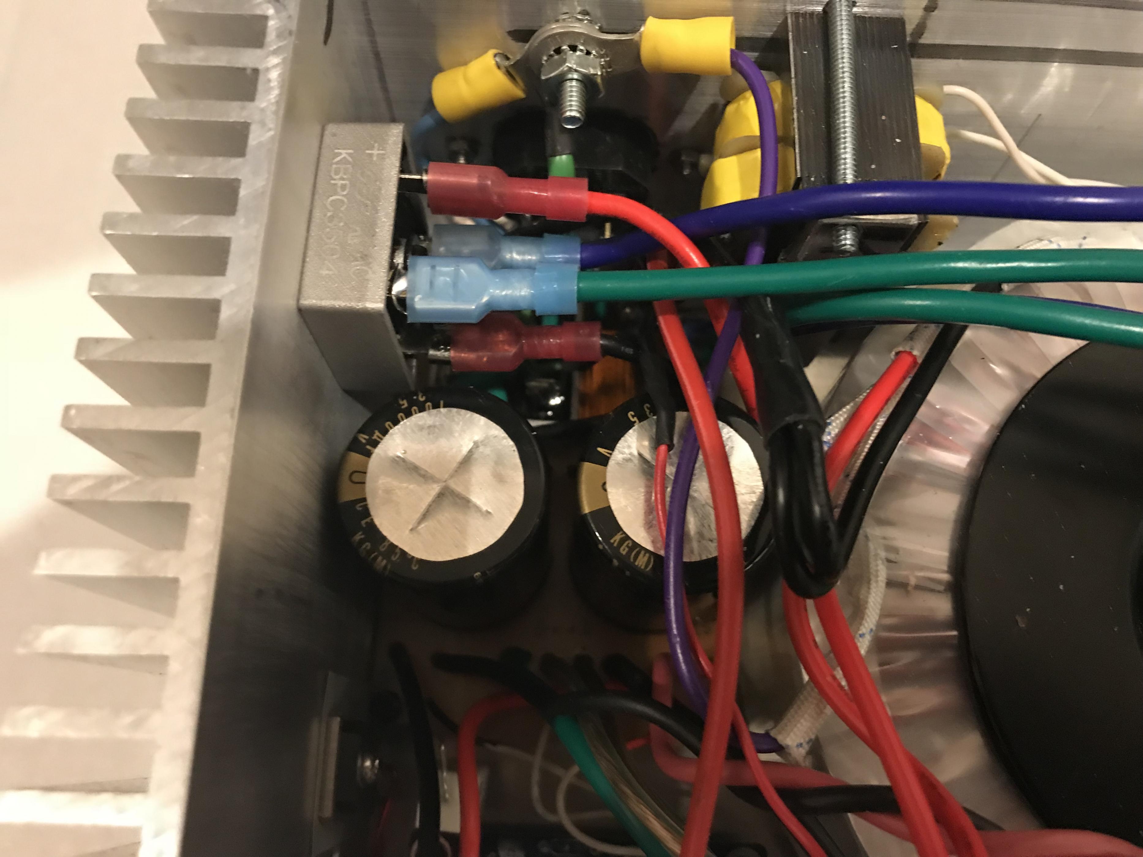

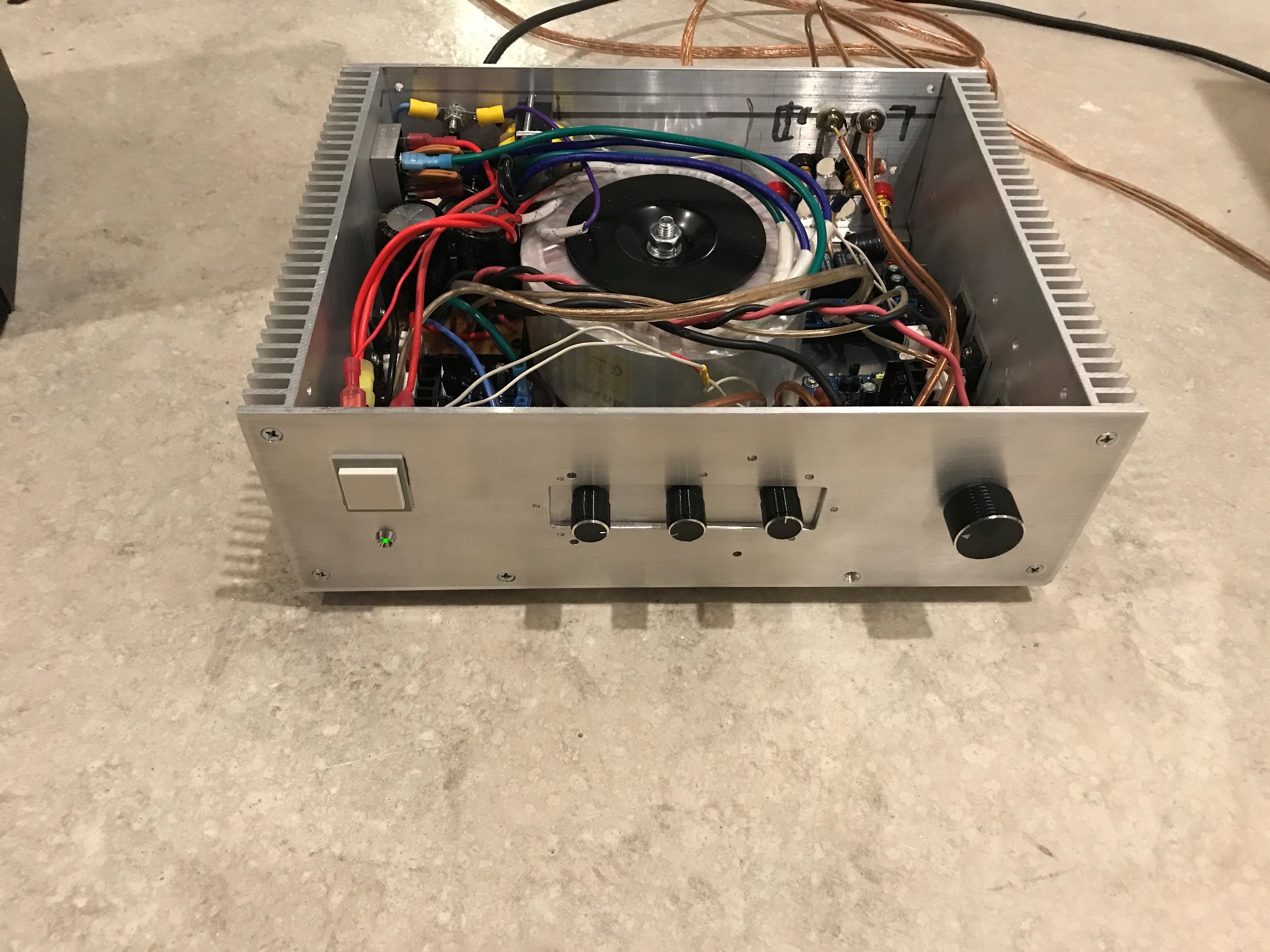

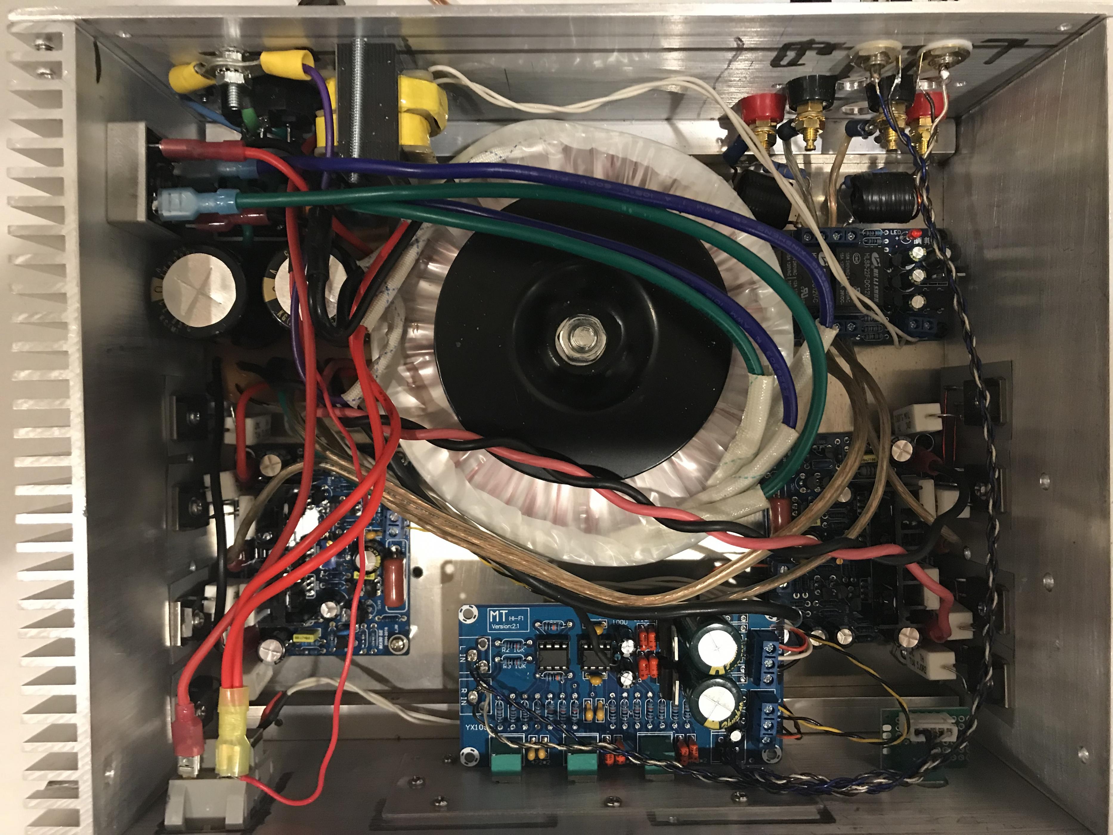

I know, I know, the chassis is very small. Originally I was building a 2.1 system but it didn't work out so well. So I decided to cram all this stuff into this chassis I already built
It does work very well though. No hiss or hum, stays cold and plays plenty loud!
I need to look at the bias though as I think it needs more than 7mv, I do have double the outputs. I am using 18-0-18 300va and a pair of 10000uf 35v for filtering. I'm then feeding +-25 vdc to a regulator board to drop it to +-15 for the preamp.
Fun project and the next one will have a Larger Chassis with analog VU meters!
Thanks for all the info, mods and advice on this kit. 😎

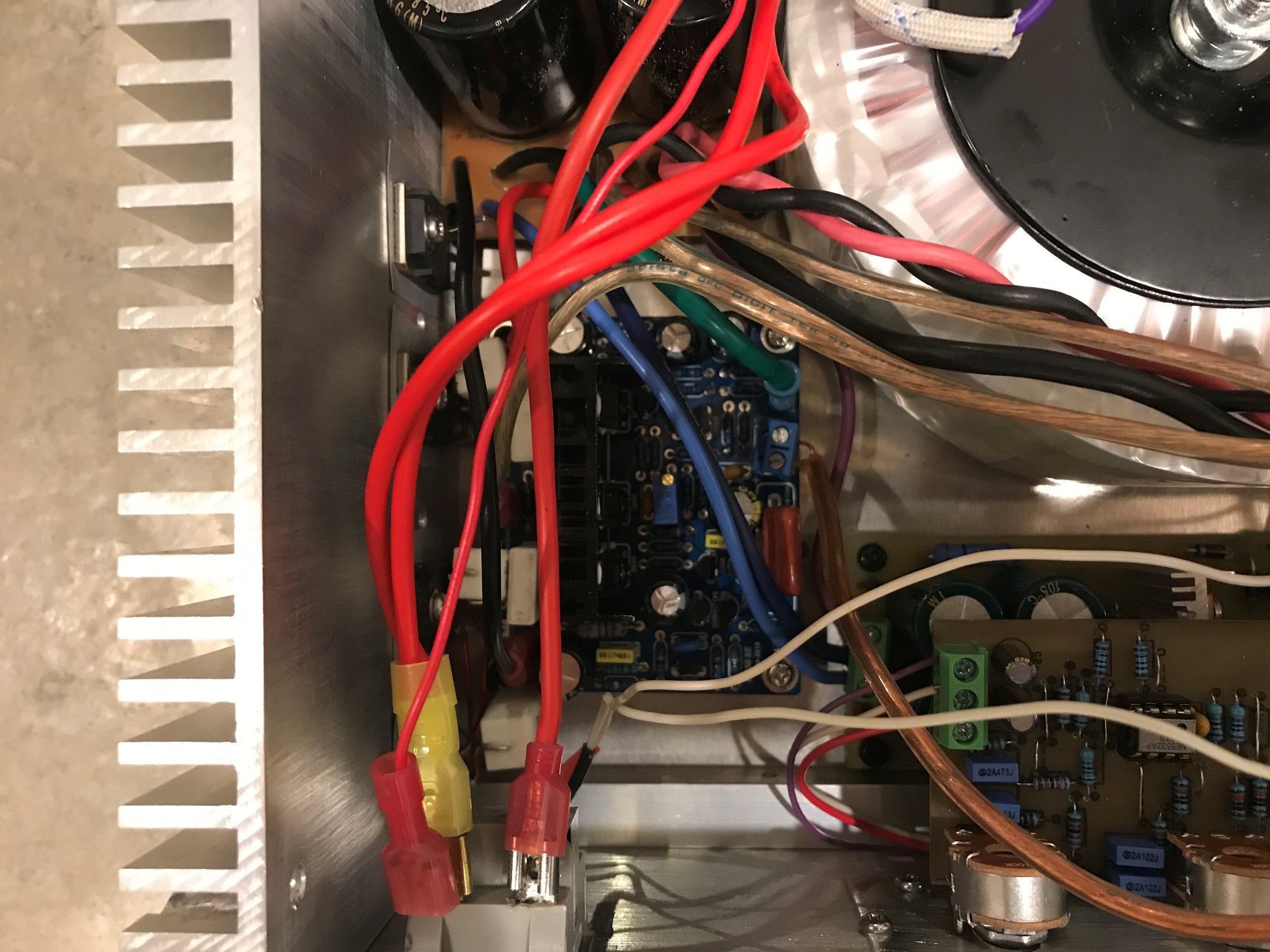

All... I originally set the bias for 7mv and it sounded a little bad...distorted so I set bias for 14mv and it's night and day sound difference. Maybe because I've double the outputs is the reason for a higher bias voltage needed. I've had it playing at a decent volume for an hour or so and it just gets luke warm.
DC offset... Left channel=0.008, Right channel=0.000
With 1000hz input tone and output into an 8ohm dummy load, it clips at around 15.5 vrms. Not much power when you do the math. I think with a higher voltage transformer this would increase. All in All the sound Q is great.
Now to build an L20SE set. This will have +-43 vdc.
