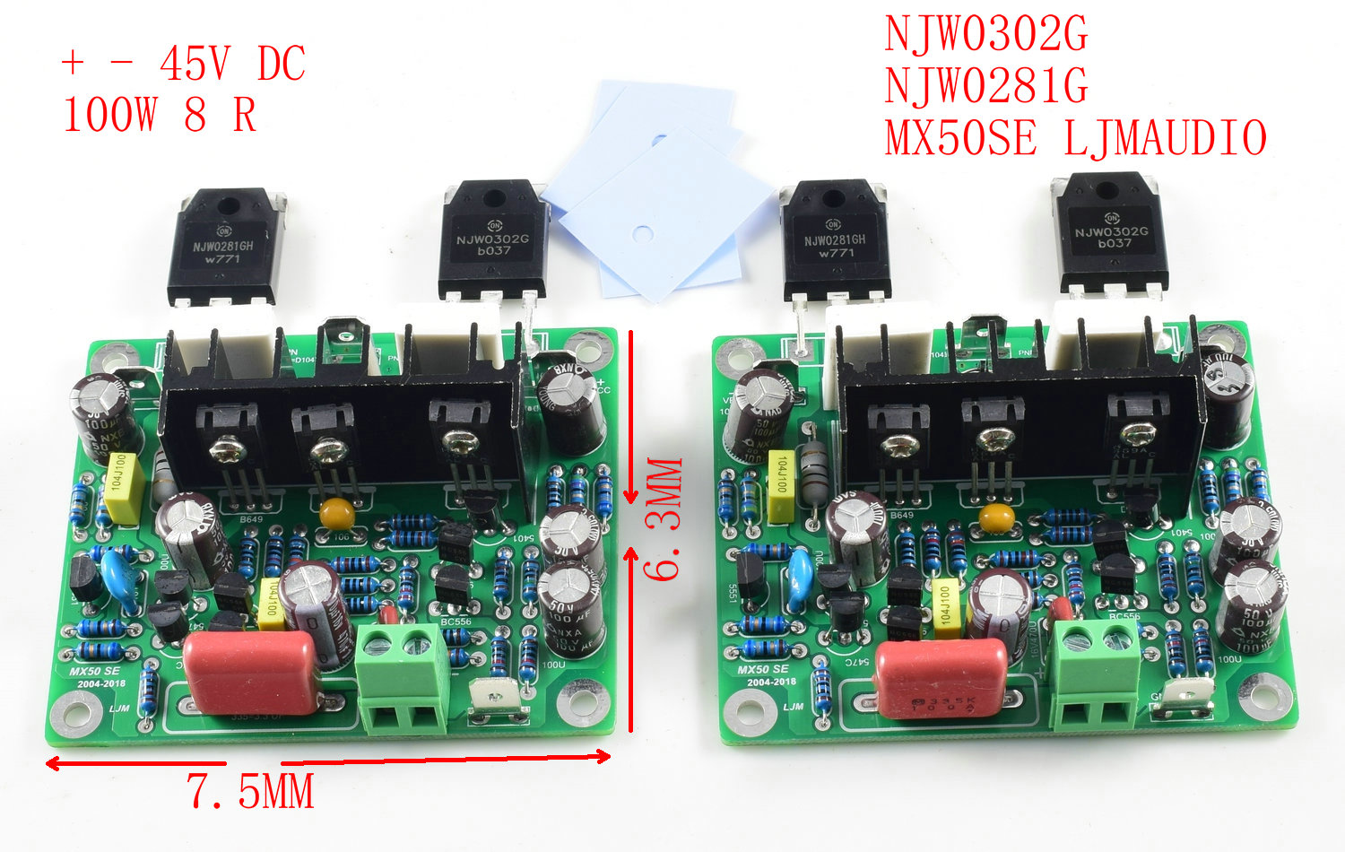

Hello, I am about to buy LJM kit for MX50 SE from aliexpress;
I would choose the sanken version with 2SC3264/2SA1295 provided,
but I have some questions that hold me back from proceeding
is there any chance to receive fake sanken ?
is there really audible differences with Kec B817/D1047 ?
with power supply +- 34V, would I achieve 80W RMS on 8 ohm ?

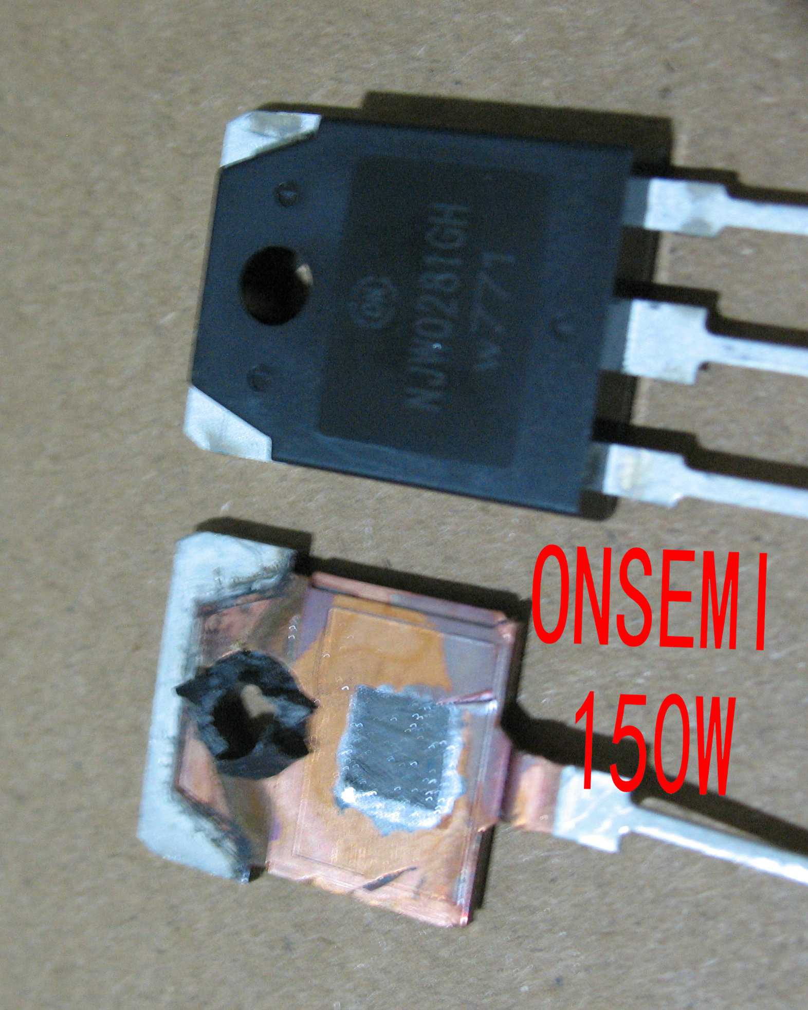

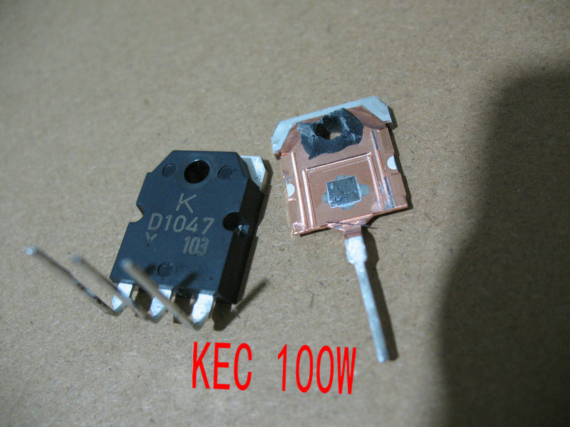

You can rest assured. I'm very professional. I can tell the truth. Or fake Sanken.
Whether it's KEC 817 1047 or 2sa1295 2sc3264.
They have basically the same effect.
I can guarantee that they are all real transistors.
If you have extra transistors. You can break it with a hammer.
You can see the size of the chip with a magnifying glass. The original power tube may be produced in different places. Like the Philippines, Mexico, or China. It may not look the same.
But. It must have the same chip. The same size represents enough power.
In addition. You can also use the ONSEMI version of njw0302g.
They sell for the same price. I'm also worried about fake transistors.
So I need to take measurements. Use a transistor tester. In addition. I'll sample and break it.

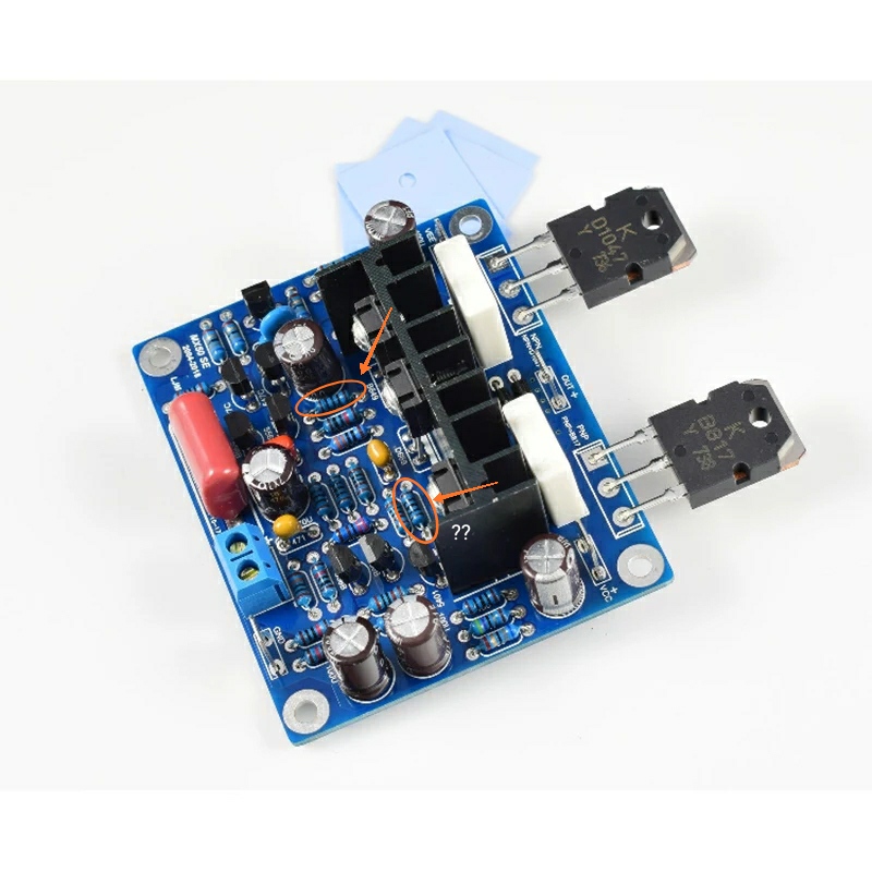

Hi Folks. I bought 2 MX50 SE on ebay and neither of them worked. Maybe some others will have the same problem; it's a tricky one to solve.
This version has a 5551 transistor as Q12 and no Q14.
Problem is Q12 silk screen is marked e b c but should be e c b.
You can twist the transistor legs to make it fit.
The symptom is that the output is stuck at the negative rail, Good luck!

Perhaps first look at the D1047 & B817 BE & BC junctions with a meter. Then perhaps remove any failed outputs and then probe the B649 and D669 BE & BC junctions with a meter. Next probe the 5401 and NCC5551 (not standard pinout). (Q4 & Q12.)
Are the 47 Ohm resistors ok? What about the 0.22 Ohm resistors?
What was the supply voltage? What is the actual measured impedance of the speakers? (I ask since my "8 Ohm Compatible" speakers measure as 4 Ohms.)
I also suggest that you DO NOT get B649, D669, D1047 and B817 replacements from eBay or AliExpress.

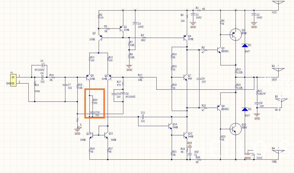

Pleas give a shematic showing transistors Q12, Q14,...etc...Hi Folks. I bought 2 MX50 SE on ebay and neither of them worked. Maybe some others will have the same problem; it's a tricky one to solve.
Thanks,
For study purposes, and to express opinion, publishing the scheme available in electronics stores Ebay. Warning do not encourage copying and be respectful of intellectual property of the device.
Is the shematic good?😕
