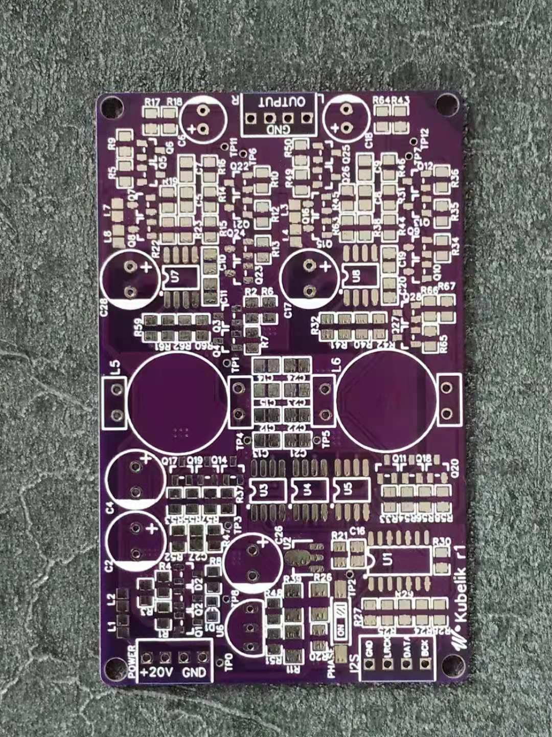

r1 PCBs have arrived
JLCPCB is doing sterling service these days, turning round PCBs in a week for next to no money (1RMB each, including shipping). And I hear they even have a free offer which includes boards up to 4 layers. So we might just do our first 4 layer board if we can think of a design that calls for it.
r1 now has more test points for easier kit building and one of the TL431s has gone over to TO-92 as I already have a bag of TI ones. Getting SOT-89 style TL431s of known provenance is a little bit tricky on Taobao and the noise does vary rather a lot between vendors.

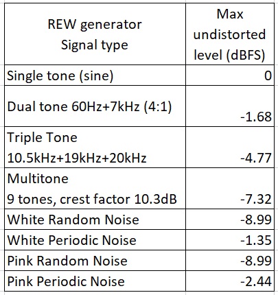

Incidentally I've done the inter-sample overs experiment and Kubelik put out an unclipped waveform of Audacity-generated white noise created at a level of 0.999. It calls for about 4dB of headroom - meaning the white noise peaks are almost 60% higher(lower) than the peaks of a full-level sinewave.
From a test I've done.

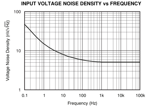

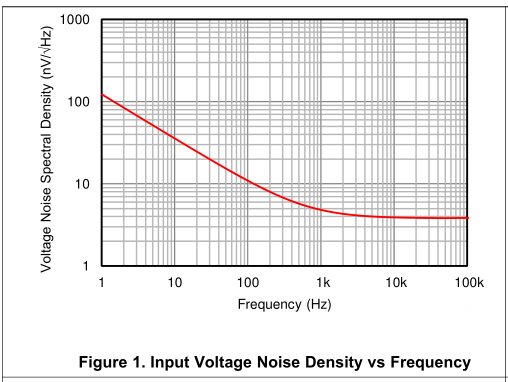

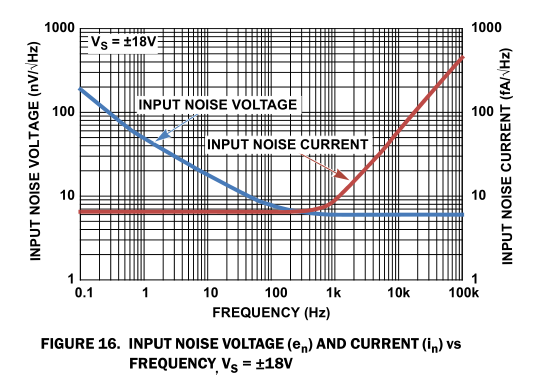

I've built up six prototypes of Kubelik now, in various configurations mostly varying the opamps (OPA1678, OPA1642 and ISL28210) and the numbers of DAC chips (3,6 and 12).
A couple of fairly firm conclusions - 3 DAC chips isn't quite enough and the OPA1678 doesn't quite cut the mustard in the bass. So - while its eminently an affordable part I shan't be using it. Kubelik will use either the OPA1642 or the ISL28210 both of which have lower noise in the LF region. Incidentally the plot for ISL28210 gets better in the LF at lower supply voltages.

George - what was your test result done on?
