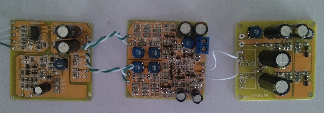

Here's the current state of the hardware implementing this :
Each board is mono but balanced - the TxDACs, which are hiding under the filter plug-in - all have balanced outs. Here I'm using two with outputs paralleled and the inputs separated. The blue daughter board at the front has the MCU on it which is the customary ARM Cortex M4, nicely fitted out with DSP optimizations. The rotary hex switch is used to tell the software which channel to output.
