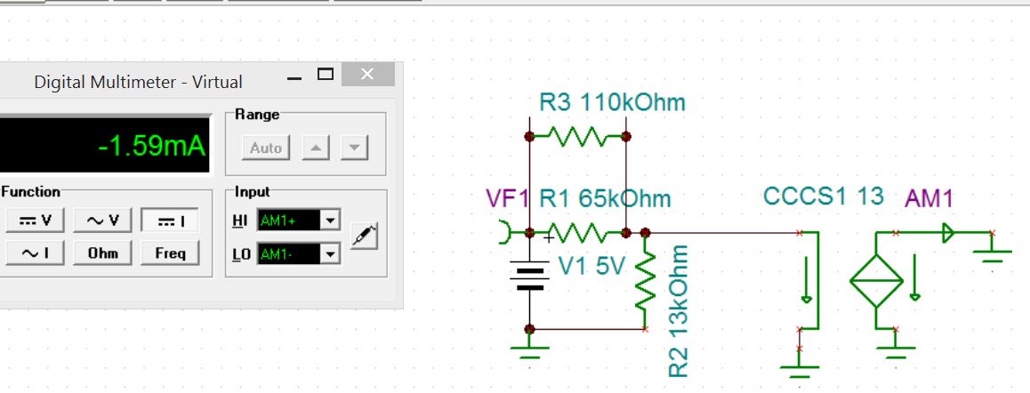

I want to consult you about biasing the TDA1387.
The TDA1545 is very similar, the DS says if you bias 2ma instead of1ma they Ifs, the -60db THD+N falls to 1.4% from 1.7%.
The TDA1387 has also the same 11k in Iref input with Vref of 1/6Vcc. If I sink the current to devide 1ma Ifs, I get 13.2 which is exactly the Afs of TDA1545. I conclude that if I ground the Vref pin with another 11k, I will get 2ma Ifs= I bias on TDA1387 and maybe 1.4%.
The question is, with Ifs doubled, did I also doubled the gain to 2ma p-p output?
Thank you for info.
I simulated the pin 7 to match the impedance 11k as the DS says and your experience with 110k. I get 1.59m.

This is the good one. It is identical to 1545, the 22k+33k are inside. The Iref is the current through the 11k. But the Rref is not 11k as the DS says. Or else your 110k added will give 1.75ma or 1.7ma if the pull up resistor is a CCS.
What I found in my experiments was the Iout didn't increase linearly with pin7 voltage. As you keep on increasing the pin7 volts, the Iout doesn't increase in proportion. So you end up needing a higher pin7 voltage than you would if it was a linear relationship.
I don't think Philips troubled themselves to make the Iref generator much different. From the figure 1 of TDA1545, the voltage across the Rref is already 1/6Vdd. As they could bring the compliance to 0, the Vref was needless so as the outside resistors.
If the 1545 can out 2ma Ifs with 22k from Vdd, I don't see why the 1387 can't. In your case that would be too much heat because multiple// but I am investigating to use only one pair loading each positive and negative of each channel in the same chip for differential output.
The minimum possible THD+N at -60db is -42db, with 0.14% only 4db is away from best.
Heat certainly was a problem with biassing up the 1387s to higher current, I swapped to 1545 as it was a more efficient (slightly lower power, fewer chips) way to achieve the same output current. I'd be interested to hear how you get on coaxing your 1387s to reach 2mA.
