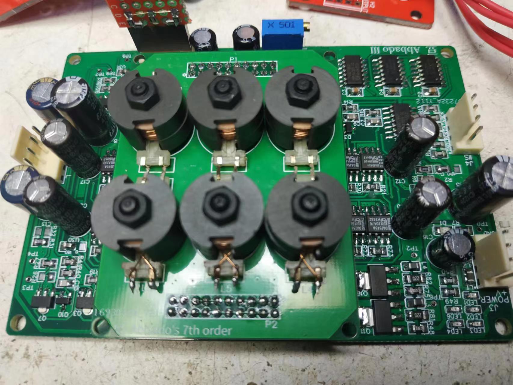

As a result of focussing on complete systems for the past two months or so, there's now a new DAC (which I'm calling Abbado III out of sheer laziness) based on Abbado II but which incorporates a volume control and hence obviates the need for a preamp in a digital-only system. Just one of these new DACs followed by a poweramp is all that's required. I've wanted to incorporate a low-noise volume control in a DAC for quite some time but couldn't see an elegant way to accomplish that.
The latest DAC places the pot directly in parallel with the I/V resistor - this can only work well when the I/V resistor's a much lower value than the pot itself due to the fact that the I/V resistor is also the LC filter termination and needs to be a precise value. Pot resistance tolerances aren't tight enough to use a pot's track directly as I/V so the pot needs shunting with a much lower value fixed R to swamp its imprecise value and this can only be done when there's lots of DAC output current available. It can't work on 1-2mA output DACs (e.g. PCM56s) but an array of paralleled TDA1545As delivering 50mA total current works a treat as this allows an I/V resistor in the region of 100R and a 5k pot's tolerance doesn't much affect that when placed in parallel.
Here's the first generation Abbado III which I initially equipped with a 7th order plug-in filter :
The connection to the volume pot is top left, occupied by a sliver of perf-board in this shot. The biggest surprise on listening to this DAC was the improvement found from upgrading the 7th order filter to 9th order. Both wifey (who listened blind) and myself agreed that it made the music easier to understand and follow - the noisefloor is subjectively lower on the higher order one.
