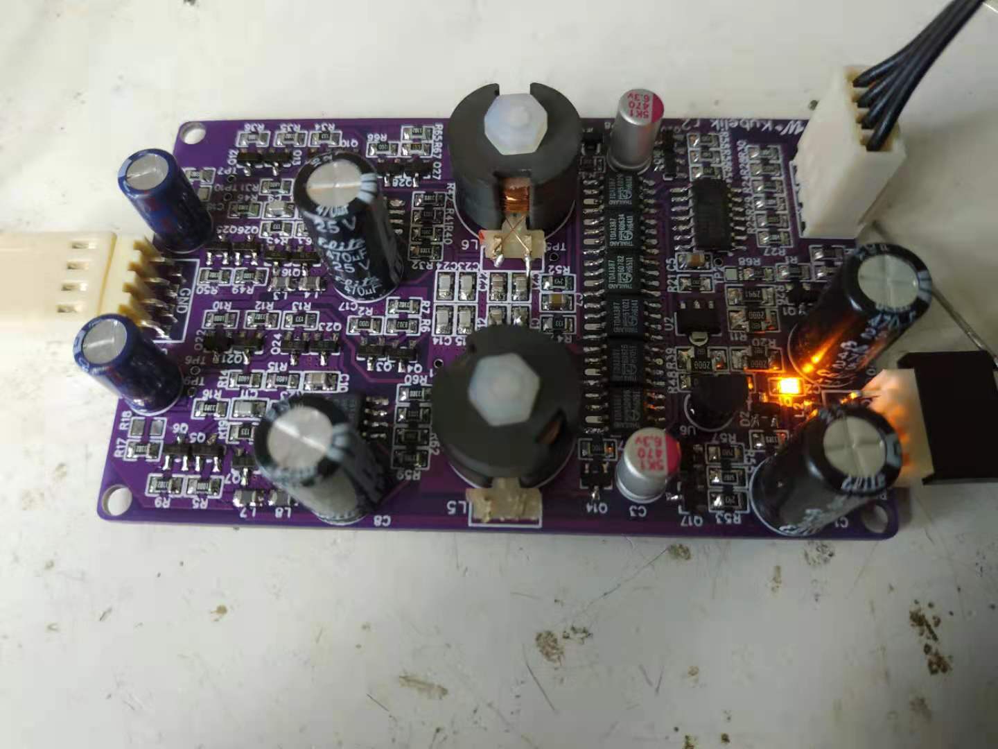

r2 PCB successfully sings
First r2 PCB built up and playing music. Beautifully if I may add 🙂

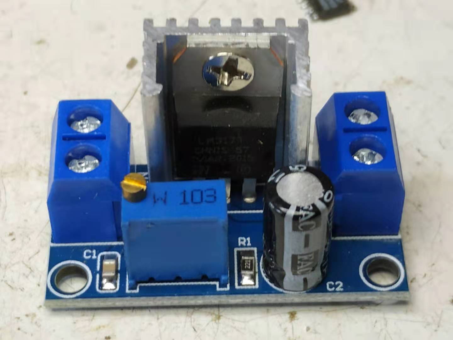

There's no on-board PSU with Kubelik, it needs a quiet supply at 20V (current consumption TBD) which I supply with a modified LM317 board I bought from Taobao. These boards are also available on Amazon, with mixed reviews. Its true a few don't work, sometimes the LM317 needs replacing. But they are super-cheap.
I modify them by removing the multiturn preset and in its place I solder a couple of SOT-23 zener diodes in series to give me the output voltage I want. In this case, a 10V and a 9.1V zener gives a reference voltage of 19.1V and the output voltage is 1.25V higher than that, i.e. 20.4V roughly. In turn, the reg board is fed from a 24V wall-wart (which itself contains a 7824 reg).

I've built up two r2 Kubeliks now and on the 2nd one I have been playing a bit with opamps - some more are on order to test my hypothesis further that noise is the crucial issue in this circuit.
With two Kubeliks its possible to create a balanced DAC, by feeding the same I2S to both but running one of them inverted in the digital domain. The outputs are then R+,R-,L+ and L- which effectively doubles the output voltage just like bridging an amp. The difference between a bridged DAC and a bridged amp is that we have control over the load impedance (unlike with a speaker, where its fixed) so a bridged/balanced DAC calls for an amp with 6dB lower voltage sensitivity. Not to mention the ability to handle a balanced input.
Fortunately with my latest revision of my monoAMP design I have a suitable vehicle - the EE35 input transformer can accept more turns on the primary, through using thinner wire. Initial listening is promising, sounds like the dynamics took a step up 😀 So it sounds like its a viable way to create a 12-chip DAC for those who don't want to get 'down and dirty' with modding.
