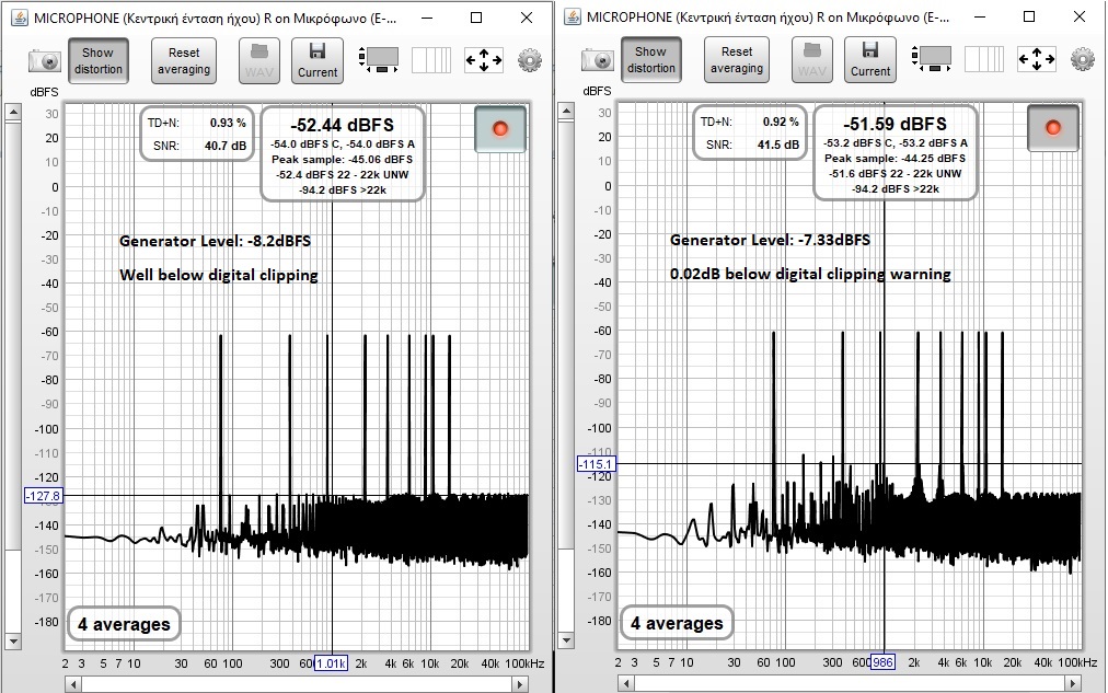

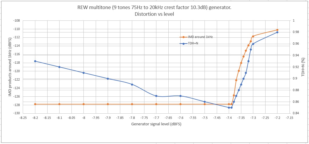

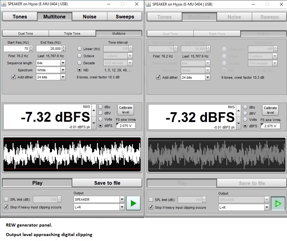

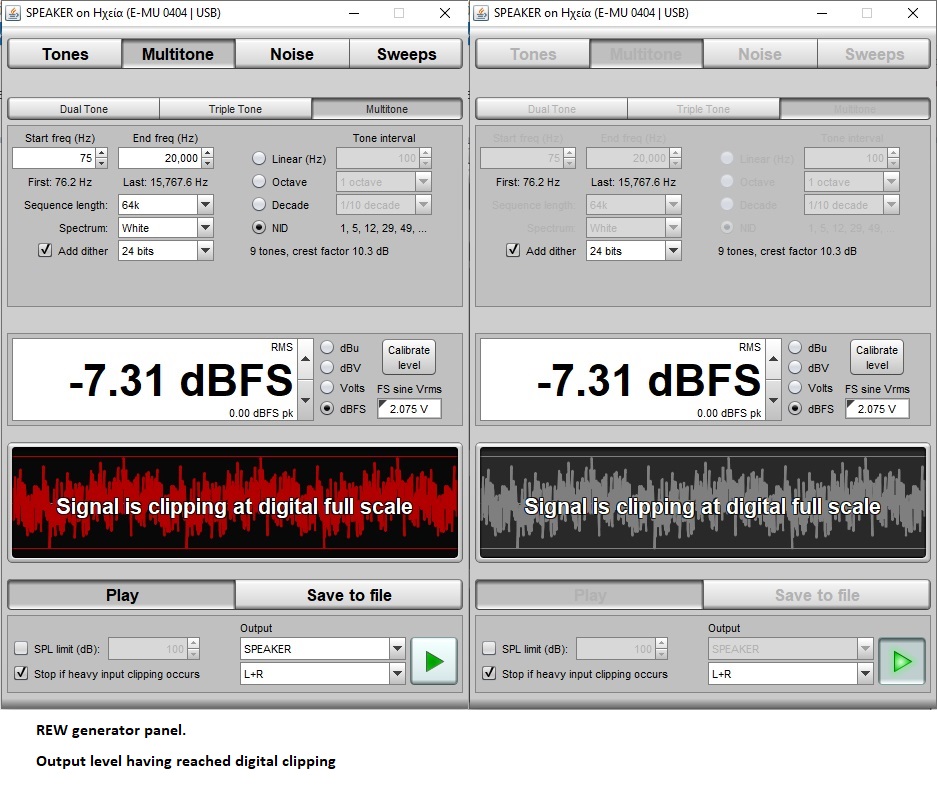

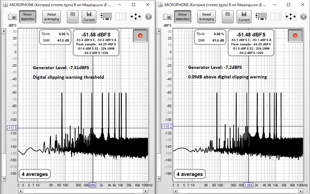

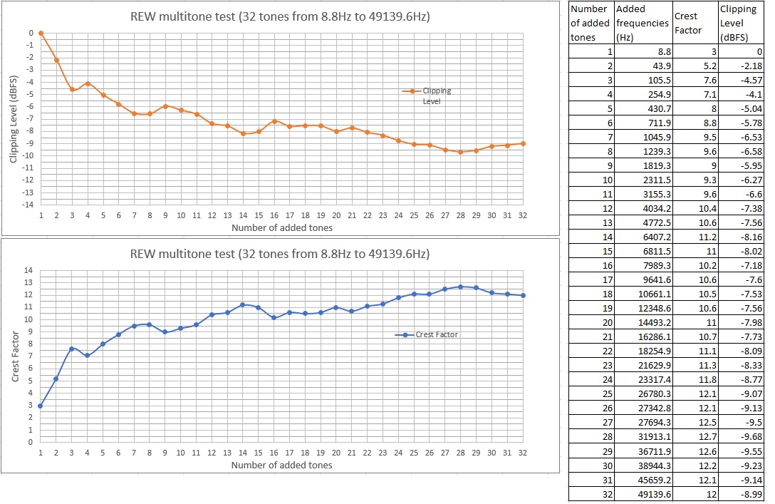

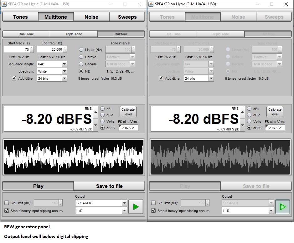

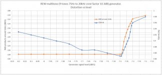

It is a table showing the clipping warning level of REW’s signal generator
REW generator issues a warning when it's output level exceeds a threshold.
Warning is: "Signal is clipping at digital full scale".
The detection of clipping is done at the digital level, upstream of each sound card’s analog out and any potentiometer that adjust the analog output of the soundcard. Clipping detection level has a resolution of 0.01dB.
For every waveform type there is a different clipping level.
To check the validity of that auto detect level, I looped-back the E-MU 0404 analog output to it’s analog inputs, lowered the hardwired output level so that card's inputs are way below their high levels and measured with REW's RTA the IMD of a multitone test. See last attachment for test results

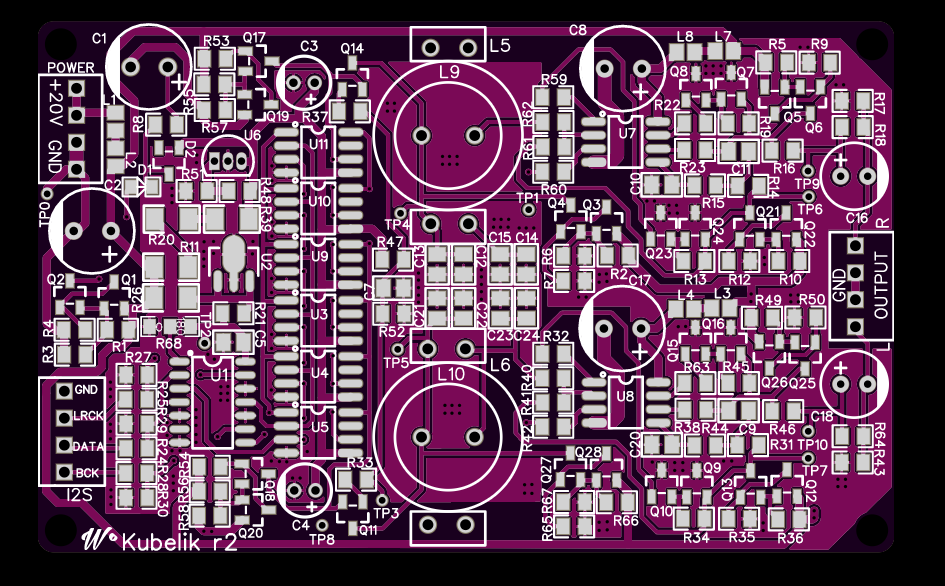

PCB layout
Here's how the r2 Kubelik PCB looks.
The inductors can be either P14s which I'm sourcing locally or if you want to source parts yourself you can use 22mH Bourns RL181S from Mouser. They do have stock right now (~1500) but who knows for how long?
We deleted the phase switch as that's just BOM cost bloat. Now the phase is switched by soldering a 0805 resistor in one of two positions. Inverted phase can be used for building a fully balanced Kubelik with two boards and 12 DAC chips 😎

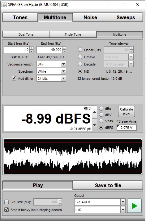

Still in REW, I was curious to see the reported crest factor and the reported digital clipping level when building multitone test signal by adding one frequency at a time.
When SR is 192kHz, 32 individual tones can be added one by one, starting from the lowest 8.8Hz.
Results below.
