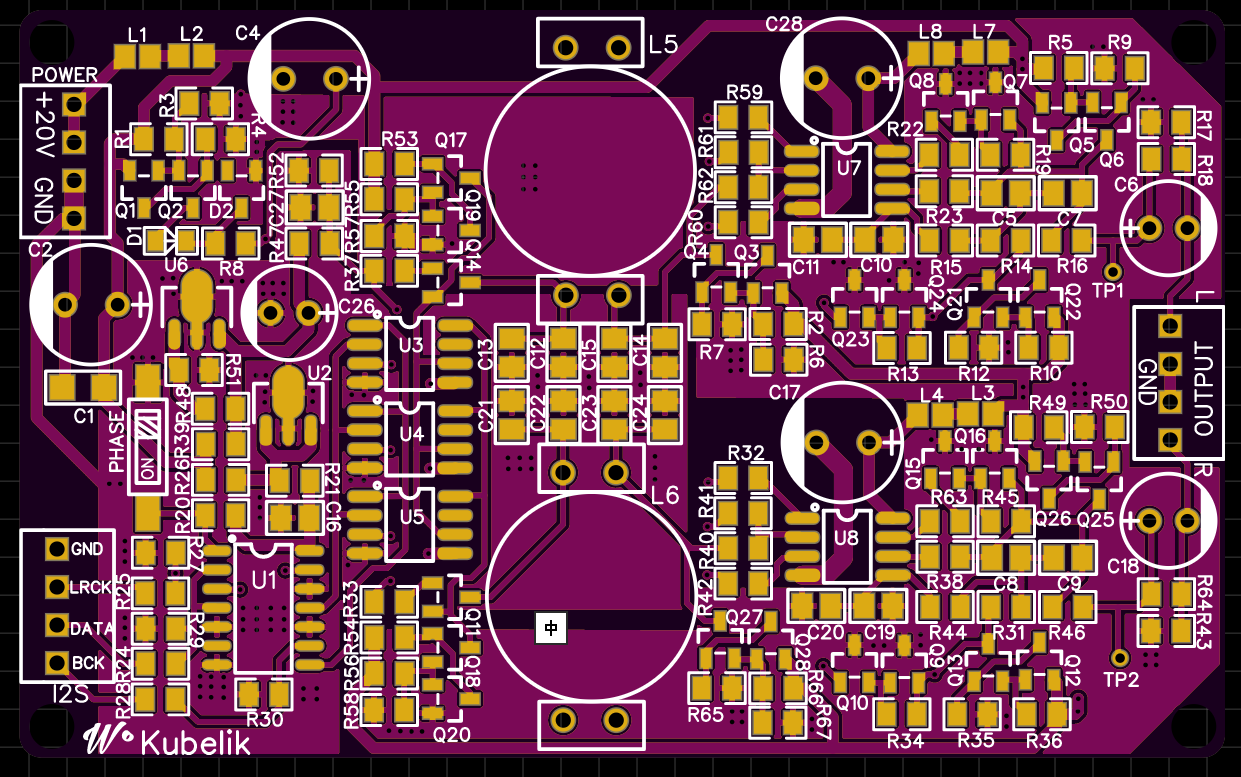

After a few years of publishing DAC designs I have decided to make a break with the past in terms of nomenclature. UK high-end DAC manufacturer dCS has named their DACs after composers for some time, I decided a DAC is more like a conductor than a composer in that it doesn't originate what it produces but interprets a 'score' (the digital file). So from now on my DAC designs are going to be named after conductors. The first one in the new naming scheme is named after Rafael Kubelik - here is the PCB layout.
The design is fairly close to the schematic I showed a week ago except I have abandoned the MFB filter due to noise concerns. S-K filters don't have frequency independent input impedance (they look more like a capacitor than a resistor to the driving stage) so the I/V stage has been reinstated. There are two stages to the analog chain : I/V, then droop correction/LPF, necessitating 4 opamps in total. The classA output buffers from Phi Hex and Deca are implemented on both stages.

Sure, we'll make the gerbers available so you can order your own and take advantage of the PCB houses' cheaper shipping arrangements.
As for the parts I think the only tricky to source parts will be the inductors. But perhaps I can adapt the PCB to use Fastrons like these : https://www.mouser.com/ProductDetail/Fastron/07MFG-273J-50?qs=3%2FphUcBLEfZu3pw%2F8xurOg%3D%3D If they do indeed come back into stock.

I was indeed planning to make kits (or rather, ask my wife to make them!). But recently most people have been asking for fully built DACs so I have been wondering if kits are really that desirable.
You can modify the Kubelik to give higher output (just a couple of resistor changes) if you give up the headroom for inter-sample overs. But I guess even 4VRMS isn't going to be enough for a MoFo amp. I think the 36 DAC design will be best suited to that - there's (in theory) up to 36V peak to peak, balanced.

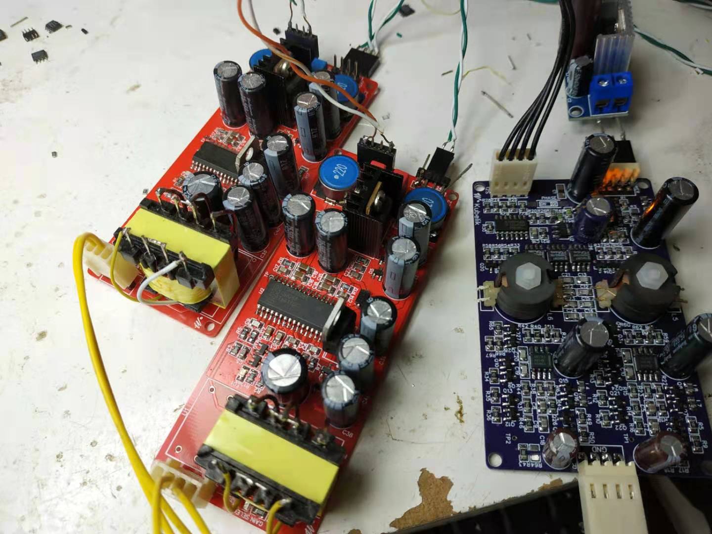

First PCB prototype of Kubelik
PCBs came rather quickly this time around, yesterday I built up one and today did a quick comparison with the original PhiDAC. This is using OPA1642 opamps as I'm curious to compare them with OPA1678 (which I'll use on the next one).
The most noticeable difference on connecting PhiDAC after listening to Kubelik for a while was that the depth collapsed rather, giving a flatter presentation. Kubelik has more sense of space, not quite as good as Deca DAC though as ISTM the most solid soundstage illusion needs very low noise in the lowest frequencies. Transparency overall is improved too which gives a 'cleaner' feel to some instrumental timbres and voices too. As one example, Michala Petri's recorder sounds more flute-like on PhiDAC, as if some noise is added. My overall impression is this DAC will appeal to those who put a lot of weight on mid-range delivery.
BTW - unlike the original PhiDAC, Kubelik has no on-board regulation, so far I'm only using a zener assisted LM317 20V regulator fed from a regular linear wall-wart.
