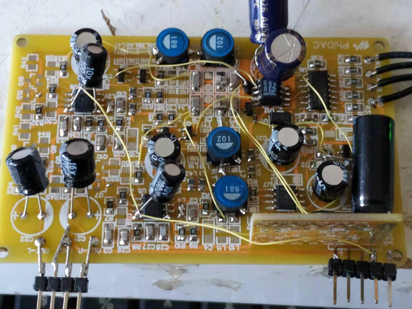

I couldn't resist revisiting the original PhiDAC design and seeing how TI's ultra-cheap low-noise CMOS input opamps (OPA1678) might work in it, swapping out the CFB AD8017s.
The answer after a couple of days' listening is 'rather well' 🙂 There are now 3 DACs in parallel rather than just one as OPA1678's voltage noise is a bit higher. The LC filter now works at a much higher impedance to get lower noise - originally it was terminated with 33ohm, now that's risen to 160ohm. Still a lot lower than the optimum resistance for the opamps but subjectively the results are pleasing enough.
With OPA1678 we're no longer limited to 12V supply so I'm running a bit higher and that gives the potential for handling inter-sample overs. I've not examined how well those are handled yet...

Having mentioned that a 160ohm impedance filter was much lower than the optimum for the opamp (which would be around 1k) I was curious to hear if there was any improvement in going higher. So I threw 3 1mH SLF7045s in series for the filter, reduced the caps proportionately and that gave about 285ohm. My wife said that the violin now sounded clearer (we have been listening on YT to a release of Mendelssohn's piano quartets).
I ran the noise gain on LTSpice and this shows about 3dB reduction in noise at 5kHz from the higher filter termination resistance (285 vs 160). But the strange thing is - this noise is already way below the theoretical dither noise of a 16bit recording, according to my estimates at least 20dB below.
So what about higher impedance still? Watch this space.

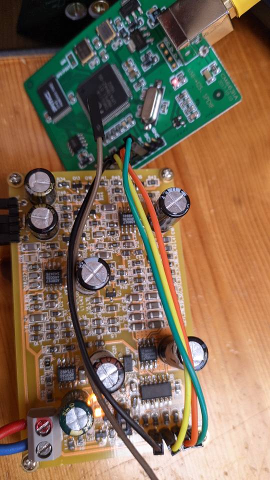

Some 2 years ago Matt had kindly sent a PhiDAC kit to me. Last year I've soldered it - was my first kit from Richard and my first ever SMT solderthing. Then it had been laying around for some time and, after having received a recommended cheap USB board from Aliexpress I did some very experimental cabling and hoorraay - there was and is music. Didn't really expect this.
Contrary to that in case of sound, I expected very good sound and yes, after a few minutes for forming, sound was really great. Amazing as Richards mone amps, I've built in the meantime.
So this nice little DAC in my eyes deserves a proper chassis.
Thanks Richard, thanks Matt!
