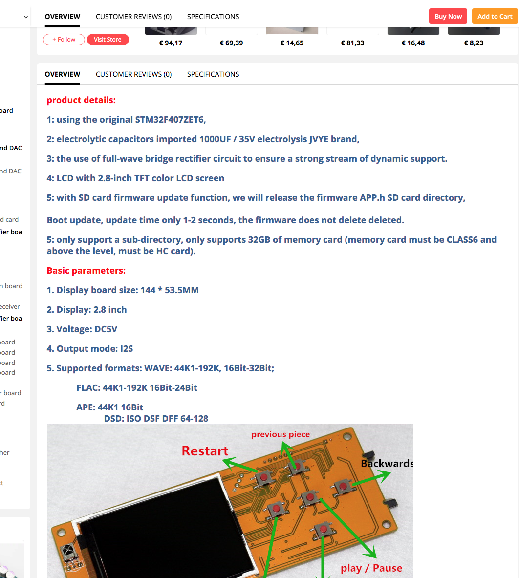

I went back into the Aliexpress orders from way back to check the listings for the yellow cards I bought before - if I am reading it right, they always had that same text "5: only support a sub-directory, only supports 32GB of memory card (memory card must be CLASS6 and above the level, must be HC card)."
But like you, they work just fine with lower capacity cards. The 32gb thing is a significant enough issue if you are using SLC cards
