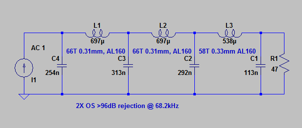

Hi Colin - yes I have indeed played with variations on filters. I even put up some simulated responses and measurements for using a passive filter designed for 2XOS : lingDAC - cost effective RBCD multibit DAC design lingDAC - cost effective RBCD multibit DAC design
A bit later on I posted a subjective comparison and found a slight preference for 2XOS.
The 2XOS passive filter is a bit simpler than the NOS filter as its a traditional Chebyshev with no stop-band zeros. This saves on a few RC networks. The droop correction is done in the final stage active filtering so running a 2XOS filter needs some component value tweaks to that filter (the one built around AD744 in the schematic). I will look at my notebook and sims to get back to you on the changes to component values.

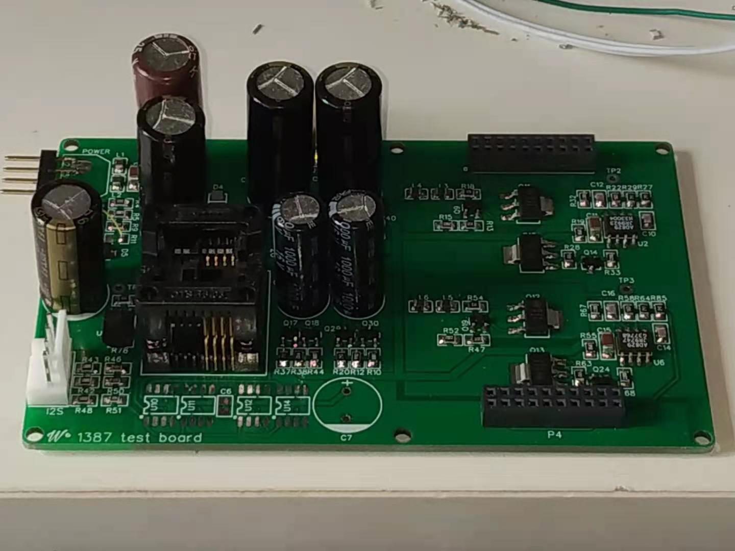

Seeing as I've run into one or two cases where DACs have given out strange noises at low levels and the usual test of checking pin7 voltage hasn't revealed an obvious problem I decided to build a board which will allow me to listen to a single DAC chip at a time, in a ZIF test socket.
The schematic is based on PhiDAC hex but instead of level shifting the logic signals to the DAC chip I decided to play with level shifting the outputs. That seems to work quite well - just zener diodes biassed by current sources brings the DAC output compliance range up to half the analog supply - which in this case is 24V.
The filter board isn't a normal PhiDAC hex filter - I built a custom one with higher impedance (240ohm rather than 47ohm). The shocker when I listened was that this DAC sounds much more like 'hex' than the original PhiDAC in that it fills in the low-level ambience which original PhiDAC loses. Since I had originally put the extra ambience of 'hex' (and GrossDAC) down to having many paralleled DAC chips this came as something of a surprise. How can a single chip get down to the lower effective noise levels of the paralleled DACs?
Based on further experiments seems the answer to this is in the I/V stage. It's that that's too noisy in original PhiDAC. Putting more DACs in front of the I/V opamp increases the signal while keeping the noise the same. Hence better SNR. A higher impedance filter results in less noise by virtue of lowering the noise gain of the I/V.
This little nugget of understanding inclines me to revisit the original PhiDAC and see if there's any way I can fix up its lack of low-level details while sticking with its single DAC chip, single PCB format....

Maybe independently decoupling of single chip in nature? Can you extend your investigation with independently decoupling and bypassing each chip by following a similar layout in photos? The photos are belong to TDA1541 to TDA1387 replacement adapter on Aliexpress.
https://www.edn.com/bypass-or-decouple-your-way-to-power-supply-noise-reduction/

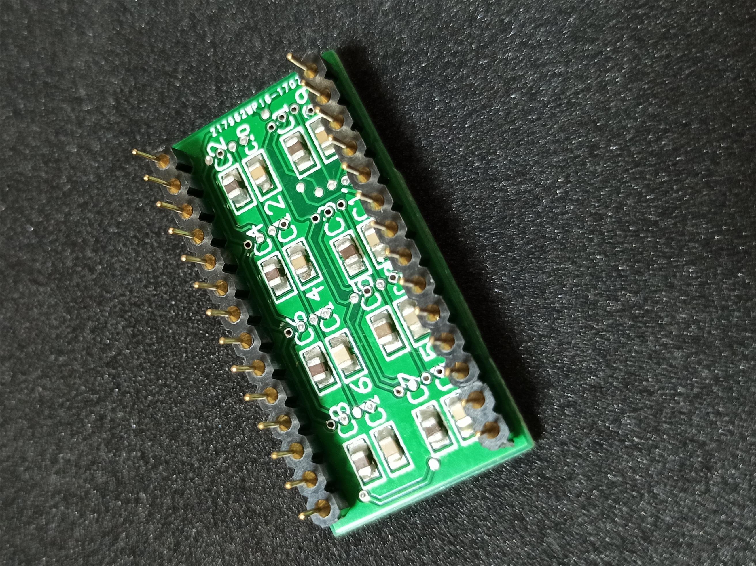

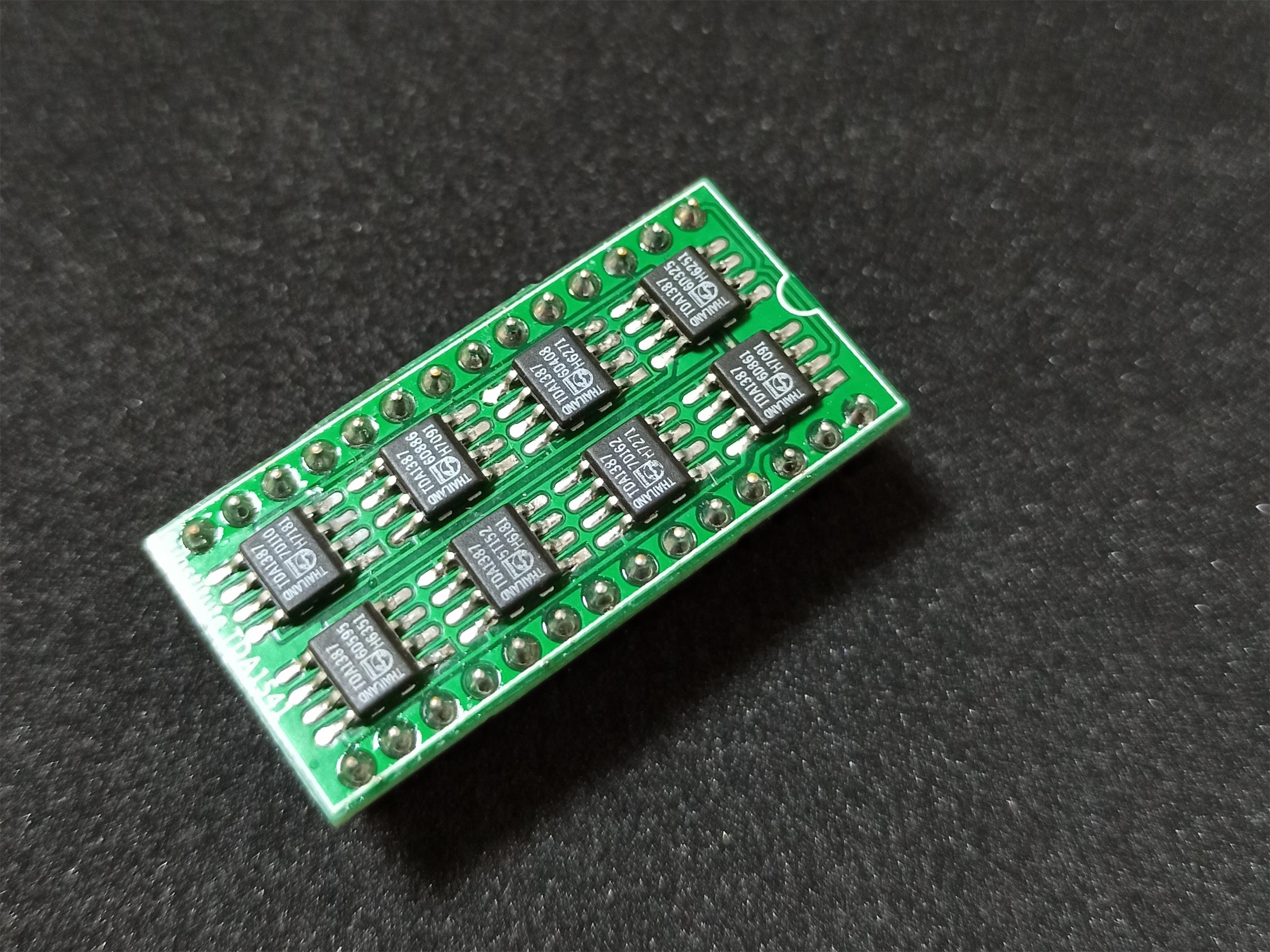

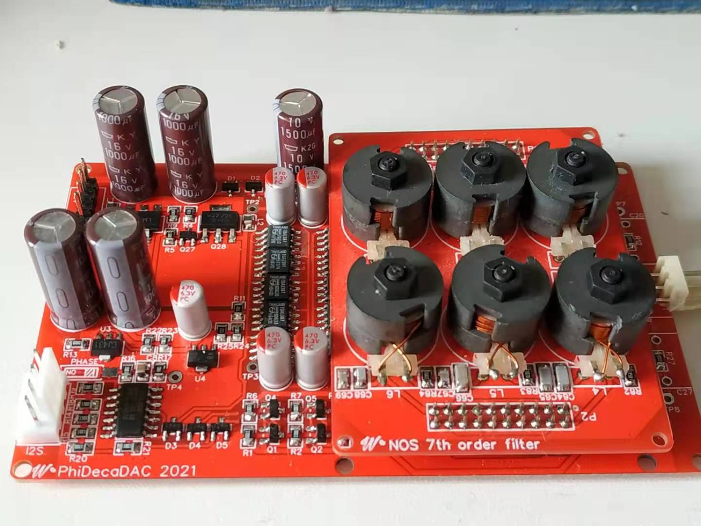

Here's the first prototype Phi DecaDAC - using 10 TDA1387s to improve the SNR downstream. I'm estimating about 12dB reduction in the noise by virtue of
1) using more DAC chips hence more signal
2) substituting LT1028 opamps for AD829s in the I/V stage
To ensure the gains in the I/V aren't lost in the EQ stage I've tweaked the noise gain there and exchanged AD744s for an ISL28210.
The AD815 in the power supply has been changed to an LM317 for the opamps and a discrete darlington for the DAC chips.
Schematic to follow later this week.

Schematic for Phi DecaDAC
I've added one or two more test points to make test and fault-finding a little bit easier compared to the 'hex' and also the voltages expected at those nodes.
Current consumption is a little bit higher than the 'hex' - whilst I've saved on the not-insignificant quiescent of the AD815, the extra 4 DAC chips more than cancel that saving out.
