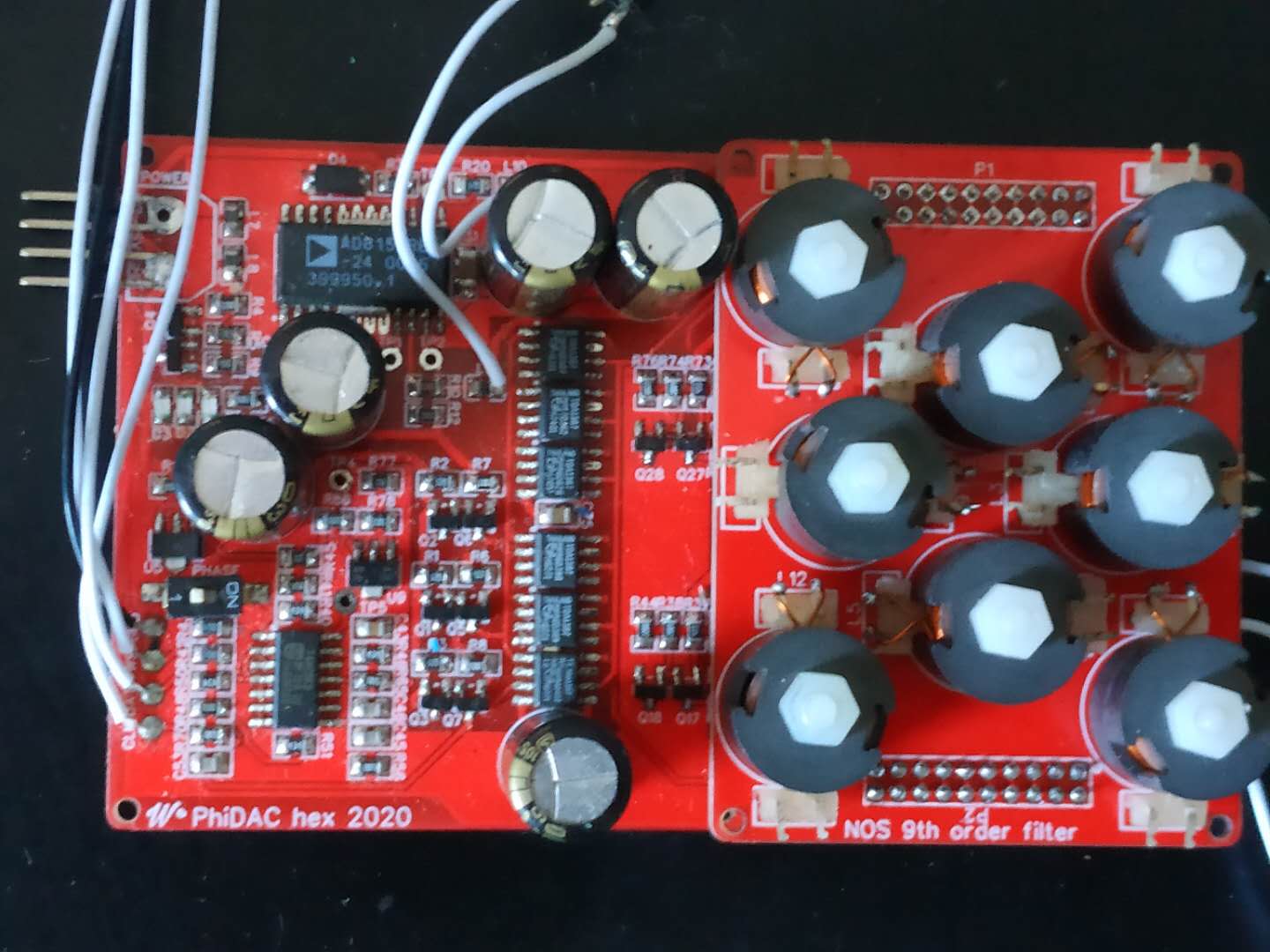

Prototype 9th order filter
My wife managed to find a way to squeeze 8 inductors onto a board outline designed for 6 🙂 The stop band rejection for this filter is in theory better than 100dB but in reality this number is going to depend on circuit parasitics which I'm not able to quantify accurately. Listening will reveal whether there's any benefit of this compared to the 7th order filter. If anyone's interested in the FR plot (simulated) just ask and I'll post it up.

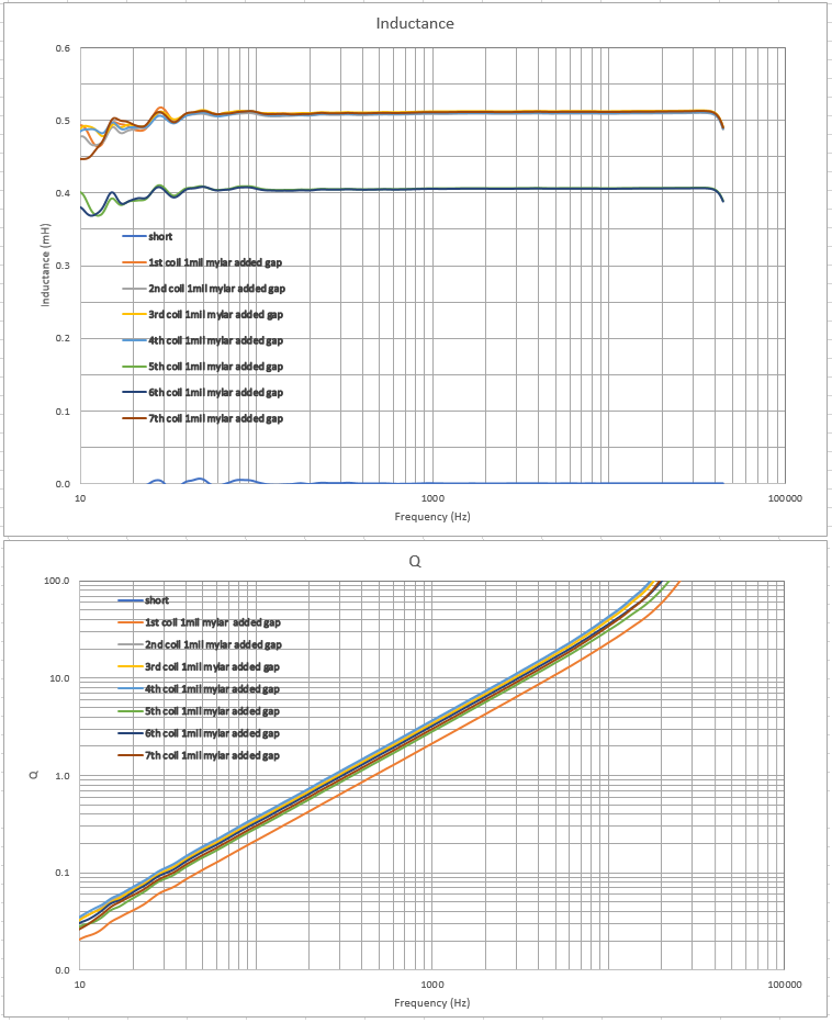

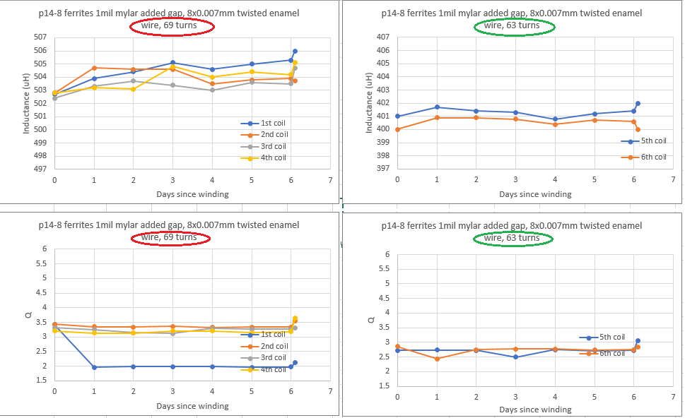

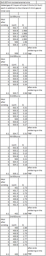

I decided to wind all the six coils (for the 7th order filter) using 2 layers of mylar food wrap.
It ended to be 69 turns for the 502uH and 63 turns for the 400uH. I make the L, Q measurement for some days to see for change due compressibility of the plastic foil and/or relaxation of plastic screw tension.
I’ll report back on this.
Attachment 1, 2: This is what came out of this test at 1kHz test frequency.
I was thinking that the extra gap due to mylar foil might change from it’s initial value over time but this does not reflect on L and Q values which remained quite stable over a week.
The sharp drop on Q on the 1st coil is due to breaking of two of the 8 0.007mm enamel wires The coil ends were on the air during measuring period. At the last day after the 6th measurement, I properly soldered the leads to the bobbin tags and L, Q values changed slightly (last measuring point on each diagram).

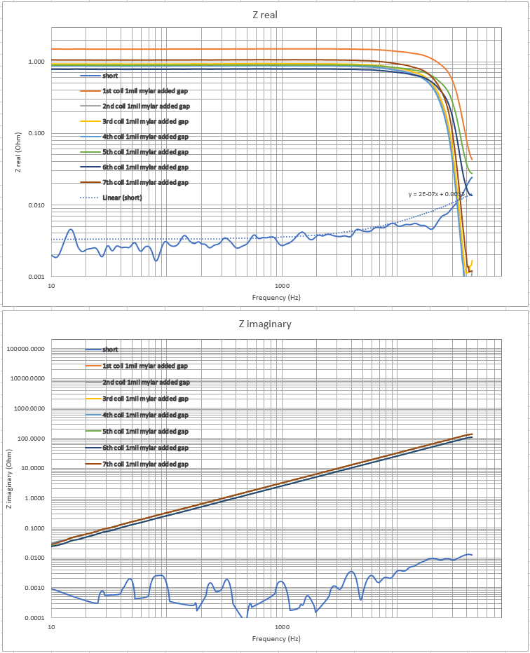

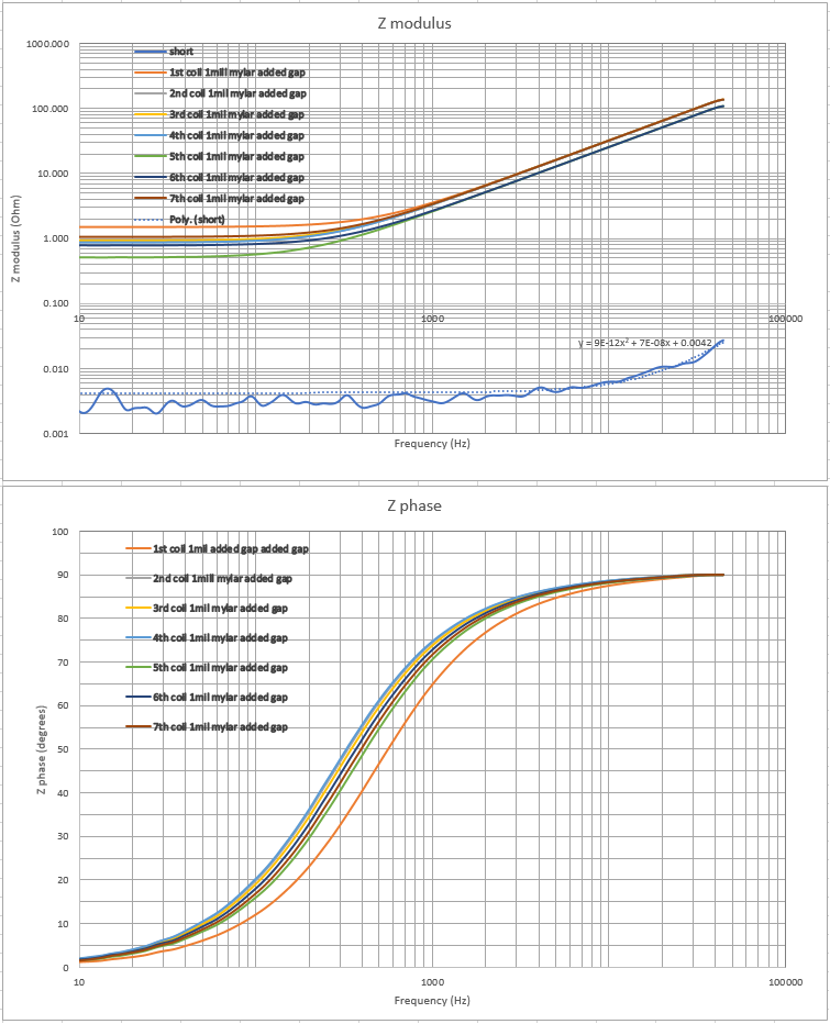

Attachments 3, 4, 5 are impedance sweep results (0-46kHz) on the coils with my E-MU 0404 sound card. Signal level:1Vrms
The faulty coil is to be replaced by another one (the 7th coil at the sweeps).
George
