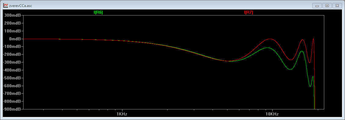

I've attached a plot that I got from running an LTSpice sim of two elliptic filters - one with almost zero losses (Qs above 10,000) and the other with P14 inductors with their typical Q around 200. The finite Q gives rise to a couple of effects on the filter's passband - uneven ripples and droop towards the transition band.
From the picture its clear that elliptic filters exhibit the sharpest transition from passband to stop band of the available types. What the textbooks don't tell you though is how to get that pretty shape in practice with real, lossy components. NP0 capacitors are extremely high Q so rarely are a problem, provided one has enough of them. Inductors though are much lower Q in practical sizes.

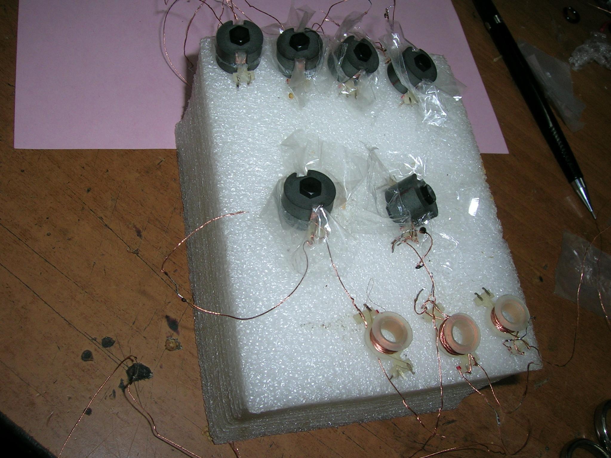

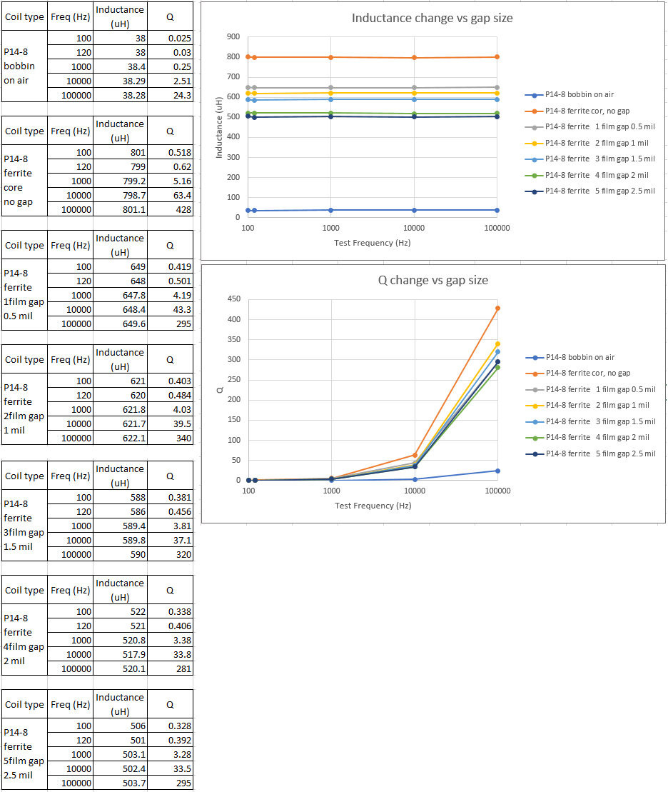

I run a test on the effect of increasing gap btn the two halves of the P14-8 ferrite on the inductance of wound coil.

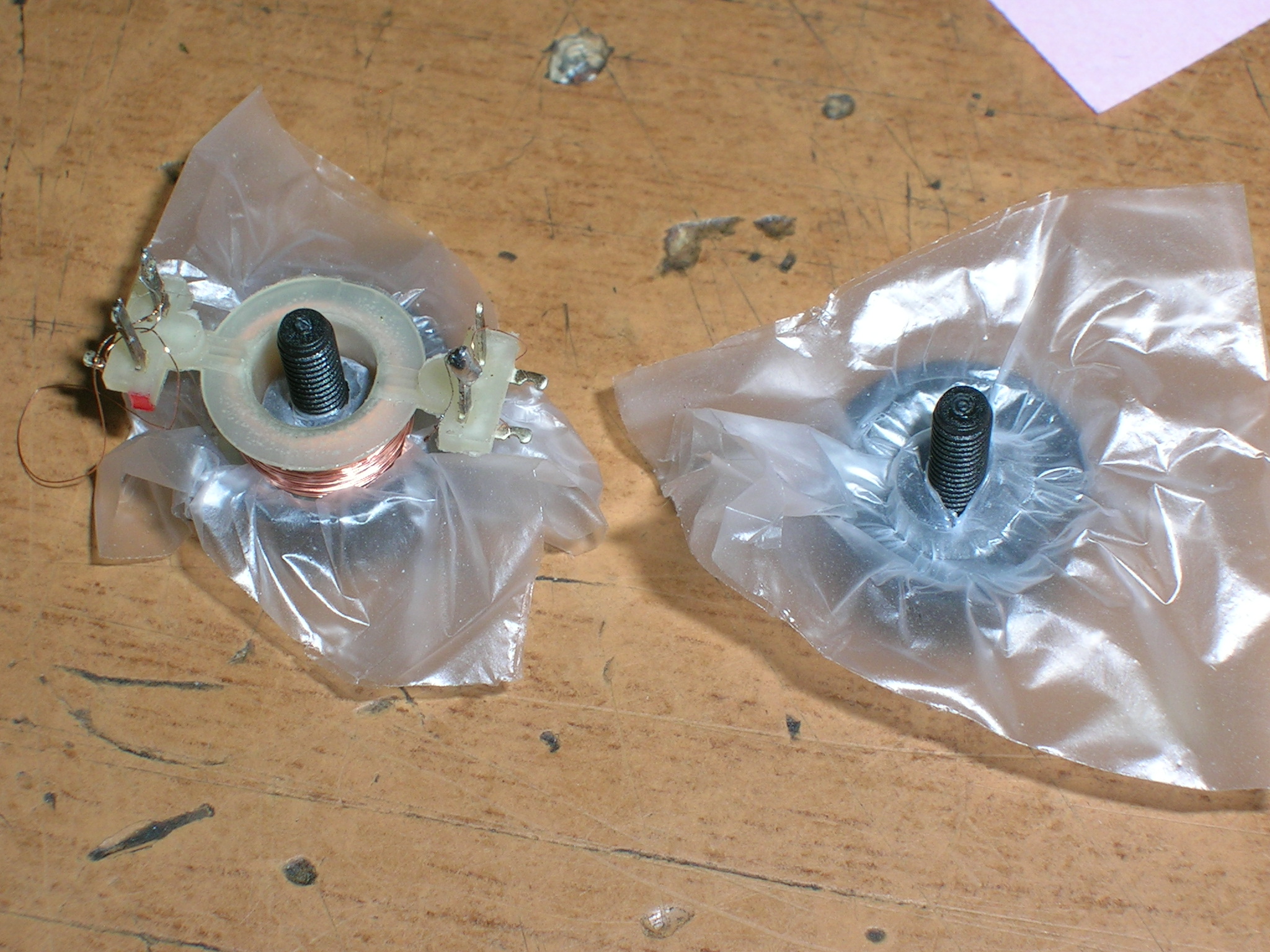

For spacer I used small pieces of plastic food bags and later mylar food wrap foil both of which are half a mil thick (0.0005inch=12.7um).
I wound 70 turns of 10x0.0007m twisted enamel wire over the coil former. The plastic screw was set finger tight. I measured inductance and Q
Results show the inevitable effect of tension variation (finger sense,no torque tester) but this effect is much less abrupt than on no-gapped ferrites.

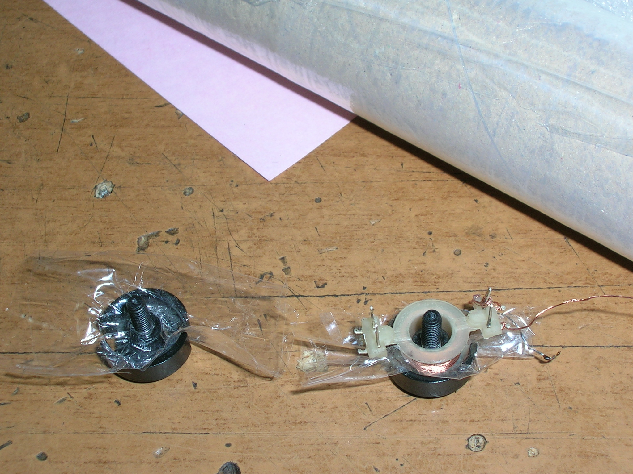

I decided to wind all the six coils (for the 7th order filter) using 2 layers of mylar food wrap.
It ended to be 69turns for the 502uH and 63 turns for the 400uH. I make the L, Q measurement for some days to see for change due compressibility of the plastic foil and/or relaxation of plastic screw tension.
I’ll report back on this.

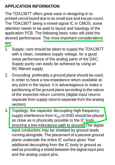

You mean independently decoupling each chip with a cap? I haven't done that but I've nothing against it. Yes, I use two caps for decoupling six chips - the 1uF ceramic and a 2700uF 'lytic.
Yes, I meant that. I was a bit disappointed to see that your board doesn't have independent decoupling for each chip. In technical aspect, I expect you to follow datasheet layout directives just like other Ebay,Aliexpress tda1387 boards did.
Have you any plan to alter board layout in near future?
You may aware of that each dac chip doesn't perform same since their physical distance to the "single" low impedance decoupling point isn't equal. This means parallel operation is not optimum.
If you are familiar with Nobsound TDA1387 board, you can follow same route by placing decoupling caps beneath the chips.

Even if your "design choice in respect of decoupling" in contradiction with Philips engineers whom also stating voltage compliance values on same datasheet? Yes you are free of choosing different value of voltage compliance too but I'm also free to bring "your own design of choice" on table without building, testing and measuring since DS says something different.
You've made it clear you are 'disappointed' - that's an entirely subjective position to hold. I see no reason to make design changes in response to someone's disappointment. Do some experiments yourself then you're bringing something tangible to the table.
Subjective? I thought you were aware of that I was suggesting you to just respecting the DS. Because I'm bringing on table something much less "subjective" than PCB color of choice.
