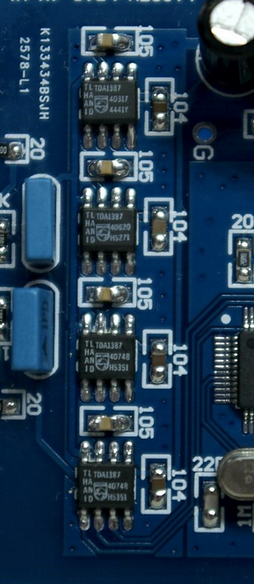

Topology: the capacitor decoupling high-frequency supply interference from VDD to GND should be placed as close as is physically possible to the IC body, ensuring a low-inductance path to ground.
And this. I see some designs following this advice but some not (including yours). I see a 1uF ceramic cap in the middle of the row. Is this cap for this role? Can you share your opinion on independently decoupling each cap?
Attached photo is from another design.
You mean independently decoupling each chip with a cap? I haven't done that but I've nothing against it. Yes, I use two caps for decoupling six chips - the 1uF ceramic and a 2700uF 'lytic.
On the photo there are two individdual caps per chip. One 1uF on a REF pin (7) and one 100nF on the Vdd pin (5). The same values as recommended on the datasheet. My portable Nobsound 8x TDA1387 DAC/HPA use exactly the same scheme. These bypassing caps are critical for SQ, some others use two large electrolythic caps per chip, but it requires mounting caps on the opposite PCB side of DAC chips.

@KorbenCZ. In a quoted text I was invetstigating reclocking in the audiophonics design. This matter is sorted out. They do use reclocking, but a primitive one, sort of things I would avoid. It is a marketting trick, trying to catch people with TXCO oscilator that (IHMO) does more harm than good. It is noted however that there is a proper bypassing of each TDA1387 chip individually.
