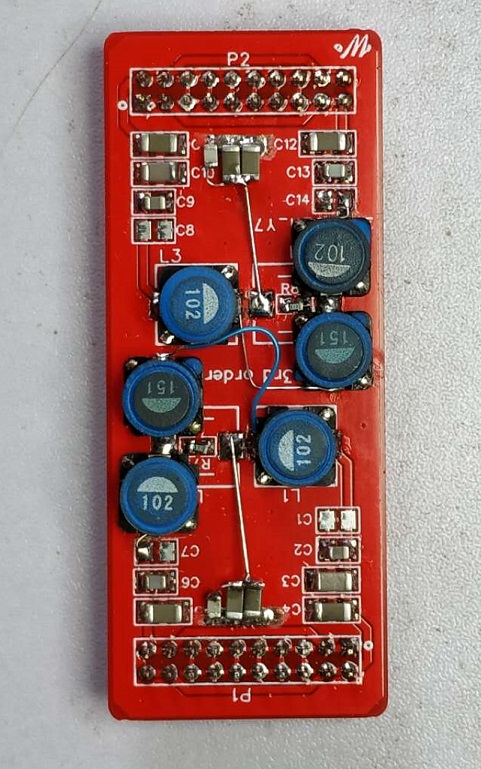

To celebrate my return to the ferrite fold, here's an intermediate filter idea using TDK off-the-shelf inductors.
Because I already have SLFs binned in various inductances I was able to simplify the prototype not to need the 22uHs. Next step is modifying the I/V resistor of the DAC and then.... listening 🙂

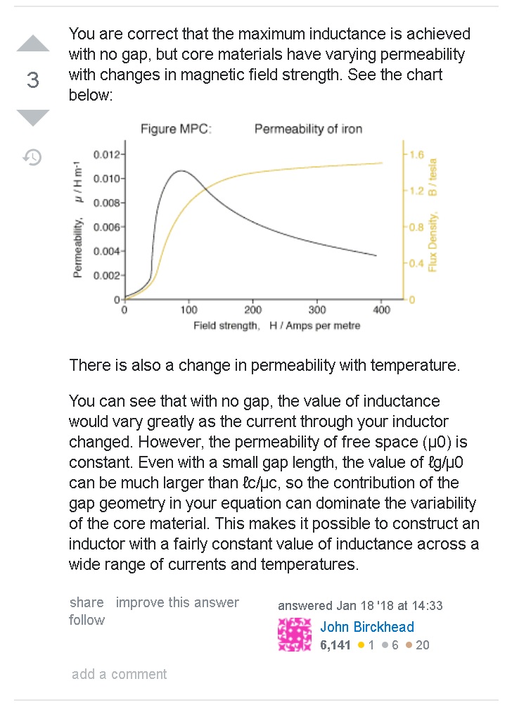

Thanks for a feedback. I picked up some resources, I think it will also help @abraxalito, if not now, then in the later stage.
This one is for EI core, but interesting, as I thought that it would be sufficient to remove material layer from the centre: Building Your Own Audio Frequency Choke Coils, October 1932 Radio-Craft - RF Cafe
This one is focusing on the optimum air gap (from a Brooks perspective): Air gapped magnetic cores
Forum discussion on air gaps. I also picked up a screenshot from the John Birckhead post: design - Why do we want gap in the core material while designing inductor? - Electrical Engineering Stack Exchange
A Google link to the most recent publication, there is a lot on air gaps:
https://www.ieee.li/pdf/viewgraphs/fundamentals_magnetics_design.pdf
The most of resources focus on tubes (of course), like this part on filters, but it is very comprehensive guide when looking form the index page: audiofilterchokes
A link to the TDK catalogue you posted before is also nice. It seems that distributed airgap is the best from a leakage perspective, but I didn't check prices. 🙂

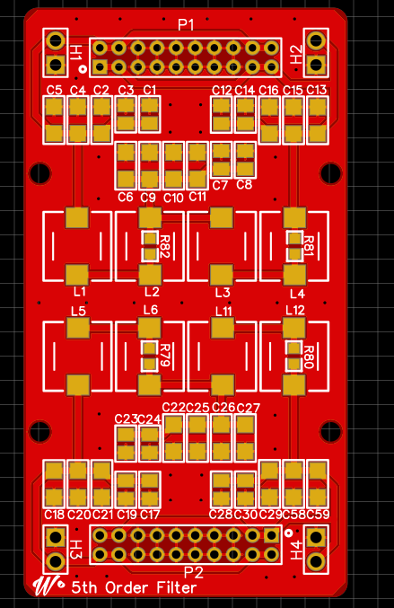

5th order filter now has a PCB layout
Prototype PCBs due back next week. Since one interested DIYer wants to try this filter with a PCM1704-based DAC we've added a few extra connectors and mounting holes.
Whether the filter can be used will depend on the output impedance of the 'noDAC'. Its designed to be used with current source output DACs (high output impedance). It can work without much degradation down to 1kohm (the output impedance of PCM1704). Below that I've not explored. Aren't most 'noDAC's based on logic chips? Their output impedance is likely going to be low - below 100ohm.

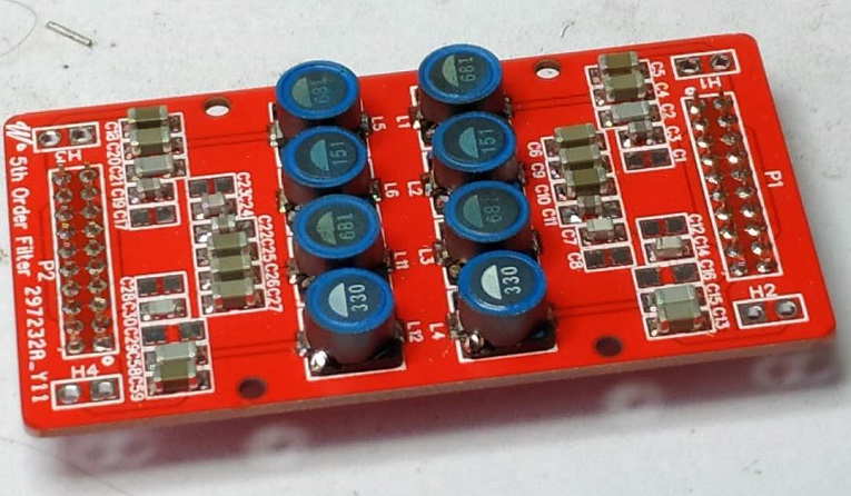

Revised boards arrived a couple of days ago for PhiDAC SE and the first one I built worked first time - at least it played music, I've not checked the flatness of the filter yet.
The extra caps on this design are fitted underneath the board via 1mm bare copper wires. The DAC still works without the off-board caps though as it has a few ceramics doing the local decoupling.
PhiDAC SE is very much at home driving headphones directly, even down to 30ohm impedance due to the far better dissipation capability of AD815s compared to AD8017s. Plus the advantage of additional caps (up to 26,000uF per channel) to provide greater output current without significant 'sag' on the rails.

Here's one of my early prototypes of the 5th order filter - its not on general sale yet as I'm not sure I can make them in sufficient volume. But by all means ask if I have any available 🙂
