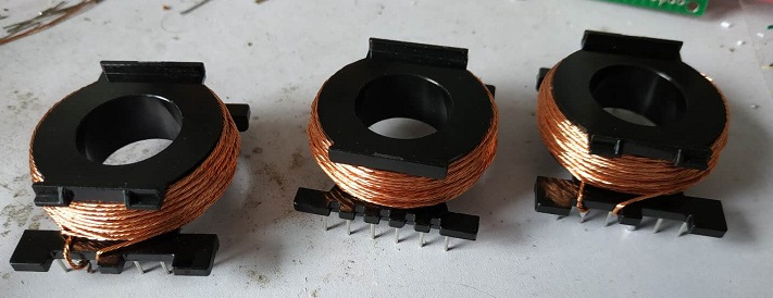

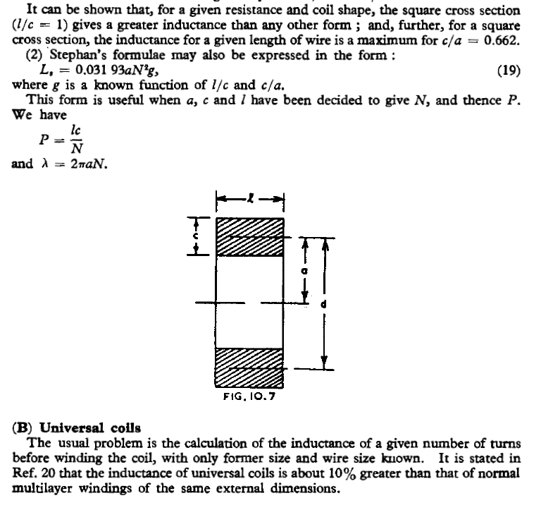

I did some researching into differing geometries of multi-layer coils and made the useful discovery that there's a kind of coil called a 'Brooks coil' based on a paper (in 1931) by a chap named Brooks. He discovered that for a given length of wire there's a maximum inductance that can be achieved - its when the height of the coil is one quarter of its width.
Therefore the coils I made before were too tall - I can get away with less wire if I create shorter, flatter coils. So that's what I did. Shorter wire means higher Q. The coils in the picture don't quite meet the Brooks criteria but they're close enough for a first attempt.
If only the maximum L is the only parameter required, a Brooks coil would beat any other coil in this world. 🙂

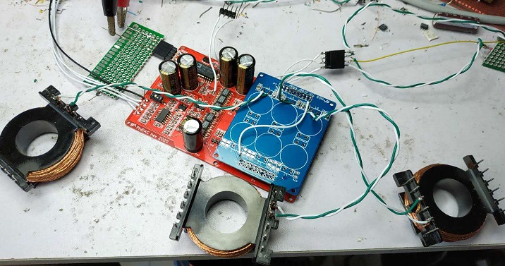

Next stage air-cored experiments
I've wired up the three 'Brooks-style' inductors that I've made so far to one of the first generation filter boards. The inductance that resulted from my single length of copper rope wasn't quite the same (about 5% lower) than the inductance of the P14s so I re-jigged the caps and termination resistance for this experiment. Seeing as I only have the 3 coils so far, I arranged the I/V converters to have twice the termination resistance (in this case, 86ohms) so that I put them in parallel, giving output to both channels.
Initial results are quite promising in that I haven't so far noticed any hum pick-up and measurements show the filter behaving as expected from simulation. When I move the coils closer I see all kinds of weird peturbations of the filter's response, quite similar to what I saw in LTspice as I varied the coil coupling coefficient. Good enough results I feel to spend another couple of hours winding three more coils and creating a second channel of filtering.
One thing that might prove more DIY friendly than ferrite cores is the predictability of the inductance of these coils - the two I created with the same target inductance turned out only to vary by less than 0.5%. If this isn't just a fluke then builders might not need an inductance meter, rather so long as they have the right wire and bobbins and can count turns precisely, they'll get close enough to the target inductance not to need to measure their creations. Let's see what happens with the next 3 coils....
