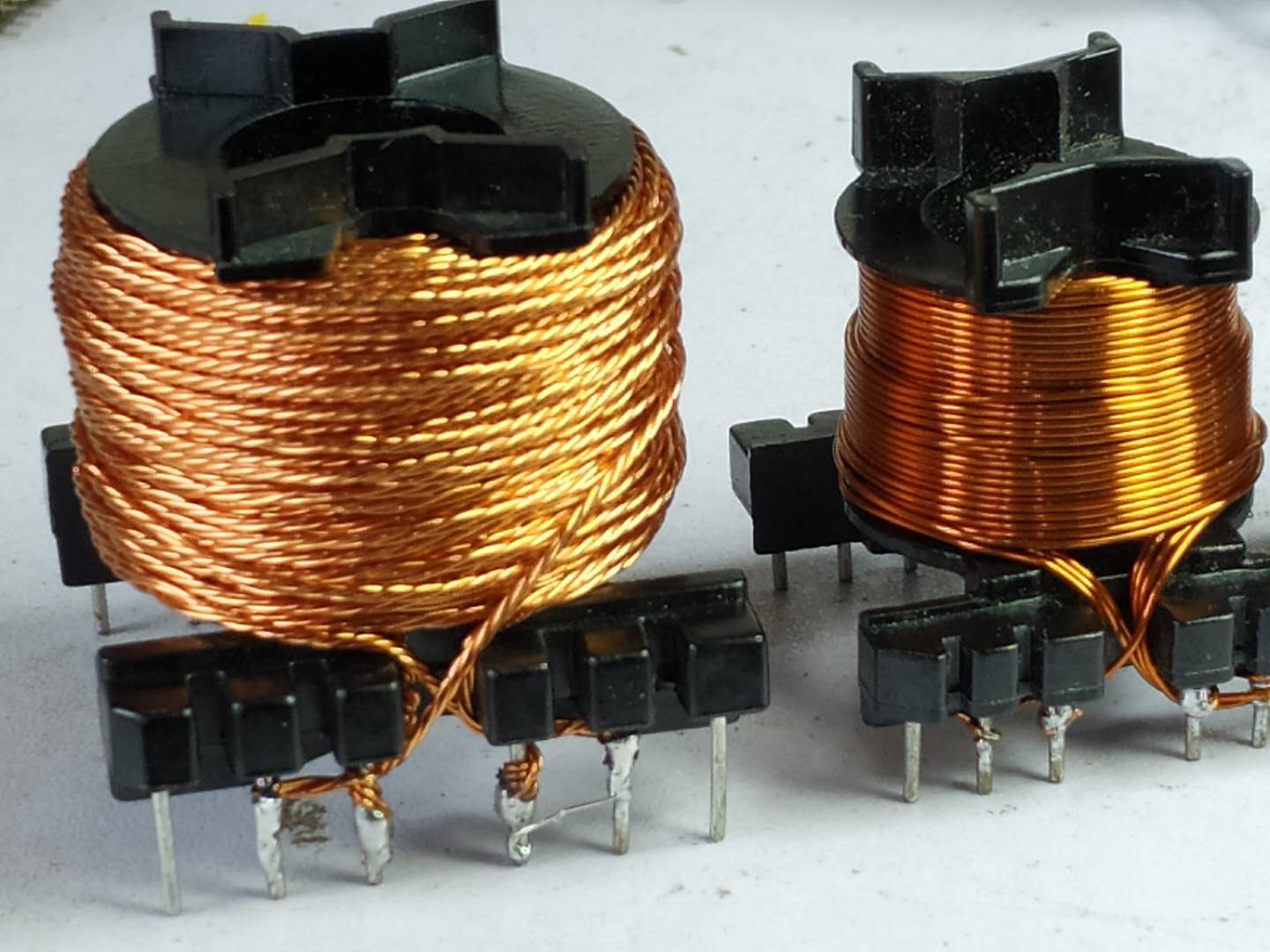

The PQ32 inductor exceeds the target spec, its not a trivial one to make though. I twisted four strands of 0.31mm wire together and made a copper 'rope' to wind it with. I'm limited to how much rope I can make in one length though (about 10m) - this one needed about 13m hence two sections I joined.
It reads 505uH from 192 turns and the DCR is 0.9ohm. AC resistance @20kHz is 1.4ohm giving a Q of almost 47. The P14 ferrite cored coil has Q ~145 for comparison.
The PQ32 bloated looking beast is the one on the left, next to the rather diminutive PQ26 on the right.

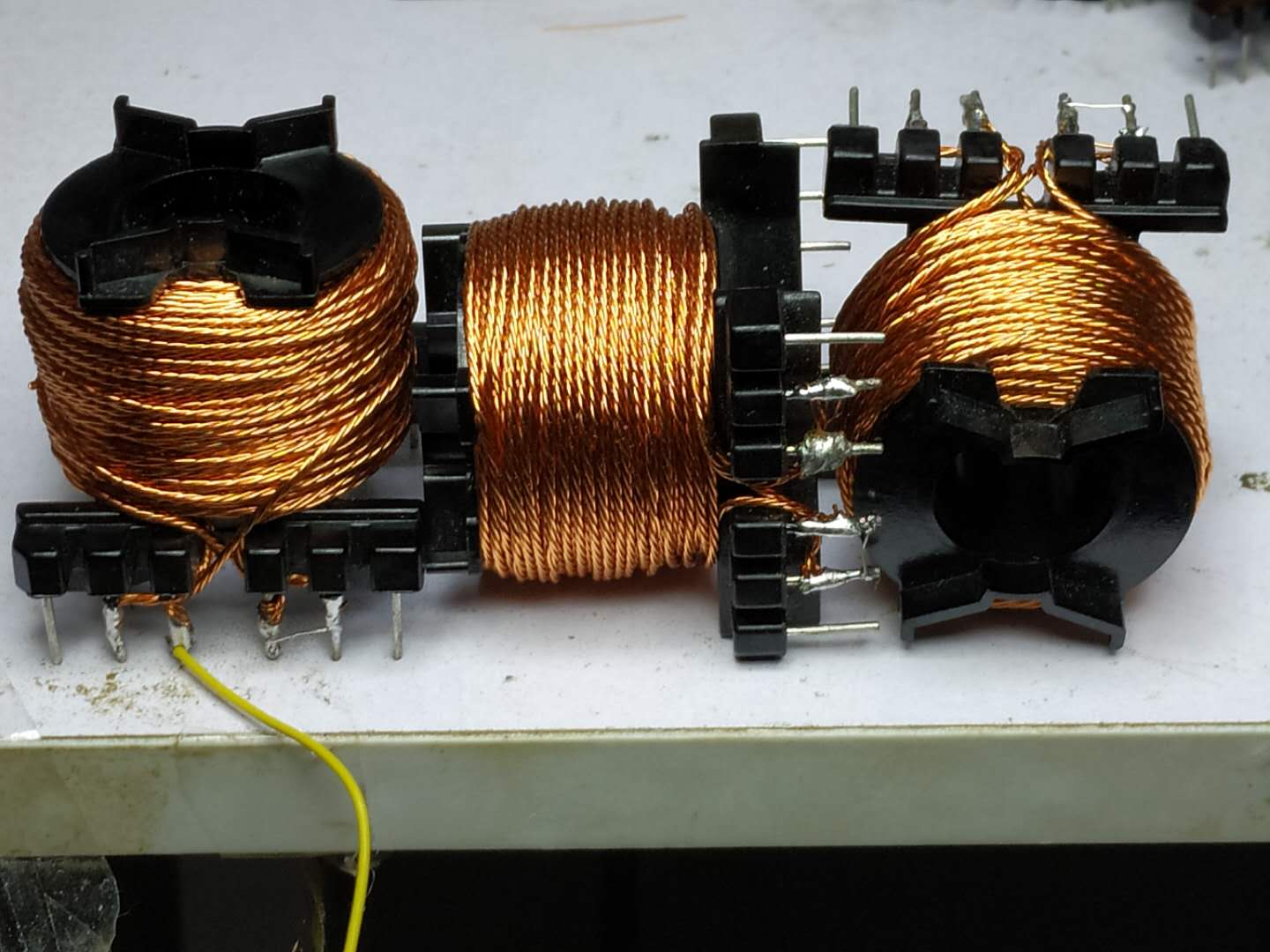

Now I have 3 inductors with high enough Q - the next challenge is how to arrange them so they barely couple to each other. Or so that they couple in a very predictable manner so that the filter can be designed around that coupling. LTspice is useful here as the coupling coefficient (K) between inductors can be input as a parameter. The tricky bit though is knowing how much physical separation corresponds to how large a value of K. So I experimented with a signal generator and AC voltmeter.
The lowest coupling between two inductors is when their axes of winding are orthogonal. I wonder if that principle extends from two to three inductors - will we still get minimal coupling so long as all axes are at right angles to one another? If so then the fundamental nature of 3D space would seem to indicate I can't place a 4th (or further) inductor in such a way as to minimize coupling with the 3 already there. Which becomes a hint that this should just be a mono filter....

As a first approach, it seems the proper orientation for limited distance btn the coils.
What is the frequency spectrum of the signal at the output of the DAC that has to be LP filtered? I would start from there.
I would use a HF signal generator to feed the filters, a sniffer coil to probe the field of the coils and start doing some measurements.
Then I would use music and record with the soundcard the output of the DAC/filter assy. I would compare recordings made during the mods in filter design.
