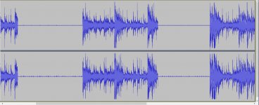

I took an Original Phidac and a Quad and aligned them in Reaper. Then I phase inverted one track. This cancels out all audio that is the same and leaves only what is different. What is curious is that there is more "different" information in the right channel than the left. Here is also a visual of this recording.
I provided the audio sample in the link above.

This is post #93 from 2018. Ironically this is second time that I see phase linearity as a goal here even though audio quality is the main interest in whole site. Other one was jbau's analog power supply experiment based on LT1085/LM337 (circuit schematic a few post below). According to his experiments, more phase linear power supply in audio band, more detail and holographic presentation attained.
There's a lot to read in that thread, I skimmed a bit to get a flavour of what jbau was doing there. Phase linearity of power supplies is rather a different thing from phase linearity of signal. He's powering opamps which as far as I could see don't run in SE classA like mine do in PhiDAC hex. The reason for running SE classA is to minimize the effect on SQ of power supplies - jbau's approach looked to be the complementary one. That is : given normal classAB opamps, what's the best power supply? I took that approach in PhiDAC SE. I reckon addressing the power-sensitivity of the circuit gives better results but anyone can have a listen to PhiDAC hex vs PhiDAC SE and make up their own mind 🙂
Reading on, a bit later I see @KSTR has already come to the same conclusion as me. From post #166 he says :
A way of improving rail exitation spectra is by forcing class-A operation and when you use balanced circuits the net draw from the PSU is constant. This can also be done in single-ended by adding dummies (not part of the signal chain) for the sole purpose of getting that constant current draw action (very feasible and very effective, too, with dual opamps like good ol' 5532's and the like) -- together with a reasonably clean and flat impedance supply and proper local bypassing this IME does more good than a better supply with an amp stage design not drawing as constant a current as possible.
