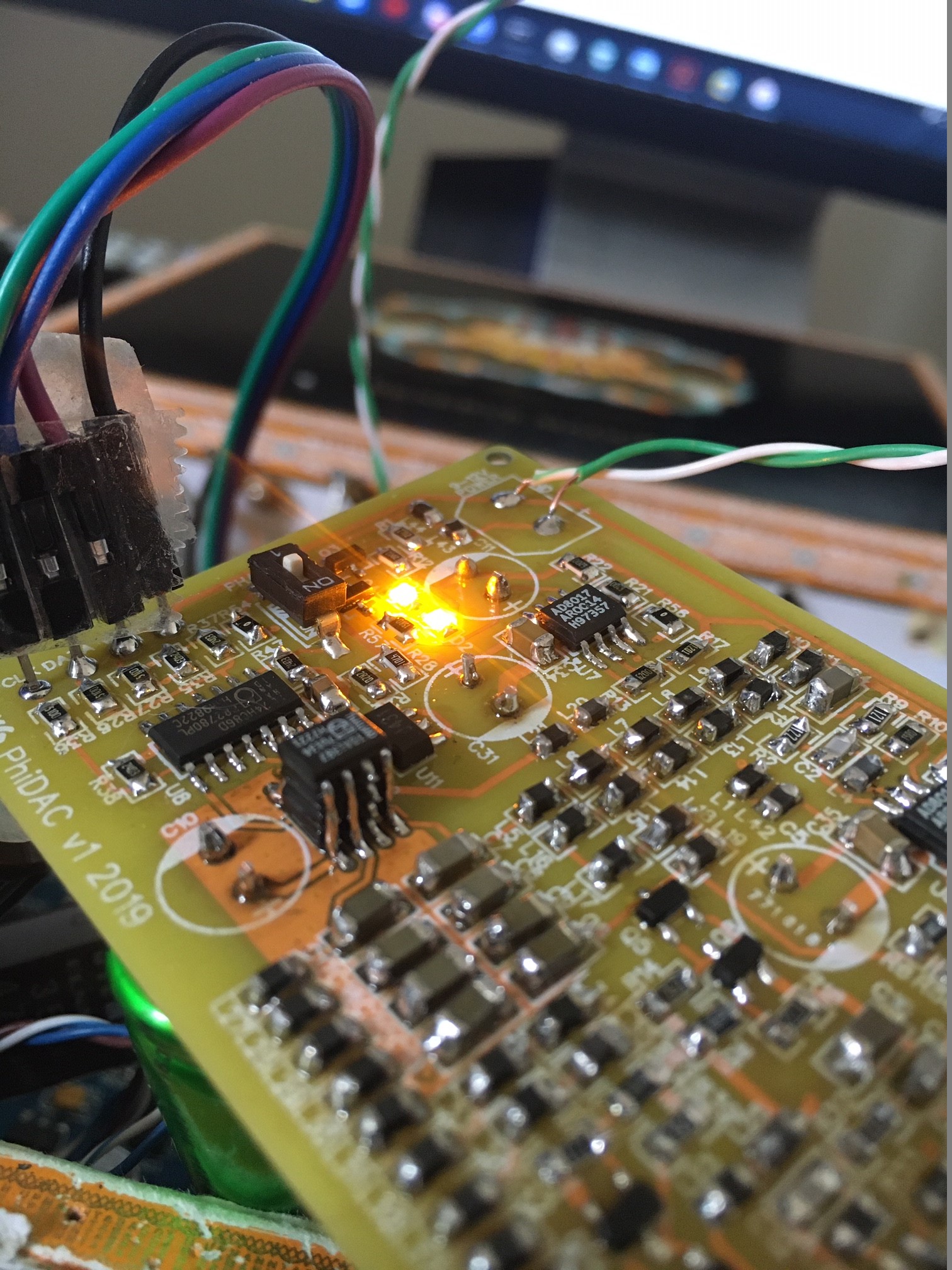

So I put the four-stack Phidac together and surprisingly it worked upon power up. Soldering those little sugar ants by hand is a full day event for a novice like me and soldering 4 dacs on top of each other was harder than I thought it would be. If it didn't work, I would not have had any clue where to look to see what was wrong, so Yay!

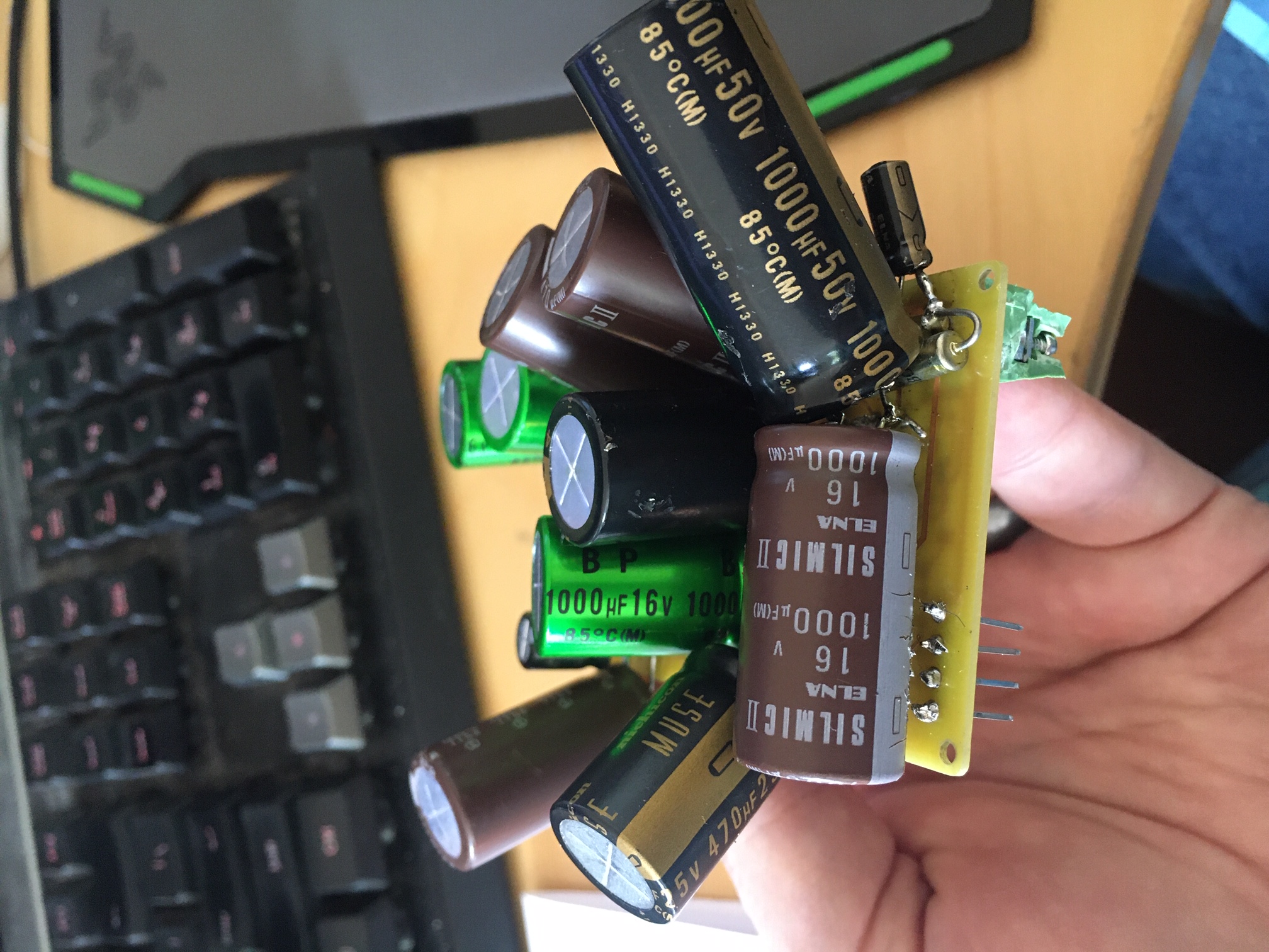

Right now I am using Muse Bipolar 1000uf on all electrolytic positions as they sound very neutral to me. This is a baseline to see how the Quad sounds before tuning it with other caps.

Now to start rolling the caps. My first Phidac was tuned to sound soo damn sexy. It is lush and warm and relaxing. I can listen to it all day without fatigue. The quad is not fatiguing either even though there is definitely better detail retrieval going on. I know this because I am hearing "new" things in recordings compared to the single chip version. As it currently is configured with the Muse caps it is not as lush in the midrange. I am pretty sure this is from the different caps that are on the original.

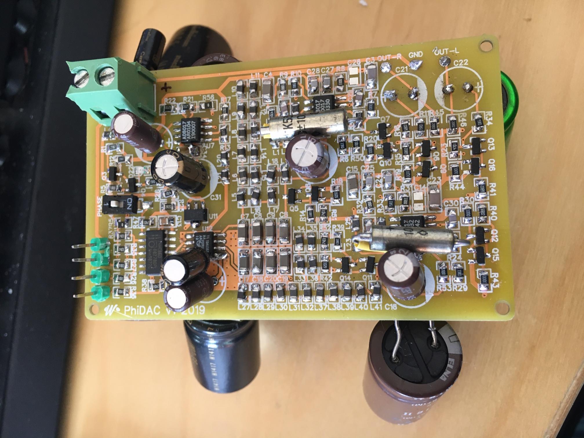

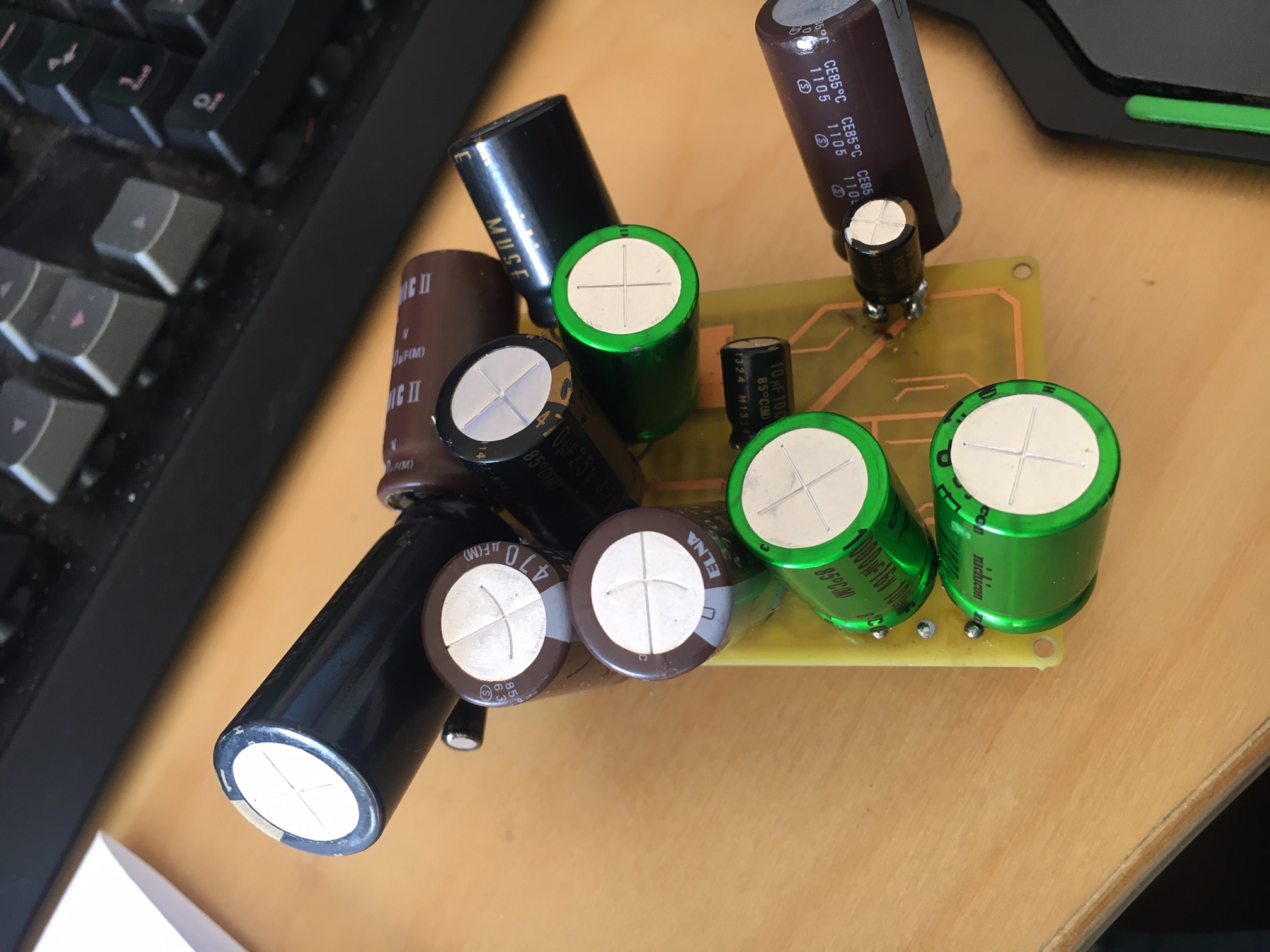

When I first put the original Phidac together, I was adding and removing and pairing (hats and pants) all kind of capacitors. The top end sounded soft and the bass while lovely needed help. After turning it into a ridiculous looking mess I had it sounding the best it could.
The top looks manageable but look at the bottom underneath.

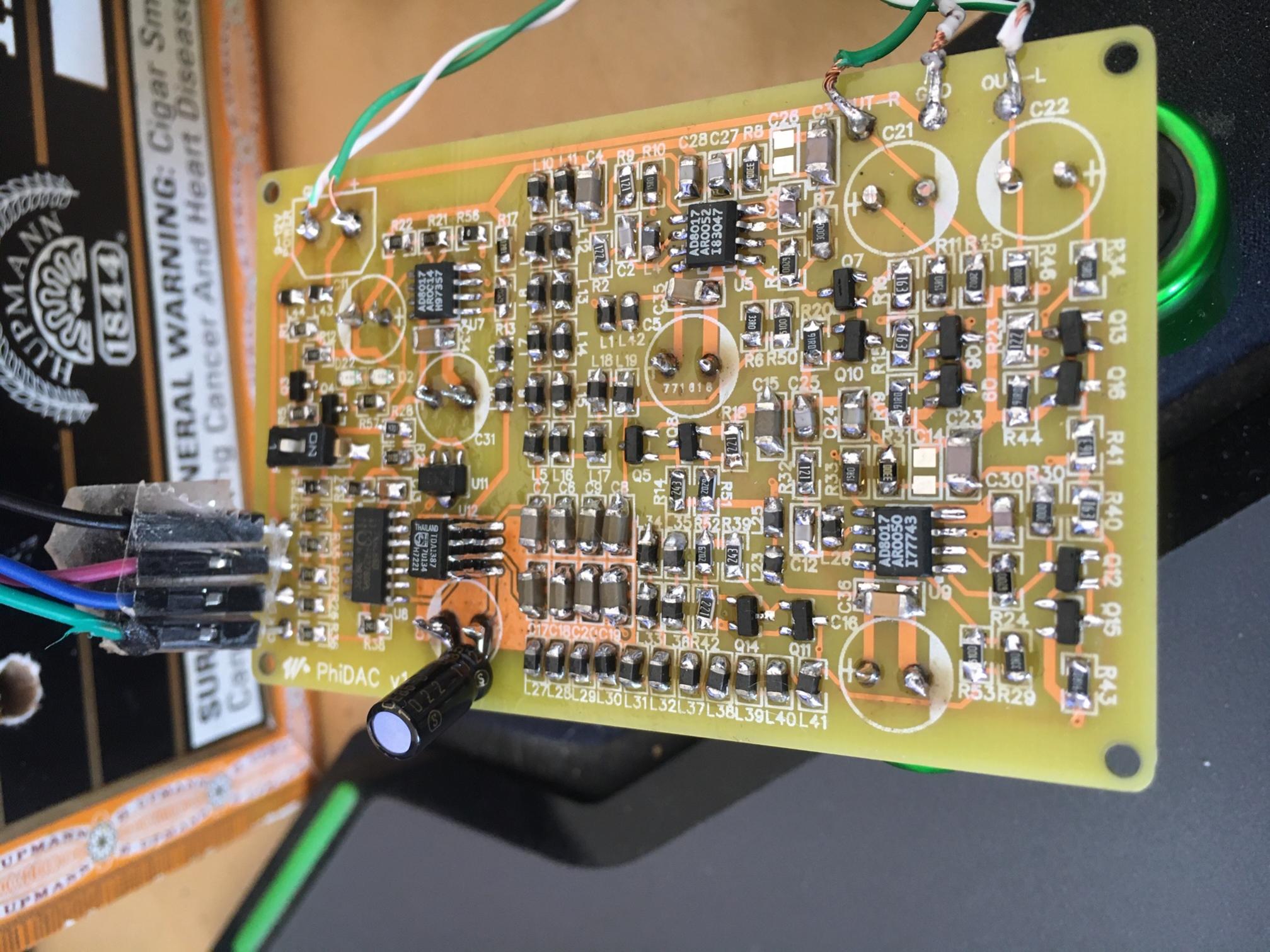

Now the Quad. I have spent all day listening, swapping, adding and came to the conclusion that it loves the Muse bipolars. 1000uf on all positions is all it takes. If anyone here has a better combo, let me know but nothing I have tried makes it better.
I am crediting the 4 DAC chips because this is the same board, same layout.

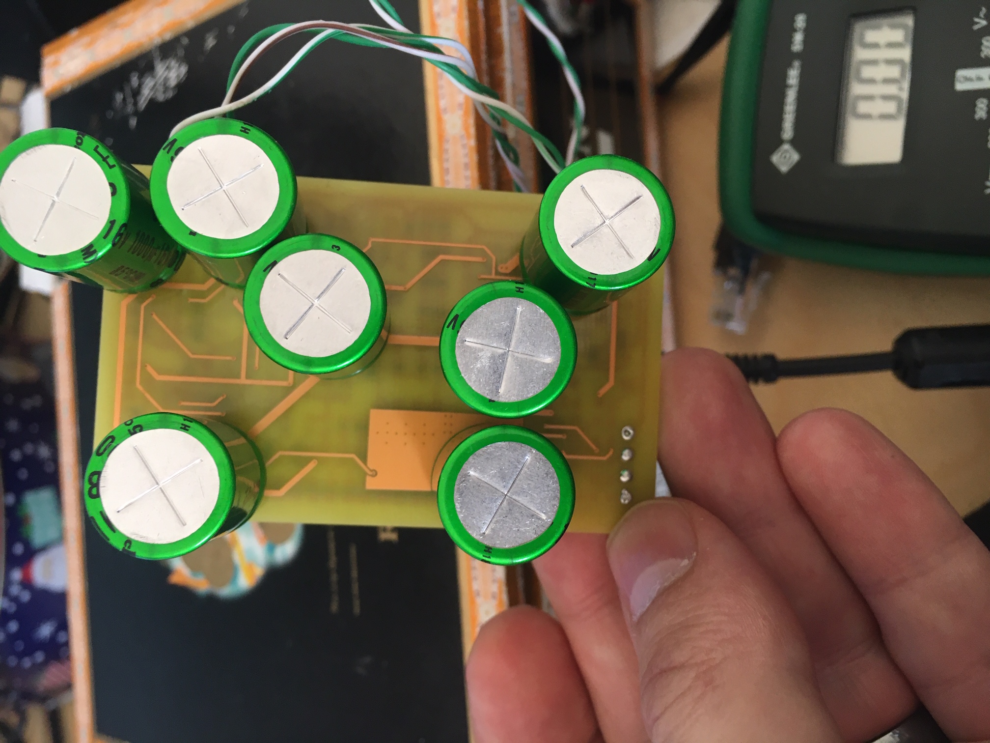

Also it looks clean with just the caps on the bottom.
I have one little Cerafine cap that I put on the top in this picture, which I have since removed. This setup is damn near perfect. I don't know what else to do to it.
