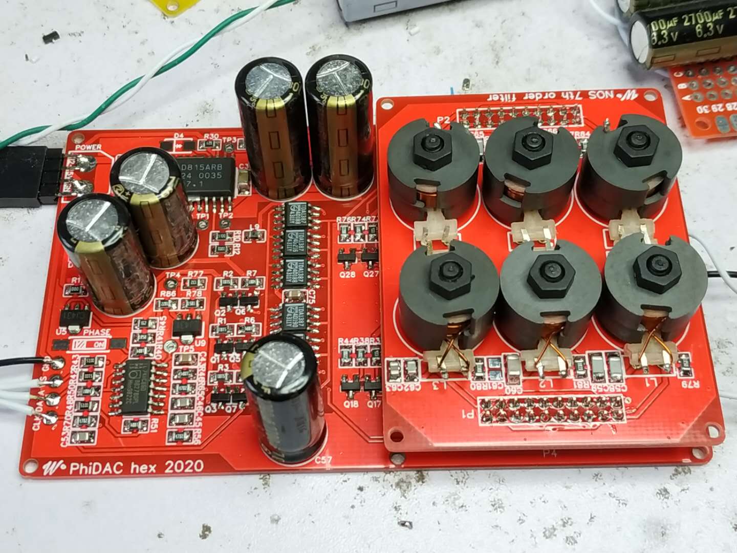

Here's a shot of the first completed prototype PhiDAC hex r1 which played music first time on switch on 🙂 I changed the colour of the nylon bolts through the inductor cores to closer match the sleeves of the 'lytics. What do you reckon - is black better than off-white?
The whole thing looks great. Black is better against the inductor core, creating an integral solid block look about the inductors themselves, as thereupon the whole of this board is more substantial looking. Otherwise, the dark inductors against the off-white nylon bolts creates a confused busy look generating an off-putting tension in the subconscious. Though one could ask "What does better mean?"
This version looks serious. The size of the inductors make it look like it means business. That is of course psychobabble but, it does look impressive. The real question is, how does it sound compared to the origial Lingdac and the the origial Phidac?
Have you experimented with adding extra DAC chips to your PhiDACs @pelopidas? You'll be able to get a flavour of how much improvement in the noise floor more chips brings.

I've turned my 2nd prototype PhiDAC hex into a 'DodecaDAC' - couldn't resist soldering on an extra layer of chips to get 12. The DAC chips need a reduction in supply voltage to achieve this result as there's otherwise more current than the I/V stage can reasonably handle. I've gone down to 2.35V supply for the TDA1387s and haven't noticed any SQ degradation nor measured any significant increase in distortion as a result of running the chips below their minimum.

And what did this do to the sound? 😉 by the way, I thought you mentioned in this thread that you will offer this as a kit (set of boards with components). Can you confirm if this is still your plan?
Too soon to say how, if at all, 12 chips is better than 6. It needs quite a bit of listening to tease out any way the SQ has changed. Initially I haven't noticed any difference.
