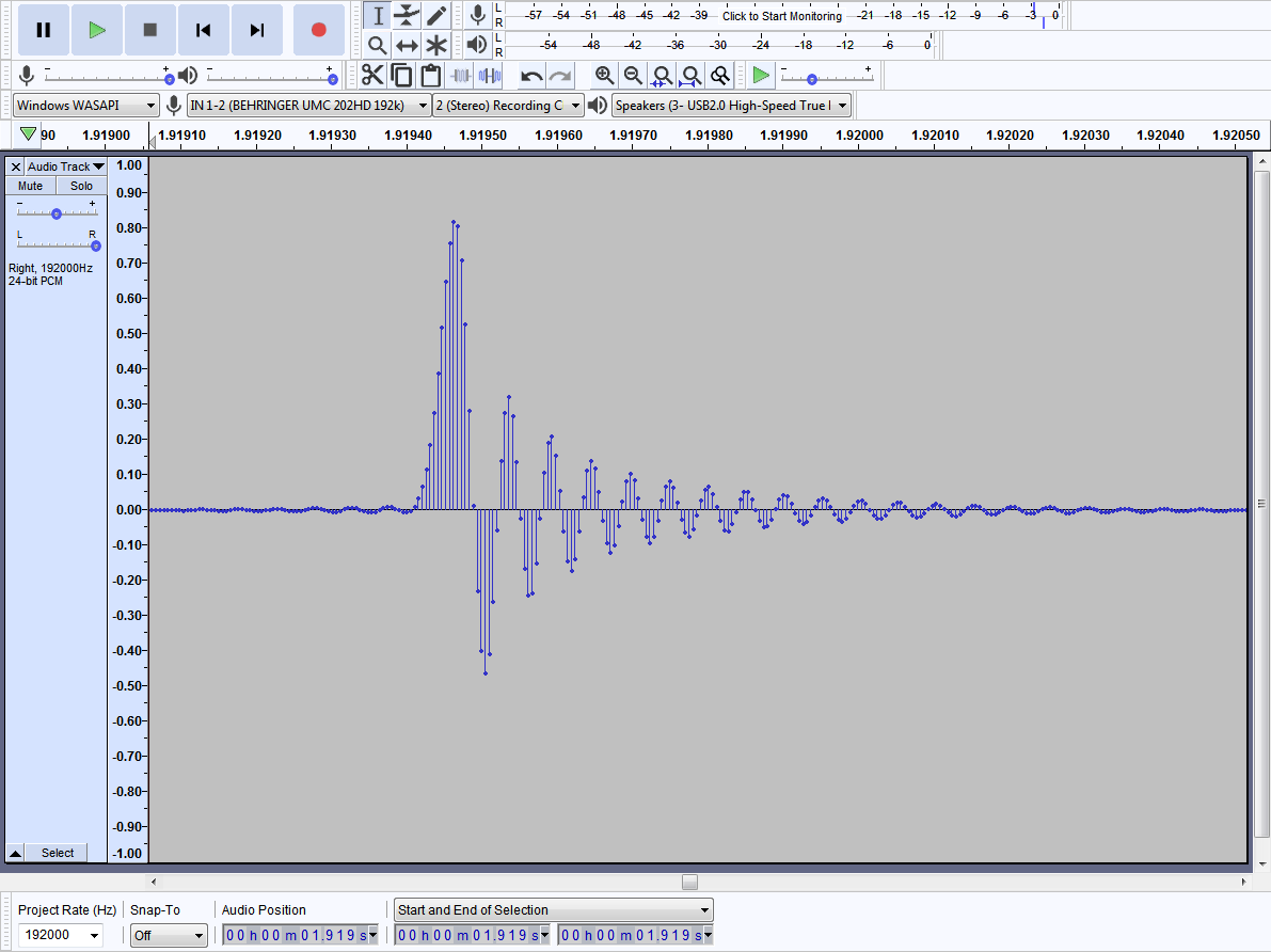

Two different filter responses
I made some measurements with two different analog filters in my DAC, stimulated by artificially created impulses. Based on the impulse responses, which sounds better?
Of course there's going to be a catch or no fun!
The two are the ones me and my wife compared a few posts back (one is the 1 inductor filter, the other is the 3 inductors one), I'm not saying which is which just yet but anyone with a modicum of knowledge about filters will be able to identify them from their impulse responses.

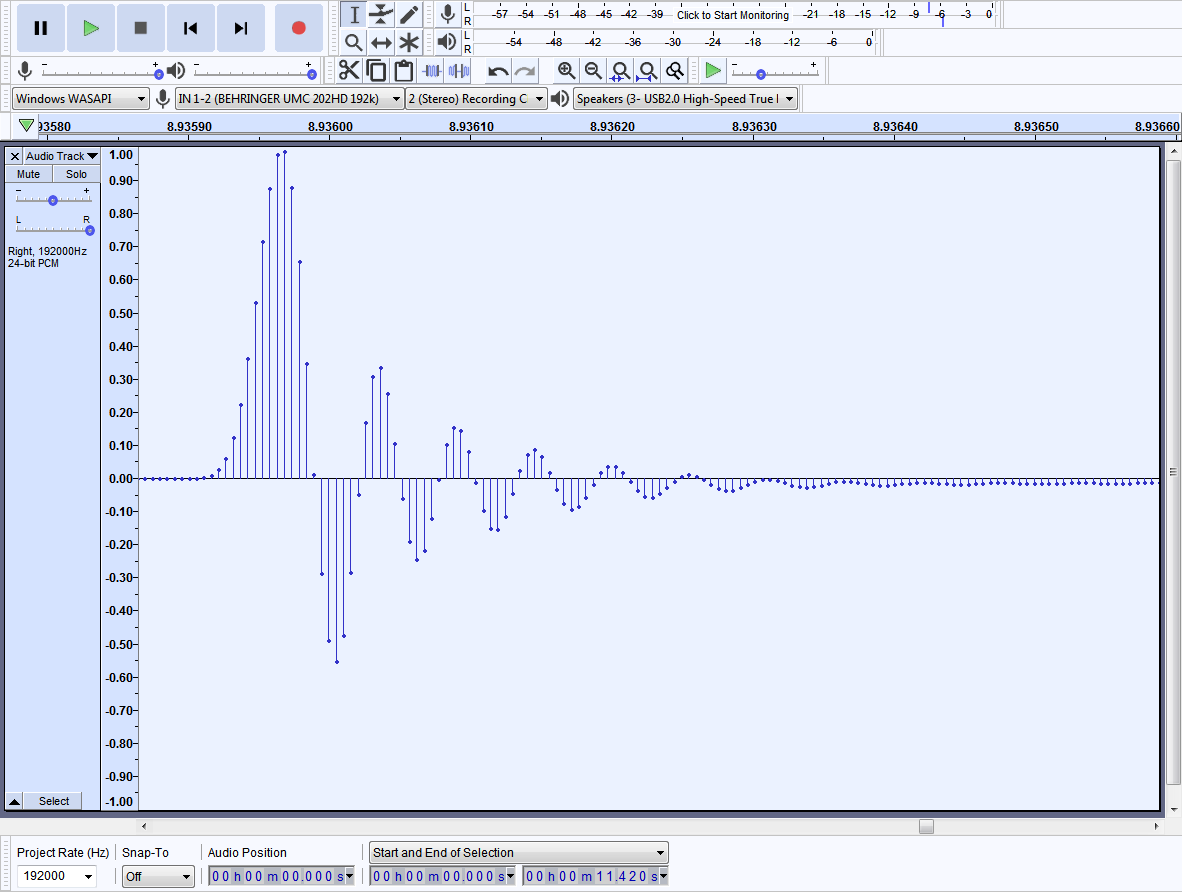

I've since made a recording of what happens when we run 2XOS with SoX providing the upsampling to 88k2. Compare this one (which has a digital filter as well as an analog one) with the two above, which are just analog filters (hence NOS).

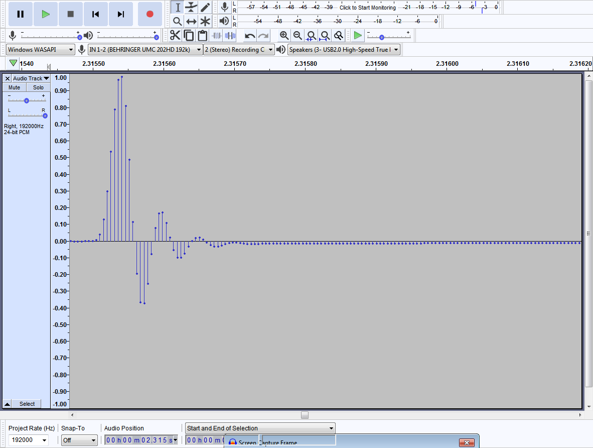

The response above was with SoX's 'Phase' slider set to hard left, meaning 0% (minimum). If you move that slider to the right, the ringing decreases and some pre-ringing becomes apparent. Here's what it looks like with the slider at 35%.

Incidentally, thanks for the 'feedback' on the filters. Anyone else willing to have a guess?
I'll bite. Impulse on the left is the single inductor filter, and on the right is the triple inductor filter. I feel pretty sure that you like the sound of the steeper filter best--since your experiments have led in that direction for a while 🙂

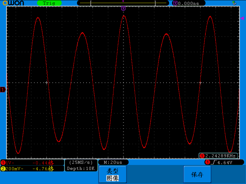

Can we also play this game with some 18KHz sine waves?
Yep, you're right on the money. The steeper filter has more ringing and sounds better than the shallower one with less ringing. Which is the 'catch' so perceptively identified by @bozoc.
I'll do those 18kHz sinewave captures in a short while. Yes there's definitely a difference, based on when I've done this with earlier incarnations of my DACs.

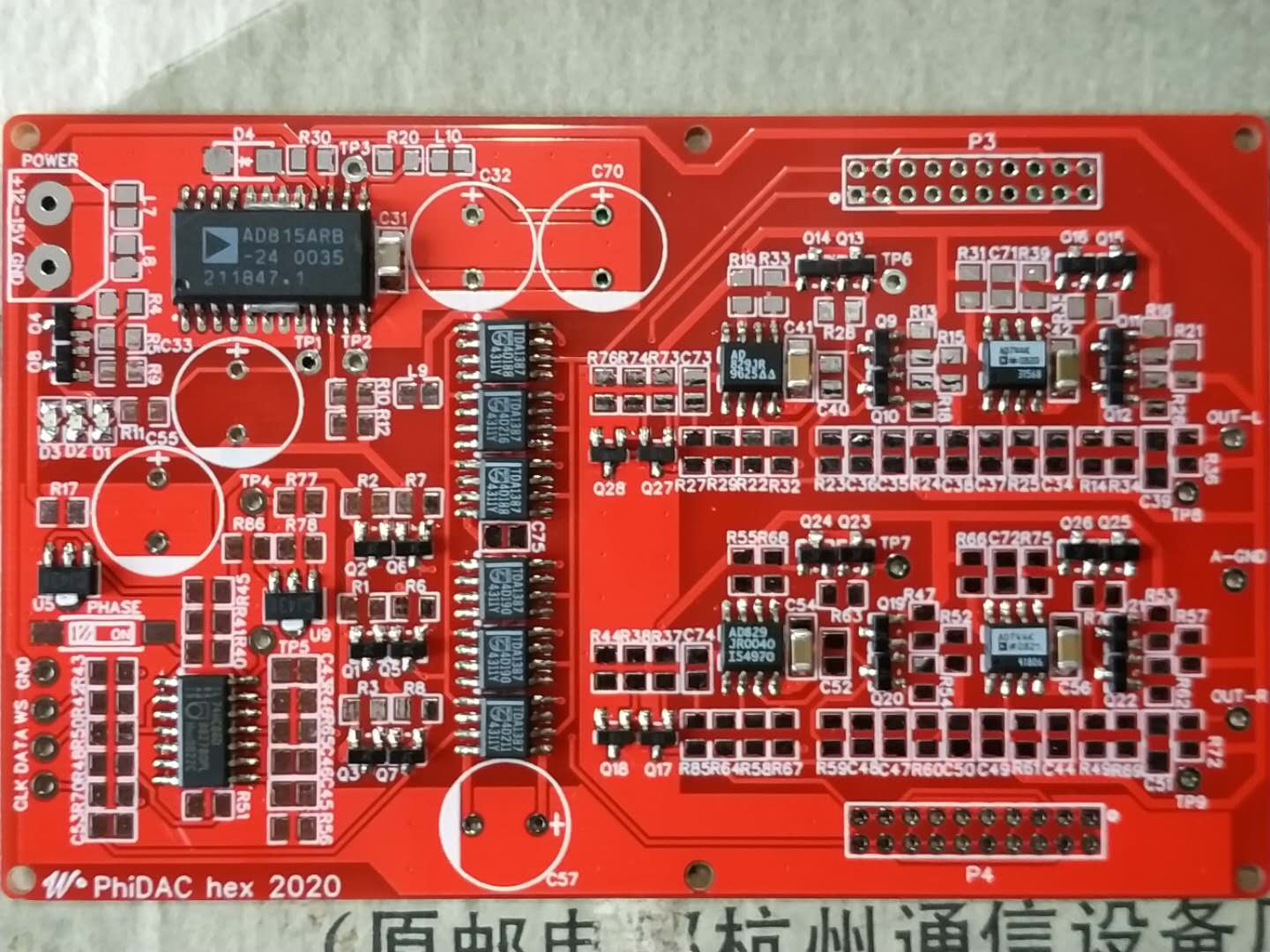

New PCBs arrived
First rev1 prototype taking shape...
I do this in a couple of stages so as to minimize the potential losses should something go wrong. The power supply circuits are the first to be powered up but they're not initially connected to the opamps and DACs - ferrite beads in the power rail aren't fitted. Then if there's a serious fault the consequences are limited. Once the power supplies are checked good with a DMM then I'll connect them up to the filter-I/V stages.
