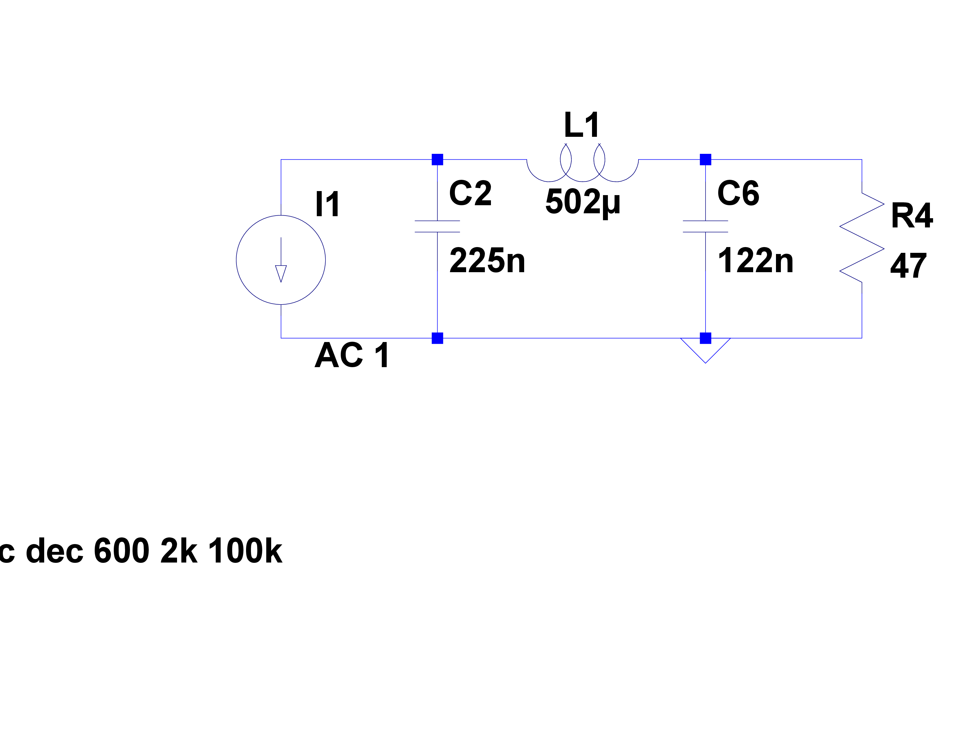

The industrial-looking filter might turn out to be overkill, we shall see 🙂
I built a one-inductor filter which copies fairly closely the response of the filter on the original PhiDAC (CLC) - its a little different in one capacitor value because the inductor's higher Q. I was curious to see if the extra effort of those two additional LC stages was really worth it. My wife did a listen on a few music samples and definitely preferred the more complex filter - it had 'better dynamics, more low level detail apparent'. To my ears the 3 inductor filter renders the higher notes of piano more faithfully, they're 'jangly' with the single inductor filter. For those who wish to save on the BOM cost though, the schematic of the single inductor filter's attached.
The next experiment in line is to compare NOS against 2XOS, with their dedicated filters.....

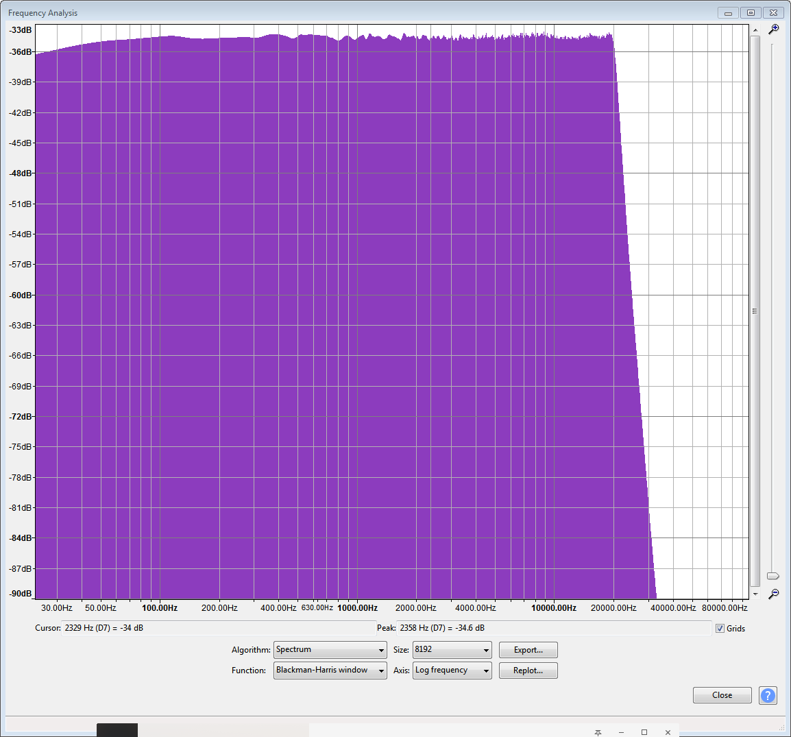

Frequency response measurement
Here's the FR plot for the 2XOS filter. The source is Foobar playing a 44.1kHz white noise track created in Audacity - its upsampled in Foobar by SoX to 88k2. The plot comes from Audacity which I used to record the output (at 192k) - stop band visibility is curtailed by Audacity's lower display limit of -90dB.
Note that to run at 88k2 the active filter - which provides the NOS droop correction - needs some R,C value tweaking to correct for 2XOS droop. 2XOS droop is much less severe (0.75dB @ 20kHz) than NOS droop (~3dB @ 20kHz).
Impressive result. It starts dropping fast slightly just before 20kHz, but at 30khz (where a plot is crossing vertical line) there is nearly 47dB difference.
I am looking forward for your listening test of NOS vs. 2xOS filter version.

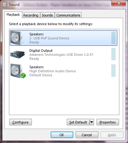

If using SoX as a Foobar plug in (as I do) its important to note that merely selecting the output sample rate in SoX doesn't change the hardware settings. The hardware (on mine its the CM6631 USB interface) needs to have its sample rate selected independently from SoX/Foobar to enable output at 88.2kHz. Hardware changes are made via the Sound - Playback tab, Properties button (assuming Windows here).

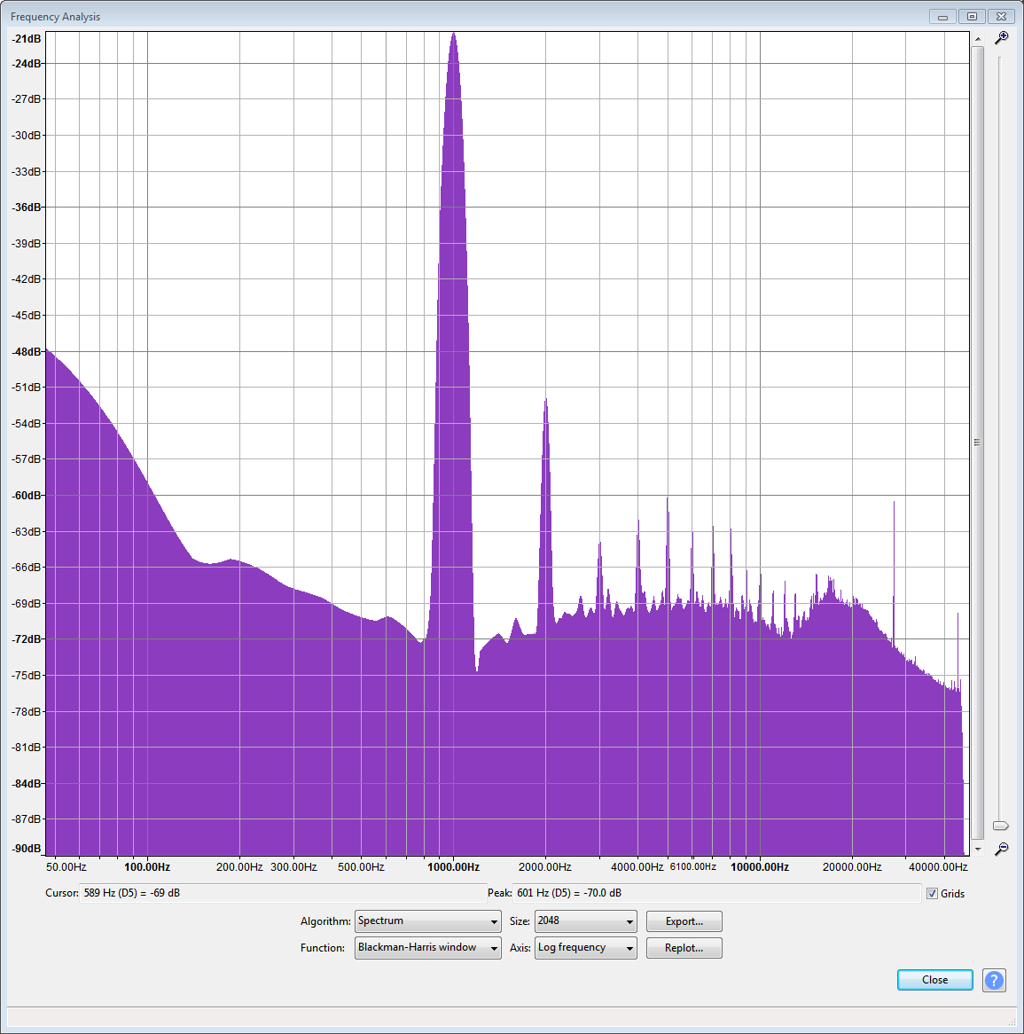

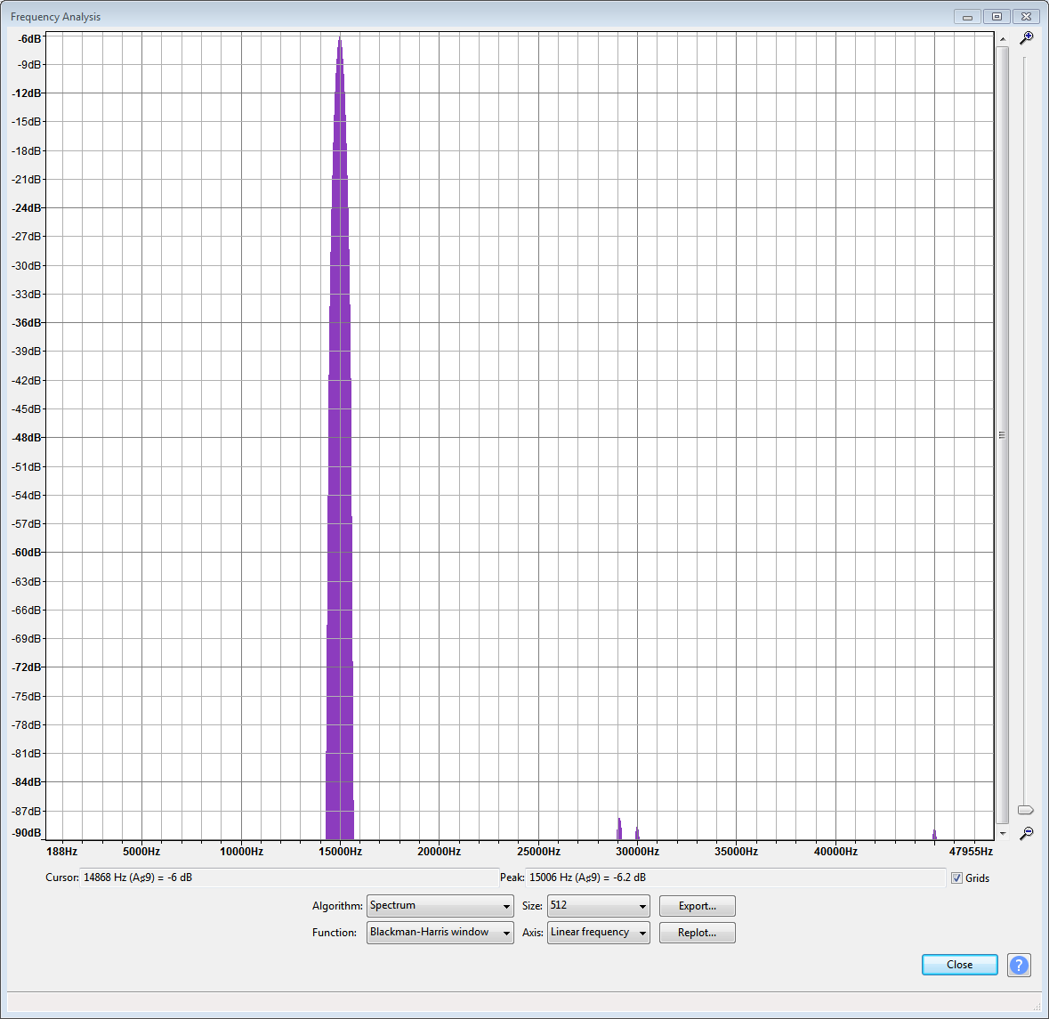

High frequency distortion/imaging
Here's a look at out-of-band output from the NOS filter. The stimulus signal is 15kHz playing out at 44.1kHz from Foobar. The lowest image frequency of 15kHz is 29.1kHz - it shows up here around the same level as the 2nd harmonic distortion (at 30kHz).

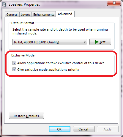

If this settings in Windows does matter to you, it is indication of outputing audio through the Windows Direct Sound mixer. By using DS mixer you can ruin your listening tests and measurements, it is why it is important.
With Foobar there are two cases where it can happen:
1. You have selected in Foobar output DS:[your driver name], not a WASAPI:[your driver name] nor ASIO:[your driver name]. Select one of these two.
2. You did select WASAPI output in Foobar, but you didn't give application exclusive access in Windows sound properties. My Foobar complains in such case.

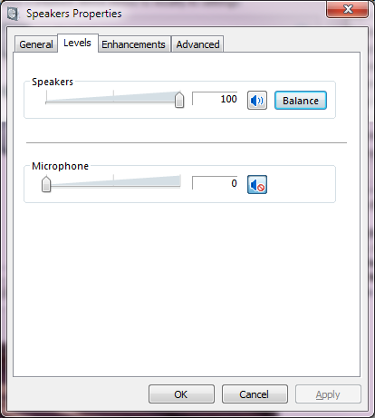

A proper Windows configuration for WASAPI is as below, example with pictures on Win7 :
1. Properties for your driver.
2. Volume 100% and balance 100%.
-. Disable all enhancements, next tab (no picture)
3. Exclusive mode and priority.
When all is set and application wants to use WASAPI exclusive mode (Foobar does), Windows setting for sample rate and bit depth (the last picture) do not matter.

THD 1kHz
Here's the 1kHz distortion plot for the PhiDAC Quad with NOS filter. To get this plot I applied a Q=3 notch filter at 1kHz to allow me to amplify the harmonics which otherwise wouldn't show up on Audacity's FFT being as they're below -90dB. The applied gain after the notching is 40dB so the 2nd harmonic level is -91.7dB (add -40dB to the left scale) and the others are beneath that.
