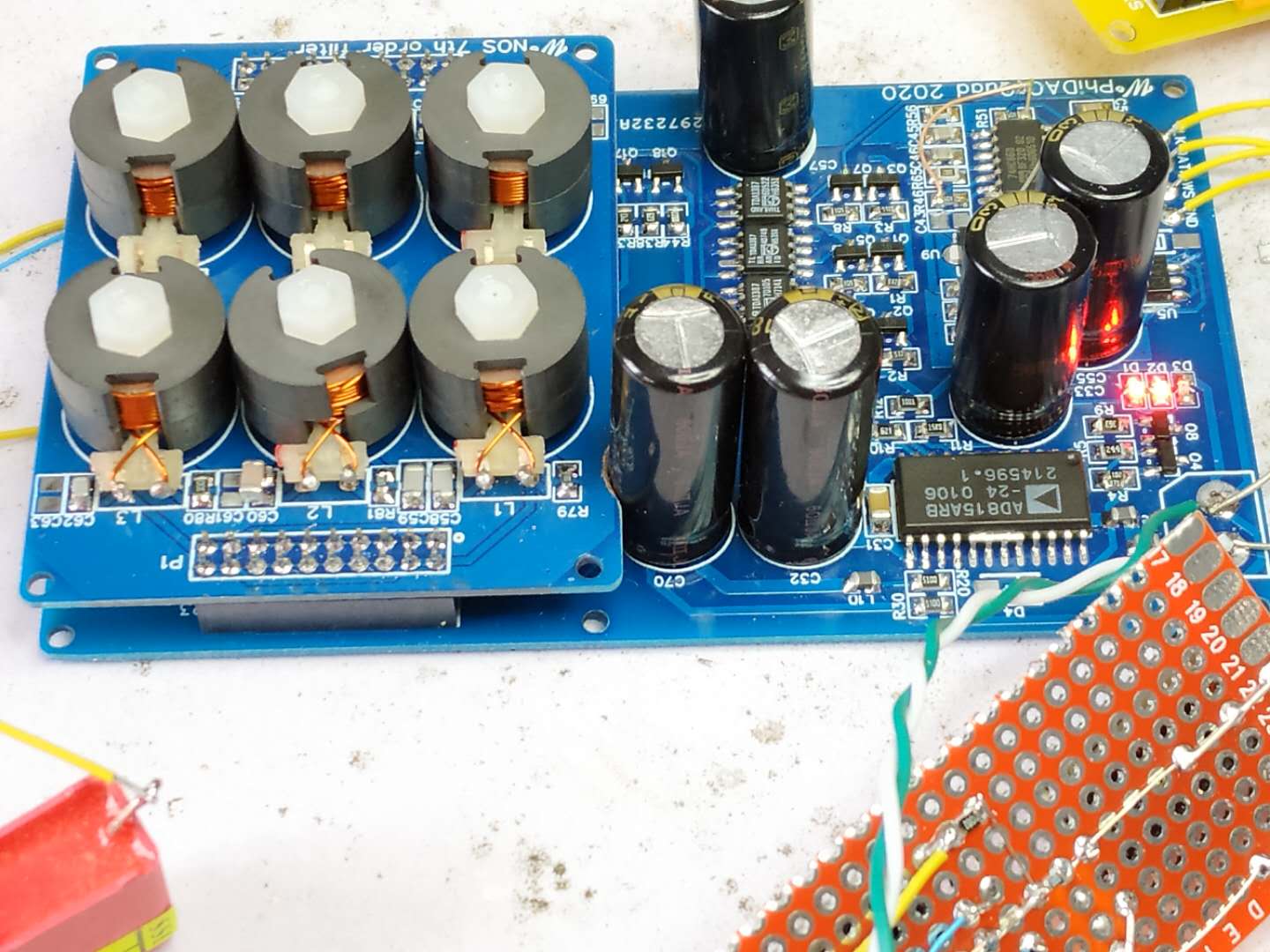

I'm pleased to report I have now gotten the first prototype singing. I found my first suspect AD829 in this build having soldered down a few dozen already. I may have to change one of the red LEDs to an IR LED to get the reference voltage into the right region, its at present too high with 3 red ones. I also need to figure out a way to make debugging a bit easier - with the filter in place the analog parts are too hard to probe. Some test points on the bottom might resolve this. Now to build up a few more and try a few tweaks.....

Hi Luke
Happy to talk you through the stages of the design, then if you have any detailed questions I'll have a go at answering them.
I2S inputs come in to U4 which buffers them so the outputs are 0-2.5V. The signals are then level shifted as the DAC chips 0V pins aren't at circuit ground. Level shifting is done by running constant current (from Q1-Q7 ex Q4) sources through resistors (R56,R65,R7) which act as floating voltage sources thus adding about 3V to each signal.
Output from the 4 paralleled DAC chips is paralleled and fed into the LC filter which is on a daughter board. This filter implements a sharp cut-off frequency around 18kHz and rejects by 60dB or so all frequencies above 27kHz. Its output is loaded by R29 (for L channel) and then into an I/V converter which is U2. External PNP transistors form its output stage, bypassing the internal one. The final stage of the DAC is a 3rd order MFB (multi-feedback) low-pass filter which gives a boost to higher frequencies (approx 3dB at 18kHz) to counteract the 'NOS droop'. That's built out of U3 (AD744) which also has a classA external OPS made from discrete PNP transistors. The idea of these discrete OPSs is they draw a constant current from the positive supply and hence don't create supply noise which is correlated with the signal as classAB OPSs do.
Power supplies for the DAC chips and opamps are created by the AD815 which uses as its reference the string of 3 red LEDs to give around 5V.
Overall the design is the same as the original PhiDAC in architecture, just some different implementation details.
thanks for the explanation abraxalito, It was confusing because I thought that P1-P4 were chips, i think they are are a connector. I also didn't know why there was a filter at the output, never heard of NOS droop, do all NOS dacs suffer this?

@stellarelephant - good to see you again on the thread Kevin. Yeah the larger board saves time in interconnection even though the form factor doesn't look quite as cute. The industrial-looking filter might turn out to be overkill, we shall see
