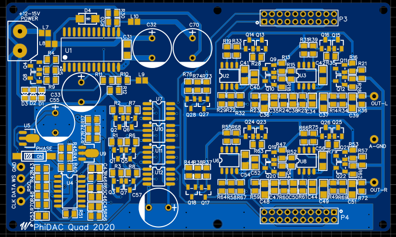

PCB layout of the PhiDAC Quad is well advanced into the routing stage so I think will be done by the end of the week. I'll post up the schematic soon.
First off schematic for PhiDAC Quad
Just for a sneak preview, here's the schematic of the first prototype PhiDAC Quad. Doubtless there will be changes to this once a few boards get built - the PCB is going off to manufacture within a day.
Significant changes vis-a-vis original PhiDAC are that the 4 DACs now are now sitting on an offset of ~3V to get their outputs to sit comfortably at mid-rail (~5V or ~2V relative to DAC GND). Neither the AD829s nor AD744s can run at such a low supply voltage as the AD8017s which necessitates this change. Level shifting is done by current sources and resistors. The opamps are augmented by darlington buffers running single-ended classA rather than relying on their internal classAB OPSs. The passive filter (on a daughter board) now is using custom wound P14 ferrite cores and has a steeper slope with rejection in the stop band better than 60dB (in theory at least).

I2S inputs come in to U4 which buffers them so the outputs are 0-2.5V. The signals are then level shifted as the DAC chips 0V pins aren't at circuit ground. Level shifting is done by running constant current (from Q1-Q7 ex Q4) sources through resistors (R56,R65,R7) which act as floating voltage sources thus adding about 3V to each signal.
Output from the 4 paralleled DAC chips is paralleled and fed into the LC filter which is on a daughter board. This filter implements a sharp cut-off frequency around 18kHz and rejects by 60dB or so all frequencies above 27kHz. Its output is loaded by R29 (for L channel) and then into an I/V converter which is U2. External PNP transistors form its output stage, bypassing the internal one. The final stage of the DAC is a 3rd order MFB (multi-feedback) low-pass filter which gives a boost to higher frequencies (approx 3dB at 18kHz) to counteract the 'NOS droop'. That's built out of U3 (AD744) which also has a classA external OPS made from discrete PNP transistors. The idea of these discrete OPSs is they draw a constant current from the positive supply and hence don't create supply noise which is correlated with the signal as classAB OPSs do.
Power supplies for the DAC chips and opamps are created by the AD815 which uses as its reference the string of 3 red LEDs to give around 5V.
Overall the design is the same as the original PhiDAC in architecture, just some different implementation details.

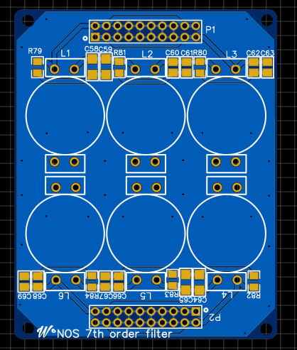

Passive filter daughter board
Here's the PCB rendering of the filter board. The bulk of the capacitors making up the filter are on the reverse side.

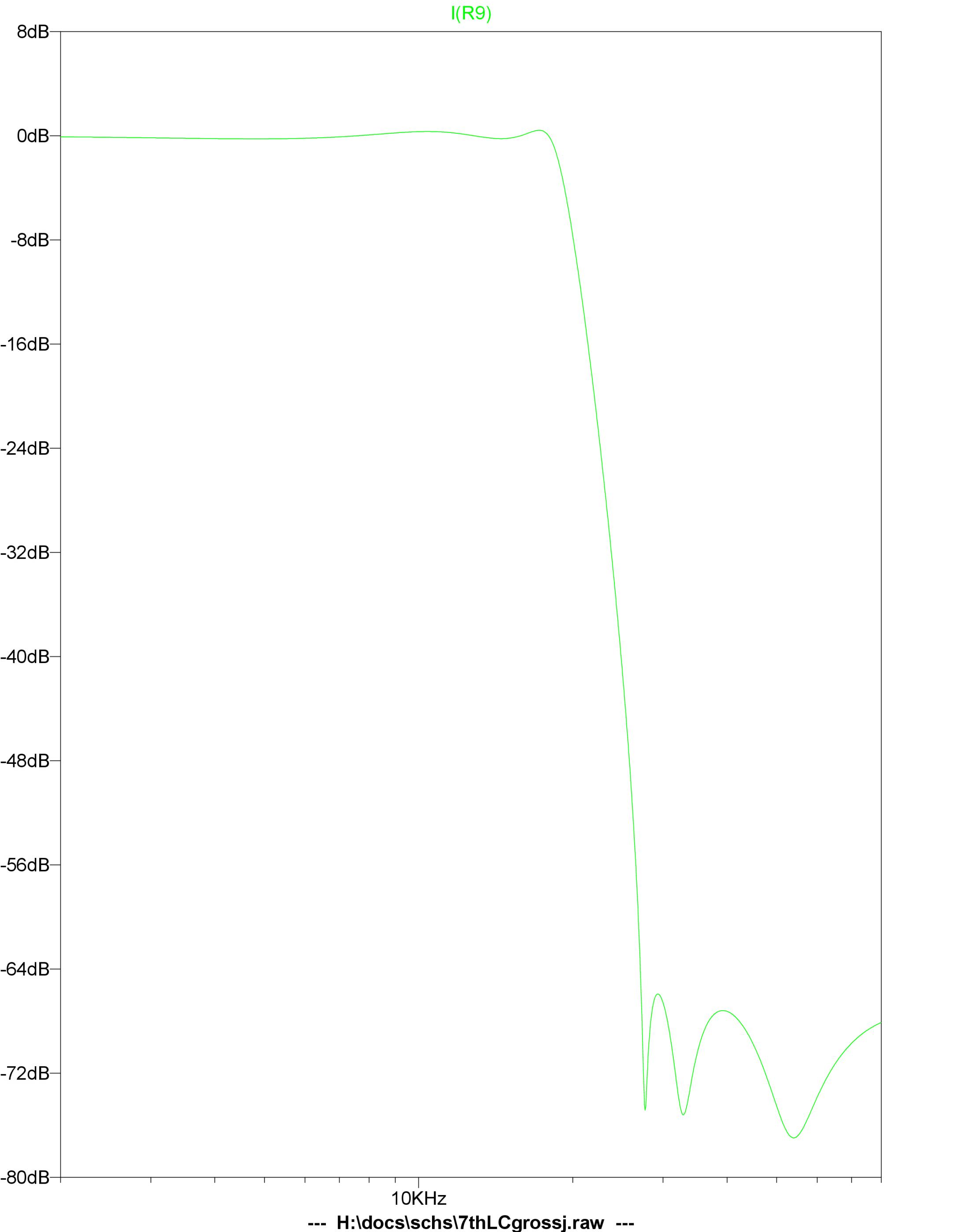

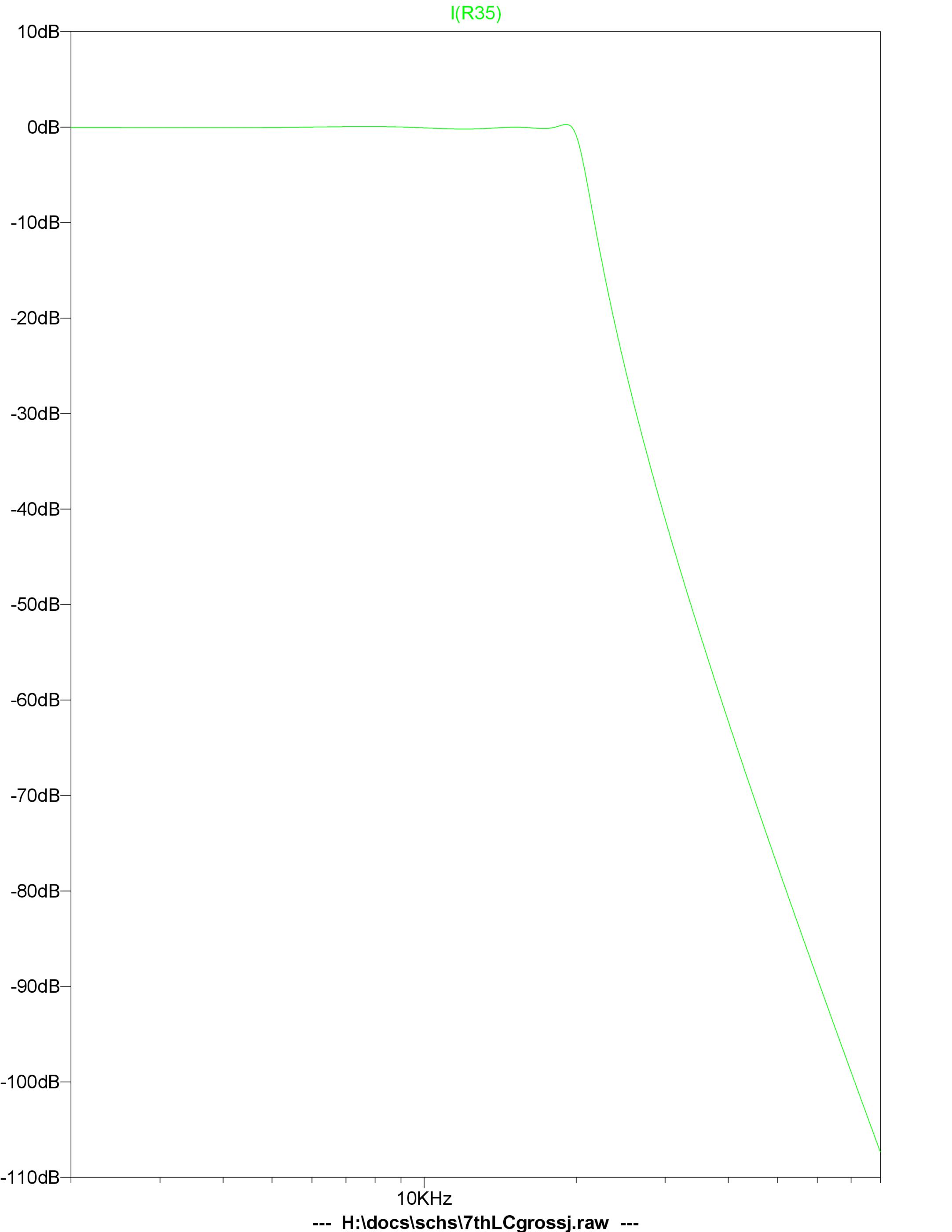

Also here is the FR plot (from LTspice) for the NOS filter. If some end-users were going to use 2X oversampling to drive their PhiDAC Quad then a different filter design may well be more appropriate as with 2X OS (running at 88.2kHz) there's no need for such a steep slope as images won't begin until 68.2kHz. In giving up some steepness, deeper stop-band rejection can be achieved as in the second FR plot. 2XOS allows a 'textbook' response where rejection at 68.2kHz and beyond can be >96dB.

Textbook is suppression of images by filtering at Fs/2. In your basic implementation, it's only 25-30 dB down and your second filter don't help here - right? And for Fs 88,2 the "textbook frequency" is not 68,2, its 44,1 - no? So ~70 dB down. There will be imaging distorsion in this DAC but the question is if it's less bad than the impact of a steep digital filter. I believe you think so or you wouldn't build it like this!?
Will you publish measurements?
The NOS implementation suppresses the lowest possible image (24.1kHz) by around 30dB and higher frequencies by more. So yes there's imaging distortion in this DAC, it will typically be around 0.05%. In the 'textbook' version with 2XOS the imaging distortion will be below the DAC's quantization noise.
I'm not following your math @TNT - to find the first (lowest) image frequency, subtract the highest audio frequency from the sample rate. At 44.1kHz its 44100-20000 = 24100. At 88.2kHz its 88200-20000 = 68200.
Happy to show measurements when I have a prototype up and running though they won't be comprehensive ones as I have no AP or equivalent equipment. Just a USB ADC.
I'm not one of those guys incidentally who thinks imaging distortion is preferable to a steep roll-off filter. I'm building it without a digital filter because I can't see a way to add one while keeping the design cheap and yet robust. An ARM chip can do the job but I'm not experienced enough yet with their foibles to put a design using one out for public consumption. Adding firmware to a hardware design increases the complexity considerably. Hopefully I'll get there eventually though.
