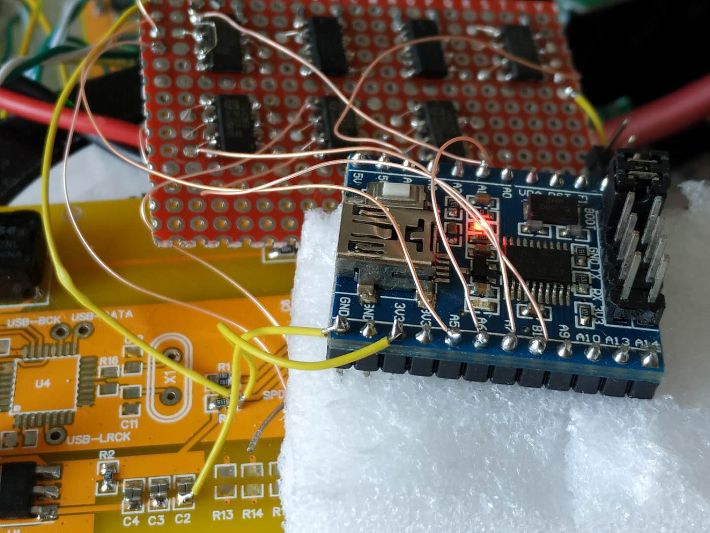

Incidentally, here's the first incarnation of the I2S slower. There's an S/PDIF interface (yellow PCB underneath), the interface logic from I2S to SPI (on the red board) and the Taobao F030 module (blue). My wife listened to the effect on both GrossDAC and PhiDAC Quad - she said it lost some rhythmic drive (but gained some kind of druggy floatiness) on PhiDAC but didn't notice the former effect on GrossDAC.
Today I'm going to re-write the software for the new CPU which has one real I2S interface, its only half-duplex though so the SPI interface is still needed for input. I think it won't need as many logic ICs though overall.

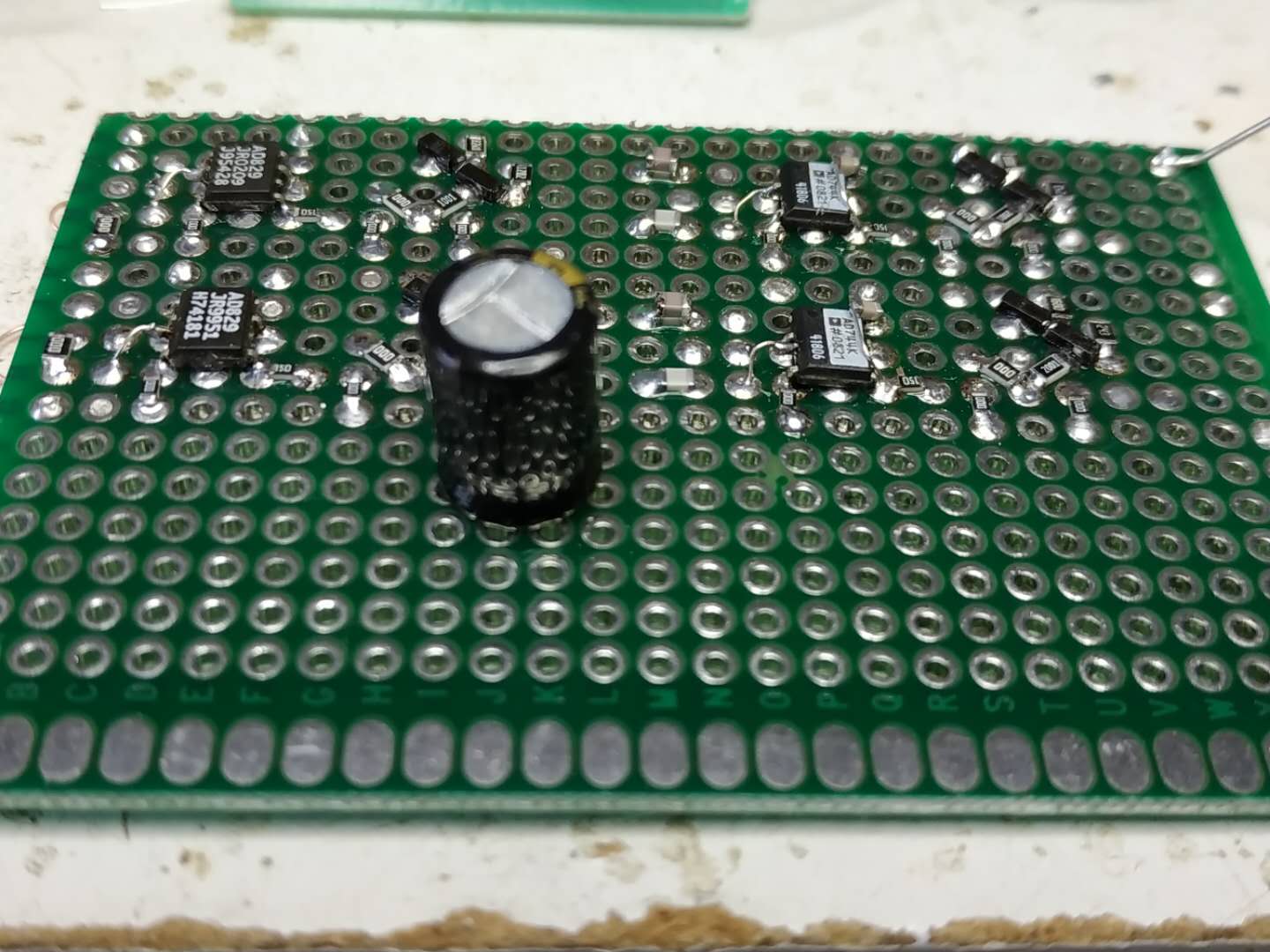

2nd generation prototype for PhiDAC Quad
I've been hunched over my soldering for the past couple of days building up an idea I had for improving on PhiDAC SE. I really want to get rid of all the extra caps in that design, but how to get the circuit to be less susceptible to supply noise without them?
My leading hypothesis is that the supply noise is as a result of the classAB output stage of the opamps - I've been curious to see whether if the output stage of an opamp can be disabled or bypassed, whether the supply susceptibility is reduced. The JFET input AD744 has internal pins brought out (thank you Scott Wurcer!) for compensation caps but they can just as easily be used to feed an external classA OPS. So that's what I've implemented on the prototype board in the picture (the red matrix board at the top). Trouble is, the JFETs are a lot noisier than the input stage of the AD8017 so I decided to parallel stages to reduce that - in this case 6 opamps are paralleled - I might try more later. Recycled AD744s are quite affordable on Taobao which is what makes this idea a practical proposition. Initial listening is promising indeed but I want to spend more time with it before making a decision on this. Besides that, my wife needs to approve and the first gash proto using AD744s didn't go down too well.....
The inductors I found a few weeks back turn out not to be available from any Taobao seller at present - they're saying next month but who knows if that's just seller bluster? So for the time being I'll design with the P14s that are shown in the photo, mounted on a daughter board.
I managed to simplify the IV circuit through discovery of a low-noise bipolar IPS opamp whose OPS was also bypassable - AD829. This chip is even cheaper than AD744 on Taobao and I only need one per channel which saves considerable real-estate on the PCB. Listening is still on-going but sounding quite promising to my ears. The AD744 is still the best choice for the second (active filter) stage as it allows a higher working impedance, meaning smaller (read cheaper) caps.
