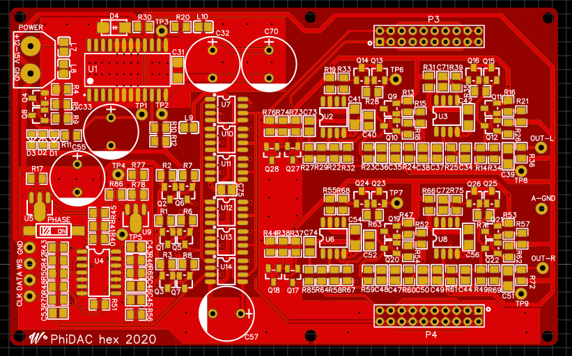

Back to DACs - the PCB has gone out to manufacture now and here's a snapshot - in red this time around 🙂
(*) on second thoughts, @Hollowman is an exception.
I know it does not really matter, but I do love the symmetry on the board. Very nice layout.
I do have a component question though. Does the selection of the BC856B matter much? I see that the average is 100-200mw and 100mhz. I found this one BC856B-13-F Diodes Incorporated | Mouser
that has double those values. If I were selecting custom components would this have any benefit, would it have no influence or would it be detrimental?
The transistors aren't very critical in terms of gain selection (that's the A/B/C after the number). I specified B because that's what I have to hand here but A and C would work equally well. I just checked Mouser and the C grade is cheapest by a whisker so by all means use that one. BC856, BC857 or BC858 will all work fine as they only differ on breakdown voltage and all have more than enough voltage capability to work at 10V.
