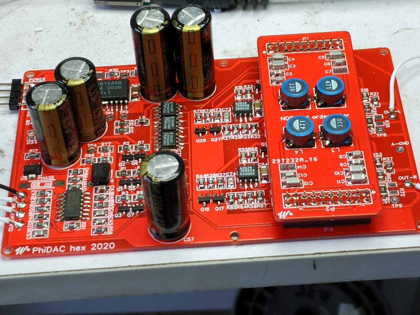

I am only wondering why there is a ground plane joining for both channel on the filter board. Is it intentional?
Are you asking why there's only one groundfill when there are two audio channels? If so then I can't see a reason to split the groundfill - if you know of a good one, please share.

One groundfill for two channels is a good practice, but pin connectors do not extend groundfill very well. In result we have two groundfills: one on the main board and a second on the filterboard. It is why I think that separating a ground on the filter board may be helping not spreading current peaks. As per your quote: "We shall not grow wiser before we learn that much that we have done was very foolish - F.A. von Hayek"Are you asking why there's only one groundfill when there are two audio channels? If so then I can't see a reason to split the groundfill - if you know of a good one, please share.
Yes that's unavoidable when going via connectors. I'm using a lot of pins in parallel though to mitigate it.
I'm not following you.

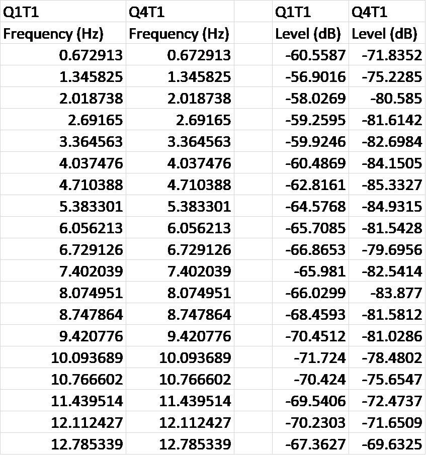

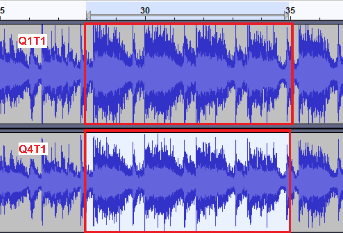

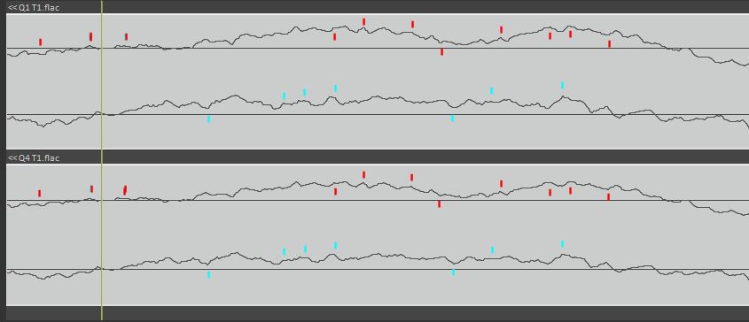

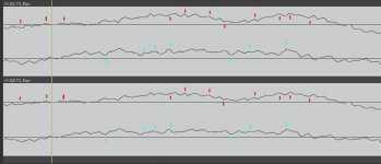

I did a bit of comparison as well with Winamp and used the Plot spectrum analysis.
The frequencies remain the same across Q1 and Q4, what changes is the Level (dB)
Attached some screen shots
