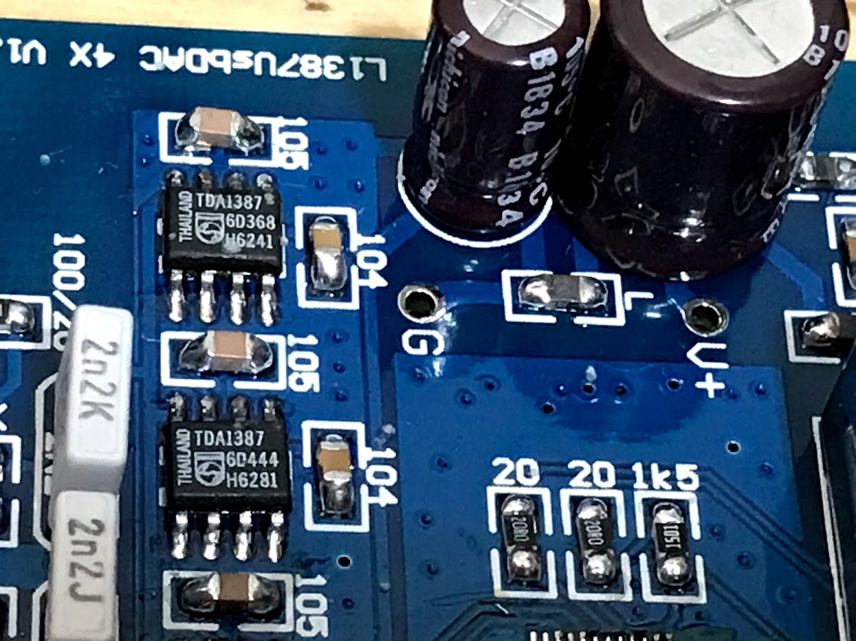

Dunno.... I see many 4x or 8x TDA1387 Chinese DACs using either 12.000 or 50.000 Mhz. Not sure why THOSE two freqs are used.

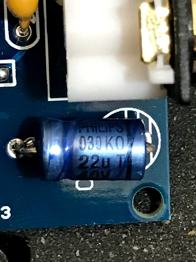

(Note the use of the Philips electro cap on the output. Haven't seen those in decades. New-old-stock? Does Philips still manuf. them. Or are they being "duped" by some Chinese manuf?

<edit> The quad-TDA1387 DAC whose pictures you're showing above is a gem of a DAC. I've bought maybe ten of these - some as kits, some just as assembled PCBs and some with boxes. They're really great and even work with a mobile phone as a source. Mods are only limited by the diminutive size of the thing. The 12MHz XTAL is needed for the CM108 interface chip to provide signal USB timing, its nothing to do with the audio sample rate.

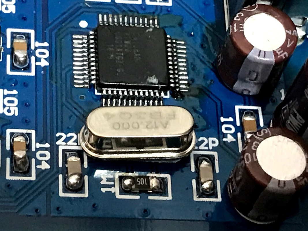

I suppose I should break out the 'scope to measure what freq. is being pumped to the 1387's clock line (via CM108 ). Unless you've already done that and can prove a clue?

As for what comes out of CM108, I've only ever replayed 44k1 material through it so have only seen 2.82MHz on the bit clock.

As far as the CM108, I just looked at its datasheet:
5 DAMCLK DO, 4mA, SR 11.2896 MHz Output for 44.1KHz Sampled Data and 12.288MHz for 48KHz Sampled Data
TDA1387s don't have any use for such a clock (256fs). S-D DACs may very well do though, I guess they don't want to limit their applications just to multibit DACs.

@KHashmi316. In the board you have linked (4xTDA1387) you can expect working sampling rates 44.1kHz and 48kHz, as CM108 is oversampling x4 and you have to feed it with 16-bits, as 24-bits is not accepted. In the PhiDAC there is no USB/I2s interface, so you can plug anything you like and a sample rates accepted by TDA1387 chip are rated in a datasheet well above 192kHz/24bit. With a good USB/I2s converter it makes it a quite modern NOS DAC.
