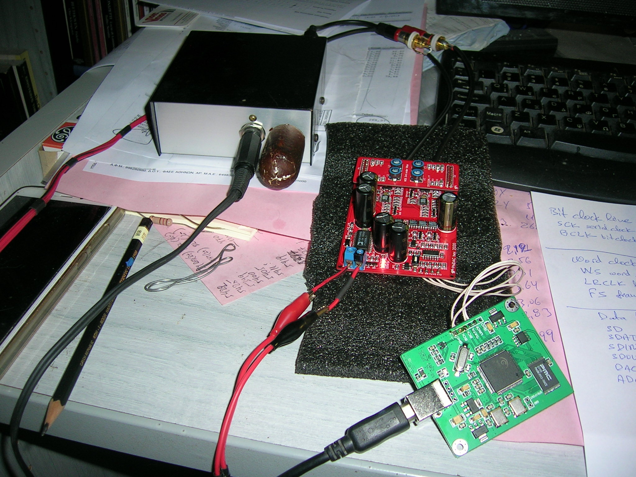

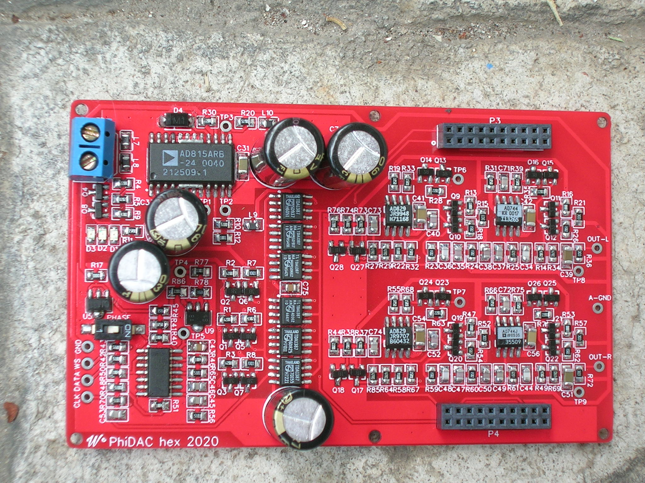

At last I assembled my PhiDAC kit, connected the USB to I2S module to it and now I exercise the conductors free electrons, the insulators molecules, the semiconductors charge carriers and the surrounding aether’s energy streams with music from the PC.

So many ceramic caps in the signal path and John Mayall' voice on stage is still discernible to me :scratch2:

Wires between the USB board and the dac board are pretty long, and not even signal wires loosely twisted with individual dedicated ground wires. Not ideal.
Better clocks should help reproduction quality. JL sounds makes a very good one which is called I2SoverUSB. Many people say it is the best sounding USB board they have tried. Clocks are NDK SDA, and the board is galvanically isolated from USB power and ground. I2SoverUSB - I2S over USB Audio
Not yet there Mark (it was the first breadboarding to see if USB to I2S + DAC + filter work together at all) but thanks.
You mean each of the three I2S wires twisted together with one ground wire?
Nice work @gpapag. Now is a time to tweak, it is DIY project anyway. 🙂
yw sajunky. If I can hand solder all those SMD parts and the DAC works afterwards, everyone can!
Tweak time ahead (after building a PSU, assembling Abraxalito’s SE headphone amplifier and arranging for housing them in some ugly enclosure)
Actually, I find that very light twisting suffices nicely, and may actually be preferable. An alternative approach is to use ribbon cable with every other wire a ground wire, and ground wires at both outside edges.
